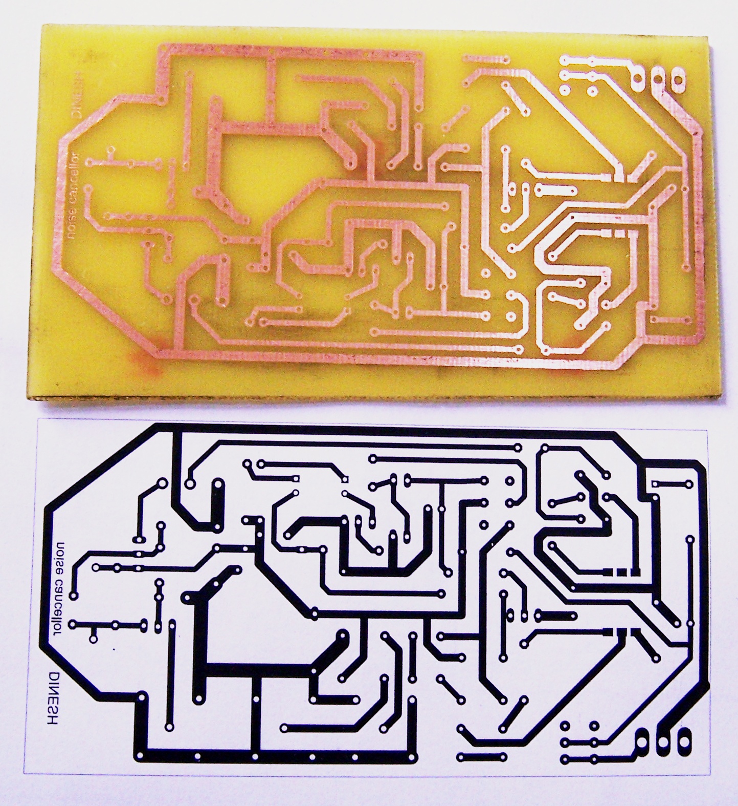

Not bad for a first go and with regular paper.
If you can find rice paper you can give that a try. Color pages from SOME magazines work. Finding which can be a trial.
PulsarPro sells a paper coated with starch. The paper falls off the board about a minute after you put it in the water.
off late I find some new paper sold on ebay is dam cheap and working superb . here is the link,
i felt much more comfortable
in registration , clean transfer and easy pull out and post etching the copper surface is shining even after few days of exposure to atmosphere , A photo of my pcb made using this paper is attached.

what printer did you use and whether a laminator or electric iron used for transfer please?

I used a Moulinex optimate 60 chrome plus iron , as for the printer i don't remember the name , but the guy who done the print for me said its a 200 $ printer .
For the paper i used i had hard time removing it from the card , so for a better quality circuit i prefer using photo paper or magazines paper , as it going to be easier to peel off .
After reading in the internet , before puting the paper on the copper , make sure you clean the card's copper surface with ACETONE , after that you can iron the paper on it with mid/high temp (silk/laine) setting .
Next for optimal transfer , put the back of the card surface on the iron heater ( settings at max) , this should allow the rest of the ink to stick optimally .
Next step is let the card cool down and put it in water ( mixed with liquid soap ) for about 4 minutes , then peel off .
Now for the etching there is two possibilities , using ferrite chloride (cheaper & for simple circuits) or using a mix of chloridric acide and 99 %Hydrogen Peroxide ( used for complex circuits ) .
NB : When you put the card on the chemical liquid , place the printed side directly on the liquid and make the liquid moving , this will help etching faster .
last part is removing the ink with ACETONE .
Now for the etching there is two possibilities , using ferrite chloride (cheaper & for simple circuits) or using a mix of chloridric acideand 99 %Hydrogen Peroxide ( used for complex circuits ) .
You will be better off, if you stick to ferric chloride for the time being. Even commercial PCB manufacturers use it. Ferric chloride is reasonably fast (particularly if warmed a little), gives the sharpest etched edges, and produces the least undercutting. In fact, it is the standard to which other methods of etching are compared.

paper is something one needs to experiment with. based on my experience, ideally it is smooth/glossy and easily dissolves in water. thicker paper is more stable but much slower to soak or heat (cold toner does not stick to copper).
copper must be cleaned (oxide and fingerprint free) if you want toner to stick to it. toner is a plastic and ironing melts it, and as mentioned, this is what allows it to stick to copper. but melted plastic is not very strong, i let it cool down first before soaking, and after soaking, i rinse it for few seconds under cold water. this makes toner hard and tough so i can easily get rid of paper. i remove any leftovers using large eraser and running water. if toner comes off too or is removed easily, something is wrong.
before etching i inspect board and if there is freckle or two i touch it up. most people recommend permanent marker (Sharpie) for touchup but imho standard permanent markers are pretty lousy at keeping copper safe (still better than nothing).
