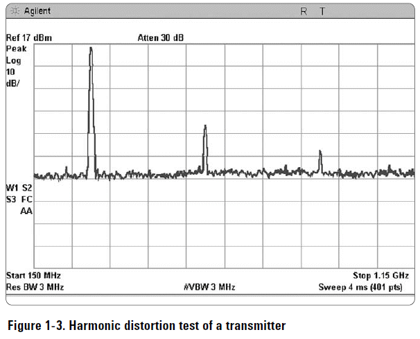

When I mentioned peak what I had in mind can be seen in the attached image. What I believe here is that the top of the waveform is a peak value. As to the original posted image I assumed the waveform present was a peak. I also assumed that the numeric values shown on the display for voltages were peak values. My years of swept spectrum analysis were long ago and I have never used FFT methods. Today my only use for spectrum analysis consist of doing some audio testing (acoustic noise testing) on an older HP system. Even that is outside my department.

Almost forgot, the analyzer I do work with on occasion uses a "peak find" function and when used the cursor is placed at the peak on the screen. Actually it is as I recall a tiny cross hair. Monday I'll have to see what those old units are and get more info. Additionally there is some software I use at home with a data logger. When I record and open the file it also has a peak find function. When used it places the cursor at the highest peak of a waveform on the screen.

The top of each peak is the peak of the RMS value.
I thought peak value but if you say the RMS value, then good with me. Thanks Carl. I was seeing the top as a peak value.
Ron
