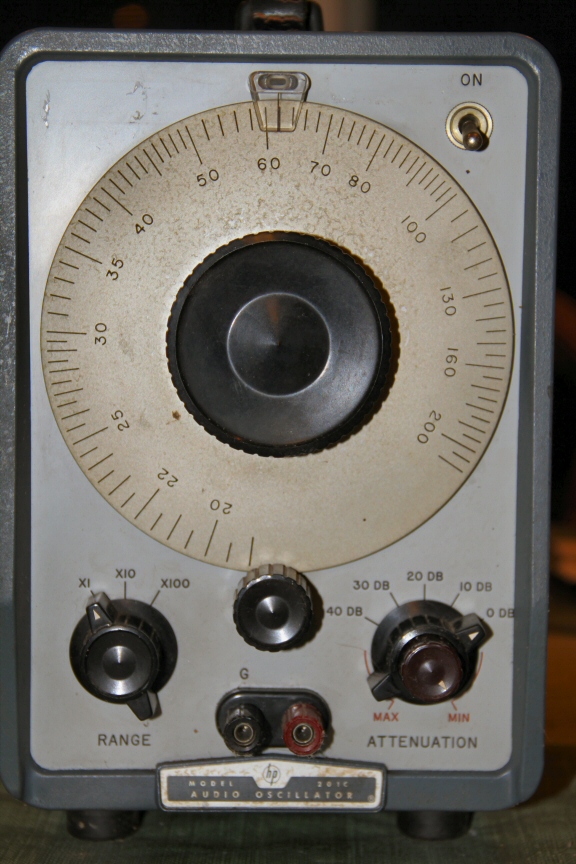

Hi Nigel
I agree. Would you believe that one of the best sine wave audio generators I use to this day is my old HP 201C (lovely image attached). There being the "wien bridge etc". Then I have a collection of old Wave Tek function generators, an old Data Pulse pretty good pulse generator plus an old HP 3311A small basic function generator. Quite the family. :)
Ron

Your function generator is just fine for what it is intended to be.
What is the difference between a function generator and an audio generator other than the frequency response? Is an audio generator capable of generating non sine waves too?
A function generator generates several types of waveforms. Typically, sine, square and triangular and working from there. They can get pretty elaborate as to the wave shapes they generate. When it comes to the sine wave in particular then it is a matter of how the wave form is actually generated. I mentioned for example DDS (Direct Digital Synthesizers). This paper is a pretty good read on the subject. I suggest you read it. There is also the true wein bridge oscillator circuit used to produce very high quality sine waves with excellent spectral purity. A Google of wein bridge oscillator should bring up a new wealth of information.
You select test, measurement and diagnostic equipment based on the intended application. If I need a truck I don't select and buy a sub compact automobile. :)
Hope that helps
Ron
