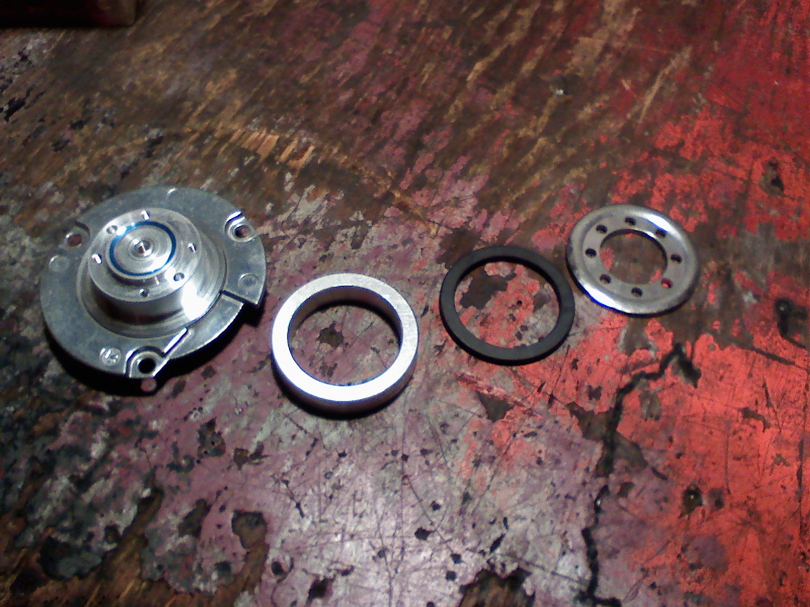

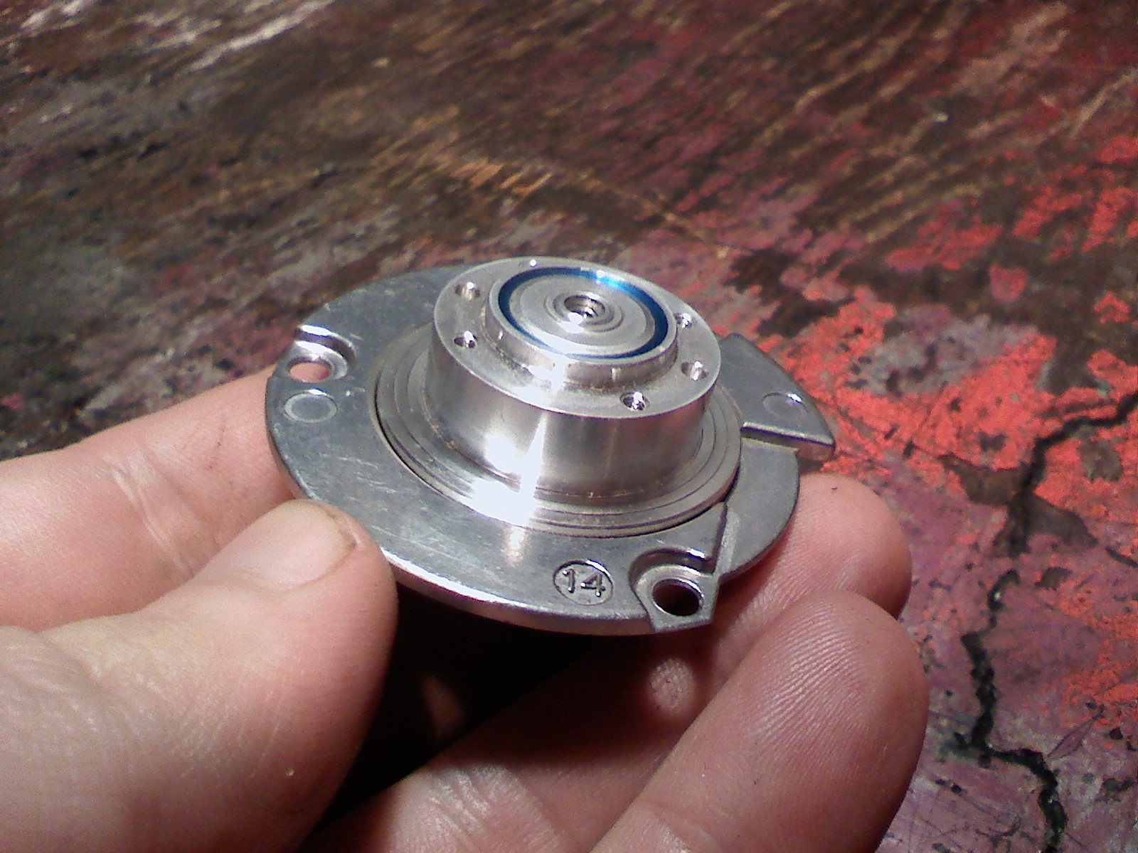

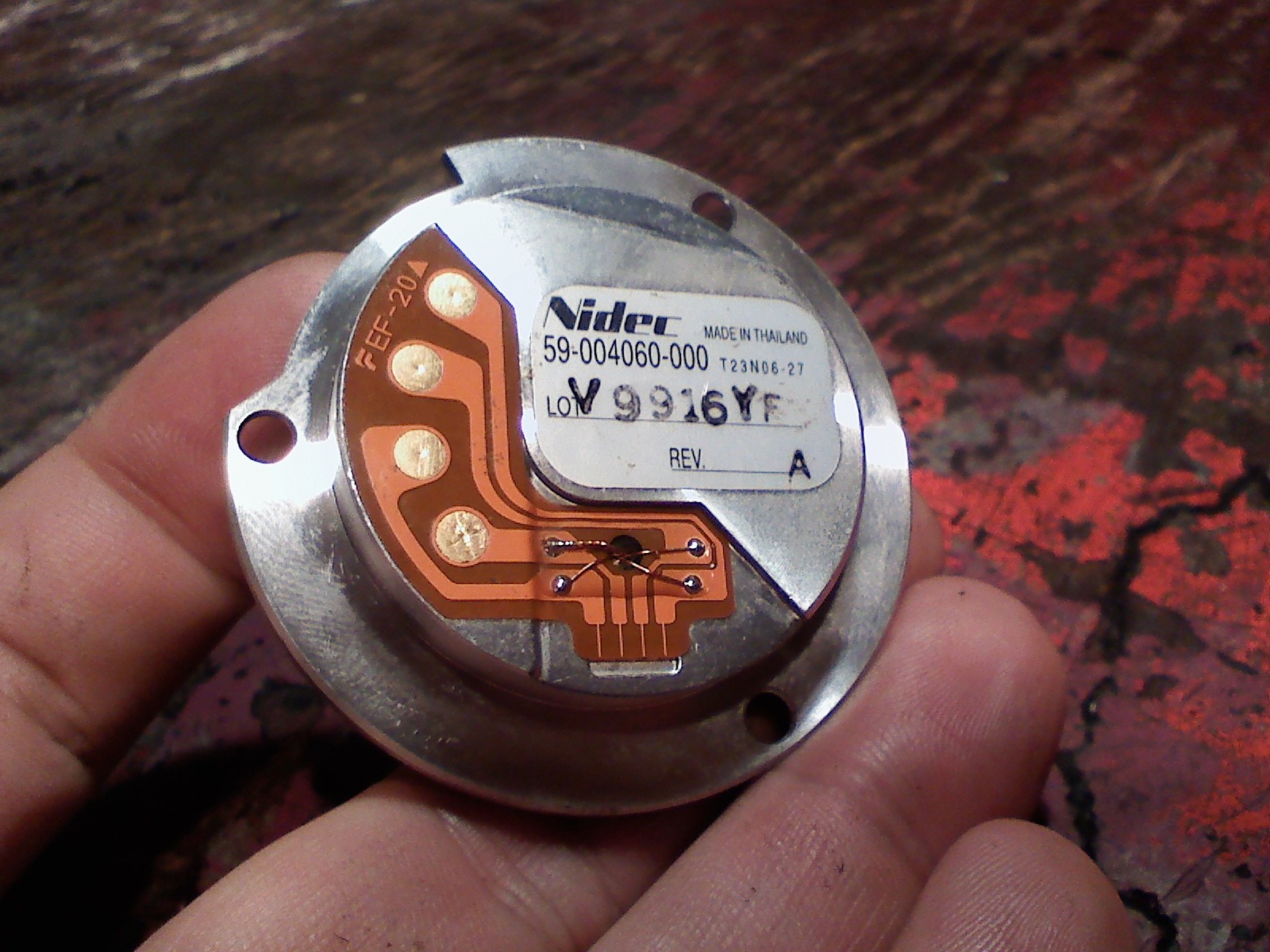

Spindle
The "spindle" is a sub assembly of platters, separation rings, motor, and bearing. It is very very precisely assembled. But then again, the arm is pretty freaking precise too. The spindle usually is a whole unit removable unit, but may have the contacts for the motor glued to the case.
Here are some pictures of just the motor and rings, no disks/platters.
[SUB](Fun fact: The black burn line etched into my work bench on the bottom right of these pictures was caused by HV electricity... for science.)[/SUB]
I couldn't say what would be best to try and replace. On the one hand, the platter is more solid metal through and through. It would be hard to imagine how accidentally bending or warping something while taking it apart. The bearing would be the most questionable, so long as you never touched the platters. On the other hand, it is much larger than the arm is and will require you to take out more screws and use more force to remove it. The screws may also be torqued down to a particular spec, and you will have to get all of them right, it probably can't be warped even a small tiny amount. And a fingerprint smudge on any machined mating surface would probably be disastrous.

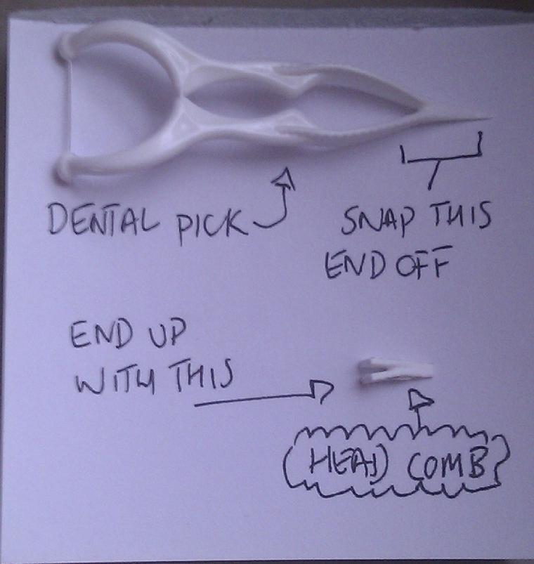

Hi all,
Thanks for your really kind words of encouragement and advice as usual! Still getting things ready for the next experiment (regarding how much head contact results in total head failure) but in the meantime, a little fun.
Head comb made out of a dental pick, seriously! :)
Results: 6.2% data loss - not bad!
If I can get my hands on a proper professional tool, I'm sure this can be improved upon.
Snip the end off the pick, use pliers to squeeze the two ends down until they're about 2mm apart. Slide the 'comb' between the arms of the head and then remove. Timed the whole process to take 48 seconds.
Hope you like the design, and remember to floss!

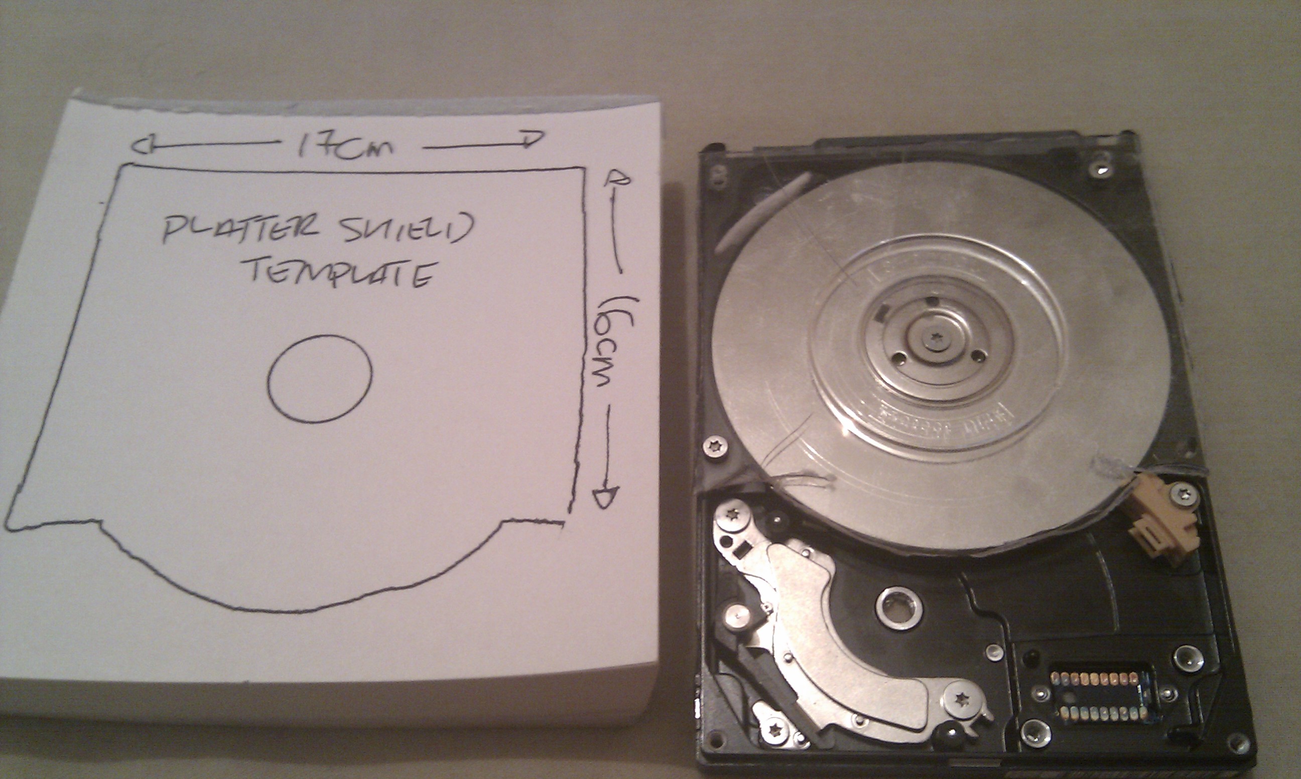

Hi All,
The good news is I've found a way to open up the 320GB hard drive, swap the head and only lose 3% of the data. Ten times less than the the experiment previously performed. Method, templates and diagrams below.
Firstly again do please practise on a test hard drive before you open up your own in case some or all of these methods apply. For example, I've heard for some models of western digital hard drives, opening the case will ruin the head alignment and this can only be fixed with a very expensive tool Luckily my seagate does not seem to have this issue.
Anywho the technique below is performed on a brand new working 320GB seagate hard drive (bought another one on ebay), exactly the same model as my own dead one. The reason for this is I wanted a clean bench mark result from this procedure. The experiment is designed to test how much better data integrity is preserved for opening up your hard drive in a non clean-room environment, when you make an effort to shield the platters. We're going to build a platter "shield", using no special tools or equipment except house hold items. Here's how I did it:
Step 1: Filled brand new working hard drive full of 197GB (Just copied large folders across and it came to this amount) of various media, ebooks, mp3s, movies etc
Step 2: When you buy a spindle of CD's or DVD's or any disc, you should get what looks like a plastic spacer disc that usually sits on top of the spindle. This will be our platter shield.
Step 3: Used a permanent marker to draw an outline of how I wanted my shield design. I wanted it so it protected the platter but gave me adequate access for a head replacement. Template enclosed below.
Step 4: This plastic is far too brittle and so decided not to saw it, so scored the outline with a stanley knife blade and just snapped the pieces off. This is far from the best technique and I nearly snapped through the shield a few times, but it's quick. Made two shields, they took 10 minutes to make in total.
Step 5: Clean the underside of the shield by polishing it. I used a cloth that came with my camera. I'm not sure what it's called but it doesnt seem to leave any fibres behind and it feels quite silky.
Step 6: Opened up the brand new hard drive and covered the platter with the shield immediately. If you do this quickly, the platter is exposed for about a second. From this point onward, the platter is then only exposed to the underside of your shield which hopefully is cleaner than the surrounding air. Optionally you can also drill mounting holes onto your shield so that you can allow it to sit just right. The reason I used the Plastic CD instead of a complete layer of plastic (like say the plastic cover of a CD Jewel case) is because I wanted to make sure once I placed the shield on top of the platter (which if you made it correctly should not touch it, but be about 1mm above it) it would still turn. So once I placed the shield over the platter, I placed a paperclip into the spindle holes to check the underlying platters were still rotating. This is the kind of freedom you want, dont let the platter shield touch the platter. I also used cellotape wrapped over the top of the shield and down behind the hard drive (on to the PCB) to hold it in place.
Step 7: Left the hard drive exposed like this, for 6 minutes. A time I think is more than respectable for any internal maintenance. During this time, personally, I removed the head carefully and put it back, as practice for when I do the real thing on my own hard drive again in future. Picture below taken with the platter shield in place and the head removed.
Step 8: Removed the cellotape on the shield, lifted it off and covered with reattached the hard drive lid (which had been kept on a dry clean surface face down). Again be quick, do not expose the platters for any longer than you have to.
Step 9: Reconnected hard drive back up to windows and performed data integrity test. I made sure the hard drive was upside down for this, as any debris which might have made it on the platter hopefully would have been shaken loose and due to gravity would have been swept away internally into one of the filters, thereby reducing the effects of those debris.
Results: 192GB recovered, 5GB lost in CRC check errors. Result = 97% DIY recovery!
So again, had this particular hard drive suffered from a failure which resulted in a damaged head (symptoms: clicking, beeping, clunking), I would have been able to recover all but 5GB of data from this drive (obviously assuming the head in this case had not caused damage to the platter). This is in a non clean room environment in which the hard drive lid was off for 6 minutes. The conclusion here is if you decide to take your hard drive lid off to repair it, the best thing you can do is take some measure to protect the platter from airbourne debris. The last time I performed this experiment with no such protection, I lost about 35% of data. Compare this to the 2% lost this time around with a simple shield.
Anyway, enclosed are the diagrams and templates you need if you decide to do this yourself! I'll be going in to depth with a head swap procedure next which I've done about 30-40 times now on the practise drive. Ultimately then I'll finally go ahead and do it on my own dead drive and we'll see if this fixes my particular hard drive's problem or if I need to go one step further and transfer the adaptive memory on the logic board to a new PCB donor. In the end the whole experiment might end up being an epic fail, but at least the data here if anyone wishes to try (or improve upon) my shoddy methods :)

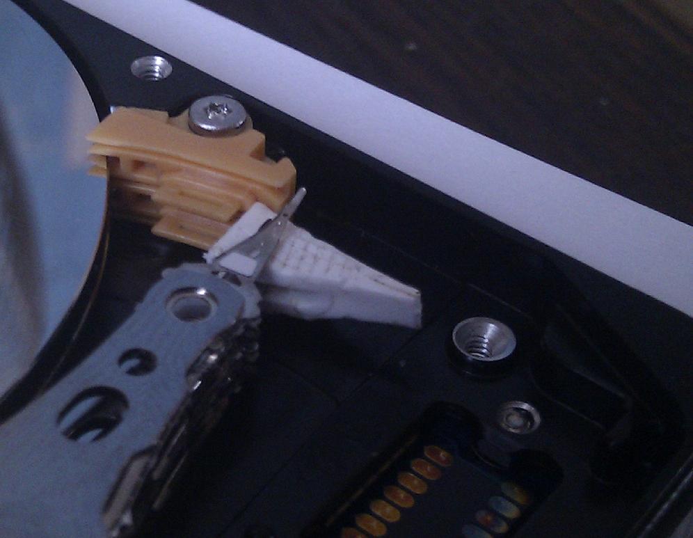

Hi All,
After practising swapping heads for the best part of yesterday, I decided it was time to go ahead and do it live on the real thing! I'd like to introduce you all to my faulty hard drive head :)
No wonder my hard drive was clicking, the head is all bent out of shape! The little black square is one of the heads which should be aligned directly underneath the pointed metal ends. Each platter has two heads, one to read the top, the other to read the bottom. The platter looked fine from the top, not sure how the drive managed to do that to itself.
It's got a brand new head in it now and sounds fine. Unfortunately windows never detected it but when I opened up my Acronis Disk Software which I use to view partitions, it recognised it and let me explore it. However it kept throwing up read errors and was obviously having trouble reading the contents.
Then suddenly the drive disappeared from the software view window and I've been unable to get it back. Very strange indeed. Not sure how acronis detected it but windows didnt...Not sure where to go next, recovery software like the kind John suggested, or swap the ROM on the PCB? Incidentally drive sounds fine, spins up fine, just seems to spin quietly and constantly with no sounds of head movement.
By the way, as you can see from the picture, in the end I decided to go with a head comb just made up from a tiny bit of rolled up paper with a needle through it, to use to handle it. Worked pretty well and the head swap went off like a charm. Just take a small strip of paper (4cm x 1.5cm) and keep rolling/folding it up. Then bend it like a V and stick a needle through it to hold and manipulate it :)
The good news is in the few minutes it was working, I managed to copy 3-4 of the most important files I needed so at least that makes up for some of this ordeal.
What a major repair this is turning into :)
EDIT: Just noticed it actually shows up fine in Device Manager as a USB Device. Strange!
Regards,
Megamox

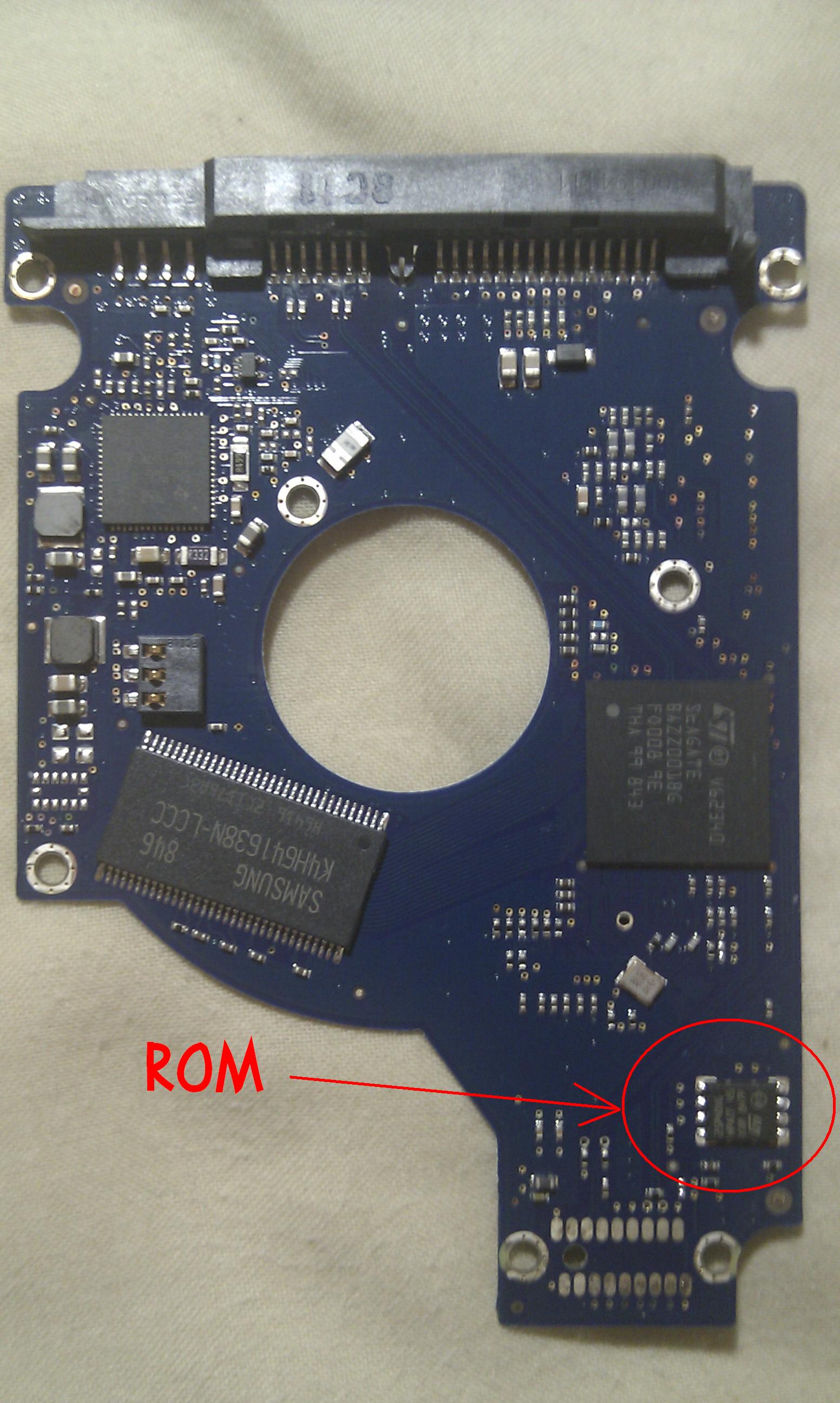

Hi Guys,
I've been unable to get any more useful data from the hard drive at this point and I wanted on your opinions on whether it's more than just a partition table or format problem. I took picbits advice and hooked the drive up to the motherboard (I presume this means just put it back in the laptop?). Used Hirens Boot CD to run diagnostics on it (This CD is amazing, it's chocked full of useful programs, definitely going to keep that handy!).
Strangely while inside the computer in the hard drive bay it was not detected by both windows or device manager. So I took it out and hooked it up via USB again and this time, at least it was back being recognised by the device manager. Strange. The internal hard drive bay is working, as I have put my usual hard drive back into it and it detects it fine without a problem, so the problem must be related to my dead hard drive itself... ROM issue?
Anyway the drive is 320GB but the results of various diagnostic tools report it is either unreadable, unaccessible or some of the time, not even present. Even Seagate's boot diagnostic tool failed to notice it was hooked up. Anything that does recognise it usually reports its size incorrectly at 2TB (and not 320GB) - I wish!
I'm not sure if a dead PCB/ROM causes these kinds of symptoms or if it is data corruption in the partition tables but to be honest it's the only thing left in the hard drive that hasn't been replaced. I'm happy to swap over the ROM from one board to another, but it looks too fiddly to do with a soldering Iron. I've found a really cheap rework station below and if anyone thinks it's a particularly bad choice, let me know. It's got a really small foot print and seems quite simple.
New ATTEN AT 858D+ 858D SMD Hot Rework Digital Station Air Solder Blower Gun - £45 delivered
https://www.amazon.co.uk/858D-Rewor...HM28/ref=sr_1_1?ie=UTF8&qid=1359721730&sr=8-1
The only issue now is that this recovery is becoming slightly more advanced than someone at home without experience or tools might be able to do and so if you do believe you have a problem with your ROM chip, you can obviously have someone remove it for you and exchange it. If you know someone who can do this, you can ask if they have the tools. You just need to find out where the ROM chip is on your board and have another board which is a close match to the relevant part numbers. I've enclosed a picture of where the firmware/ROM is on my board, from an earlier picture I took of it. Maybe your individual one may have similarities in place and form.
Finally I believe if you want to send the board off to be swapped with another, there are companies that will copy over your firmware over to the new board and send it back to you. I've found three so far that do this, there are probably more, but the companies are called DonorDrives.com, onepcbsolution.com and hdd-parts.com. I've never used their services so cant comment unfortunately. The first two I believe are based in the US, the last in Canada.
So what do we think, should I give this a go myself? Or leave it to the pros. I've got pretty much zero SMD soldering/desoldering experience but I understand you run the gun over the IC until it's plyable, lift it off with tweezers and then pop the replacement on. I guess the solder moves with the IC as it's transplanted (as in the video below) or maybe I'll have to buy some special solder paste. I dont know if my usual solder (which I use with the Iron) would work? Have no idea what temperature is too high either, don't wanna fry this chip after all the effort I've gone through!

8-pin SOIC is not hard to do by hand, then again I have been soldering for as long as my brain has been able to form memory's.
This is the process I use when I'm being fairly lazy...
1) Using a normal iron, add solder to all the pins, until they are all bridged together.
2) Heat all the pins on one side evenly with a sliding back and forth motion.
3) While heating, put a toothpick or similar under an edge of the IC that has no pins. Apply a gentle upward pressure.
4) Lift each side of the IC a little bit at a time, shift over to the other side, the IC will "walk" up away from the board.
When the IC is off, you'll need to add the new one...
1) Heat, flux, and solder wick the pads of the board and pins of the IC to remove old solder.
2) Clean off the pads really well with rubbing alcohol. Let it dry well.
3) Place the IC on the PCB, align it, solder down one corner pin.
4) If the alignment is off, reheat the pin and move the IC, otherwise, finish soldering.
...Anyway the drive is 320GB but the results of various diagnostic tools report it is either unreadable, unaccessible or some of the time, not even present. Even Seagate's boot diagnostic tool failed to notice it was hooked up. Anything that does recognise it usually reports its size incorrectly at 2TB (and not 320GB) - I wish!...
Megamox,
Given the condition of the failed drive heads, I'm mightly concerned the they may have touched the disc(s) (the "clicking" noise you heard, especially after the disc started spinning again) and quite likely the outer most cylinder where the partition data is located.
That being the case, that data is toast. And I say that because you mention that when the drive was recognized, the report claimed 2T. I had a similar drive do the same trick, i.e., enormously inflating the total size and number of partitions on the drive because the partition table data had been totally dorked and the garbled hex code read added up to that ridiculous amount.
And with a partition table essentially unreadable, there's no getting to (that I know of) anything else on the drive. I don't believe that even a sector editor could get to it since the BIOS has no earthly idea where to start reading the data.
Could be wrong, of course.
As I understand it, a lot of lost file recovery software relies on the fact that when files are deleted, they are never actually removed from where they reside on the disk. Rather, they are only removed from the file listing. A lot of people don't realize this, and thus believe that when they empty the recycle bin their data is erased at that moment. The fact is, it was only marked such that that area can be used to store other data. The actual data will still be there until something over writes it.
In any case, the problems being described by the OP sound to me like a failed board. Namely that it is acting flaky even while being enumerated. I would do the board swap if it were my problem. Possibly swapping the EEPROM as well if it proved necessary. Easy enough to do both and it would virtually guaranty a working board if all was done right. Then again, I may also try using the manufacturers flash upgrade software and rip a backup if I could. Then simply dump that back to a working board. Or get more extreme and take out the chip then directly read it with a I2C/SPI serial EEPROM reader. Then I could have it backed up for all eternity.
Thanks guys... I think you're both right! I suppose it could mean either scenario. The interesting thing is I explained what was happening to Kevin at OnePCBSolution.com, one of the companies who do the board + ROM swaps and he kindly replied with "To be honest, I don't think your drive has a circuit board problem. It may be better to seek a data recovery professional." Oh well, I thought that's the end of that.
Then just browsing the Datacent website, it's got some really helpful and comprehensive information, and a whole page on why Seagate drives go wrong (https://datacent.com/datarecovery/hdd/seagate). The part that perked me up was:
"Seagate drives operate under special firmware microcode that could also fail sometimes. Typically hard drives with corrupted firmware spin up normally, do not click but still fail to initialize. Such drives could have one of the following symptoms:
HDD is not found in BIOS at all - Just like mine! :)
shows up with wrong S/N or capacity, - Just like mine! :)
fails to read any data or boot up operating system. - Just like mine! :)"
That's describing pretty much what's happening to mine at the moment! It mentions the fix is to correct the firmware on the board but then goes on to say "it is impossible to repair such drives without special equipment capable of accessing and repairing firmware modules in the hard drive firmware zone."
I couldn't find a Seagate firmware flashing tool, but perhaps a solution may be to re-flash the PCB with it's original firmware (DE05). Equivalently, move the ROM to a new board which also has the same firmware, which is obviously the route I've been considering. Hopefully the experts might be able to shed light on the best course next.
