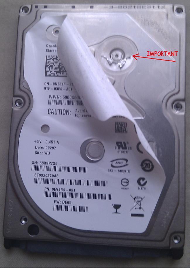

Okay faulty drive arrived today, here are some preliminary tests:
My Dead hard drive: Seagate Model st9320320as, Firmware version DE05, Date of manufacture (09304 = 23rd Jan 2009)
Ebay Test Drive (Faulty): Seagate Model (Same), Firmware (Same), Date of manufacture (09297 = 19th Jan 2009) - 4 days apart, what luck!
Seagate date code calculator here: https://www.bugaco.com/calculators/seagate_date_code.php
First test: Connected Ebay test drive to see what it's fault actually was, no description given in ebay listing. It turned on, revved up fine, detected by windows, popped up in my computer. But the drive (supposedly 320GB) only showed up as 70GB. I suppose this is the fault they mean. Dragged a few files back and forth, seemed to work fine. For a drive that doesnt show its full space, I'm not sure where the fault really lies, anyone?
Second test: Took the board from my bad drive and put it into the ebay drive. I wanted to see if my board was really faulty. The ebay drive spun up and was detected by windows, hoorah! The USB notification popped up saying device was ready to use, but sadly nothing appeared in device manager or windows drive management. I know obviously the adaptive rom memory is different from board to board, but I think this is a good sign that the board is possibly okay.
Third test: Put the ebay board into my dead hard drive instead. Same clicking, non recognition. Expected as much since the heads do sound faulty.
Put everything back in their own boards and drives and my faulty drive still clicked as usual and the ebay drive still showed up as 70GB as it did when i started. Checked the files I had transferred to it earlier and they read fine. So the tests above seem to have had no damaging effect on the components. Great.
Next tests, to test the effect of torque tightness on drive functionality. These seagate 2.5 laptop drives seem to have 5 torque screws around the outside and one under the sticker. Here's the test results:
Undid all 5 torque screws around the edge of the drive. They all felt the same in terms of tightness and not alot of tightness really. Just enough so you hear a little click when you undo them. Tested the drive with these 5 screws removed. Drive fine, data readable.
Undid the 6th torque screw under the sticker which I believe is of obviously more importance as it connects to something in the middle of the drive as opposed to the edge chassis. Turned on, drived WAILED and SCREAMED. Turned it off quickly and replaced the torque screw under the sticker. Drive now fine, read and writes fine (with just this one torque screw holding the top together). Conclusion: this screw under the sticker is very important, yet I paid no attention to special tightness, just generally kept it how I found it.
Last test: Removed all screws from the top. Lifted the cover off just enough to dislodge it to undo any 'memory' the lid had of being connected to the drive. To throw things off I suppose. Rescrewed the 'Important' screw under the sticker and turned on. Drive fine. Reads and writes fine. Conclusion: Removing the lid for this particular model and dislodging it doesnt seem to kill the drive as long as you keep the screw that was under the sticker on there. In terms of the advice given in the Gillware Tech video, perhaps he meant you need to be careful with torque tightness on some models. My experiment here shows it doesnt necessarily apply to this seagate model i'm working with in particular. That's all I can really say. Results may vary when I decide to take the top off completely, perhaps it'll work fine without the lid and this particular screw altogether.
Thoughts?

The middle screw holds the head assembly from the top, so no surprise it has a lot of influence. Looking forward to your next tests :)
Have you checked for a hidden partition?
Alec_t, you just beat me to it! Yes there's a unallocated partition that is about 250GB. So it appears this drive, sold as faulty, is really working fine. Feel really bad about experimenting on a working drive, but it was only £10 and needs must. Essentially, I want to test if opening up the drive is worth the data loss vs data recovered.
