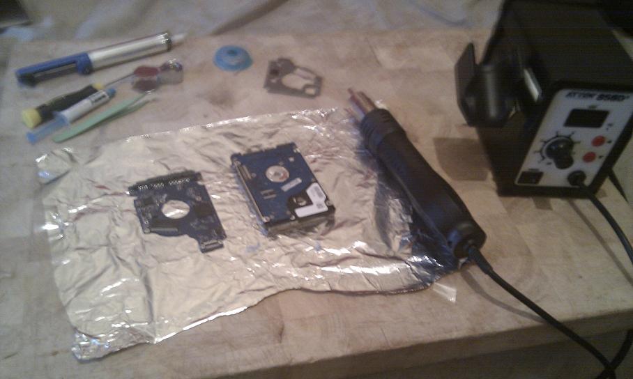

Hot air gun arrived today and I thought, finally - let's do this! I couldn't find anything to practise on unfortunately, so just grabbed the boards, cranked up the temp to 420 C and started my working on the chips. I have to say, this hot air station is really cool - the chips came off within 30 seconds. Glad I got it now. The SMD paste was a little fiddly, had to apply it to the pads with a sewing needle but once heated up, it disappeared nicely and doesn't require cleaning. Rom swap took about 3 minutes in total (Pics below).
So... once the EEPROM was transferred, what was the result?
SUCCESS :):):):):):):):):):):):):)
The drive popped up in Windows/Bios and I didn't waste time copying the data off! I've grabbed all the important stuff off so far and it's still copying! Feels so good to get my data back! I've recovered 200GB so far, with only a handful of CRC errors. At this point if it carries on or fails, it doesn't matter to me, I have everything I need now.
