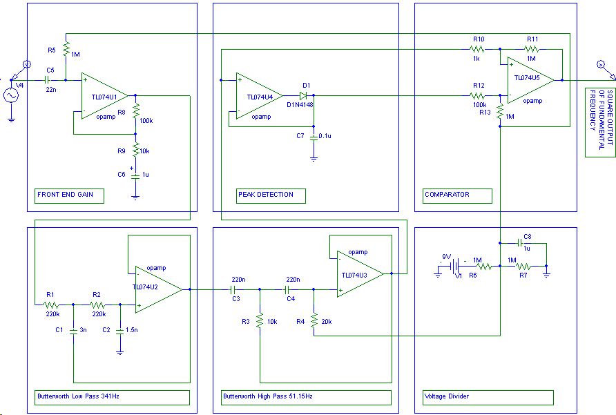

Here is the latest version of the filter. As of now my Vpp of output signal is 1.1V . Any ideas as to why? Is there a problem with the design or my actual circuit? Will 1.1Vpp adversely affect my PIC from reading in the frequency?
With no signal on the input, what dc voltage level is measured on the output.?
Floating Input => VDC of Output = 2.54V
Floating Input => VAC of Output = 2.35V
Grounded Input => VDC of Output = 1.54V
Grounded Input => VAC of Output = 0V
The grounded input, giving those output values seems odd.!
Are you sure the system isnt unstable ie; oscillating.?
Is the 1.1Vpk signal you posted earlier superimposed on the 2.54Vdc.?
You should have the Vinput connected, with the Vin set to zero, when you take these measurements...
Remember its a high input impedance opa.
I think the circuit is on a breadboard with long wires all over the place acting like antennas to pickup mains hum.
And/or the input cable is not shielded audio cable.
When the input is shorted then the output is normally low (or if the input offset voltage was different then it would be normally high at about 7.8V). The output should switch from 1.4V to 7.8V when there is a signal. it needs to be attenuated so its max voltage is 5V.

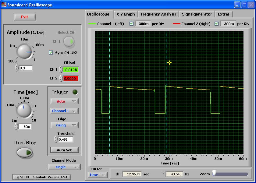

First of all, here is how I am testing my circuit:
I'm using a software oscilloscope with coaxial cables running as scopes.
I'm using a repeating strum of low E string as my testing input recorded and played through the same computer.
Secondly, odd stuff:
When I connect the scope directly to the recording, the oscilloscope shows a close-to-square wave presentation of the sound.
I can not get the proper square wave anymore, every time string is plucked i get twice the frequency (at the beginning of each strum, this could be normal and be eliminated through software)
When there is nothing connected to the input, here is the output I get. (shifting/moving)
When the cable from the pc is connected to the input but nothing is played through the soundcard, here is the output I get.(shifting/moving)
I think the circuit oscillates without an input because the 9V battery does not have a big (1000uF) bypass capacitor to keep the voltage fairly constant.
If the battery is brand new then the voltage is 9.0V and the max output (unloaded) from the TL074 is 7.8V. The minimum voltage is about 1.4V.

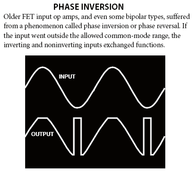

The frequency is doubled probably because the signal exceeds the negative common-mode input voltage range of the TL074 at about 2.5V. Then the output suddently inverts. It is called opamp phase inversion and it happesns with older FET-input opamps.

One source of feedback is the Vcc/2 supply at R6 and R7. You have a spare stage of TL074, use one of them to create a low impedance reference.
I also don't like to see the high impedance bias circuit.
Instead of an opamp I think R6 and R7 should be 3.3k and C8 should be 330uF.
What's the reason for these specific values? Will the bias circuit have any filtering effect?:eek: Wouldn't just lower resistance dividers and a higher value bypass capacitor do fine? Is there a final value that I should achieve here or a ratio between the dividers and the bypass?
'agu' is referring to the 1MΩ's R6/7.
Change them to 3K3.
The purpose of the two equal resistors is divide the +Vsupply, so the opa's are biassed to give a 'static' output from the opa's of Vsupply/2.
This in theory should enable the opa's outputs to swing symmetrically about Vsupply/2.
Do you follow OK.?:)
EDIT: If as 'agu' states the minimum voltage of the TL074 is +1.4V, this is not suitable to connect to a PIC's digital pin also
the positive swing of +7.8V is too high for the PIC input
Change them to 3K3.
Yeah, I do know that part.. I meant to ask if there is a R*C or R/C value that I am supposed to keep constant.
For example what if i used, 2k2's and 2uF?

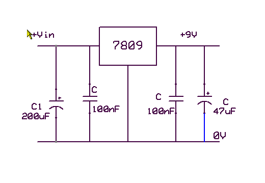

I'm using a 12VDC power supply regulated to 9V. here is the regulator i use. srry, dont have the LM7809 pspice model...
I had a clean square wave before, why am i getting phase inversion now? what's a practical way to fix this problem?

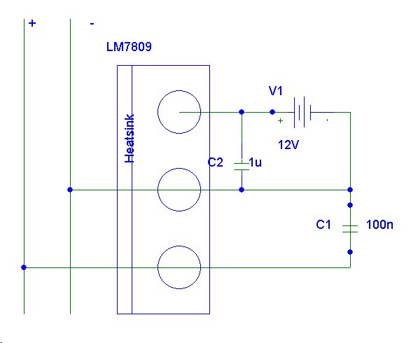

btw here is the regulator i use. srry, dont have the LM7809 pspice model...
I dont use Spice.:eek:
What voltage source is driving the 7809.?
Is this what you asked for in the PM.?
I guess that makes my regulator setup pretty futile...
this setup might help me get rid of the oscillations.. (I'm guessing due to the higher number of capacitors)
thanks eric
The original bias divider was two 1M resistors (500k in parallel) with a 1uF filter. Its time constant was 0.5 seconds which makes it a good filter if it wasn't loaded.
I calculated two 3.3k resistors in series which draw 1.4mA the same as an opamp and I selected 330uF as a filter cap which creates a time constant of 0.54 seconds.
The output of the TL074 has phase inversion when its input voltage drops to less than about 2.5V because the input signal level is too high.
Try an LM324 quad opamp (same pin numbers). It doesn't have phase inversion.
The reason I suggested the buffered reference is that the power supply was 9V. That often means that the power source is a 9V battery, and current drain might be important.

My suggestion of using two 3.3k resistors and a 330uf filter does the same.
LM324 Noise
Is LM324 low noise though? The advantage is that this IC has no phase inversion, will there be a disadvantage when replacing it for the TL074?
