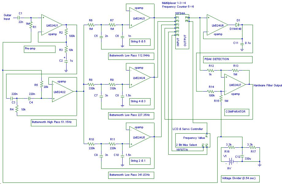

Ok, here is the deal.. I took my circuit to friend of mine with an oscilloscope, he has been an electronic hobbyist since he was 9 and an electronics engineer for about 10 years now. We checked the circuit stage by stage, there is no phase reversal in the circuit, thus no hardware fix needed. The second order harmonic just manages to pass through at lower frequencies and makes the comparator switch states.
My plan is either to have a low pass filter for each string according to proper bandwidth, or use a second PIC that will do some simple software filtering (e.g. do not stop timer if timer is less then expected value on that string).
Any simple ideas that might be helpful?? (please no software FFT):)
or how about switched-capacitor filters??
If you check EPE they did a PIC based guitar tuner a couple of years back, and they used a variable filter driven by the PIC.

I have checked the EPE one when I first started the project, i just couldn't make much out of it, I just skimmed through the code (seemed too complicated), didn't see the schematic thus didn't know they had an controlled external filter.. I thought what they did was software filtering.

Maybe you could add an automatic-gain-control circuit so that the level of the signal to the comparator is just the peaks of the fundamental frequency so that the comparator will not be triggered by harmonics.

No, it's external controlled by the PIC - I would suggest you try something similar, and it may be worth buying the back issue(s).

Anyways, here is the latest version of my circuit, it's a little bit more complicated. (Sorry for that...)
I calculated the ranges of each string in different tunings to develop as little number of filters as possible. I came up with a 3 low-pass filter design that will filter for 2 strings each while attenuating the 2nd and higher order harmonics.
