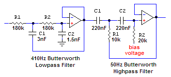

Your filters are not correct. A Butterworth filter has a flat response then a drop off as sharp as the number of poles. Your filters are not Butterworth and have only two poles.
A second order filter has two poles and drops off at the rate of 12dB per octave.
Your lowpass filter has capacitor values ratio that causes a peak at about 400hz instead of a flat response. For an opamp with a gain of 1 the capacitor ratio should be 2:1 for a Butterworth flat response.
Your highpass filter has a droopy cutoff since its resistors do not have the 2:1 ratio needed for a Butterworth flat response. The 1uf capacitors are huge and expensive and could be smaller and less expensive if the resistors have higher values.
The TL084 has noise. The TL074 is low noise and costs the same. They have a minimum supply voltage of 7V so your 5V supply is too low.
You have two bias voltage circuits when only one is needed. The junction of the three 1M resistors should have a 1uF filter capacitor to ground. The resistir in the highpass filter must connect to the bias voltage, not to ground.
The input capacitor cuts frequencies below about 80Hz and should be 0.022uF (22nF).
Here is how the filters should be:

First of all thanks for your fixes.. they do feel like a slap in the face sometimes but if it helps me learn something then it's good...;)
So is my low-pass a second order unity gain filter? and with your mods it has a butterworth response? Is it a general rule to have the 2:1 ratio in butterworth? I thought the greater the ratio the flatter response and sharper curve at the end.
You mean to replace the 10nF named C5 to 22nF i assume? My circuit needs to analyze Drop D and Flat D tunings which should be closer to 50Hz. So I do not wanna block sub-80Hz frequencies. That's what you did refer to as input capacitor though right?
Should I bias with 3.5V now that I'm gonna be using TL074's? I have a vague memory that opamps referenced voltages of their own supplies? Will that be a better adjustment?
Why do I need to bias the high pass filter? Won't the amplified signal have enough input to drive the IC?
The ratio of the capacitor values in an active filter determines the sharpness of its corner:
1) With equal values then it has a droopy cutoff. It has a Bessel response.
2) With 2:1 capacitor volues then the negative feedback boosts the corner and makes it a sharp Butterworth response. A Bessel filter (equal values) with a gain of 1.6 is the same.
3) With a ratio higher than 2:1 or a Bessel filter with a gain higher than 1.6 then there is a peak in the response. A Bessel filter oscillates at the peak if the gain is higher than 3.
Yes.
But my highpass filter has a cutoff frequency of 50Hz. Change its 220nF capacitors to 270nF for a 41Hz cutoff or to 330nF for a 33Hz cutoff.
Bias the inputs of the opamps at half the supply voltage. 7V is an unusual supply voltage so use 9V, 10V or 12V. A 9V battery will be above 7V for 1/5th of its life.
The input bias voltage of an opamp that has a single supply is half the supply voltage.
The minimum useable input voltage of most opamps is 2V to 3V when there is a single supply. Then the opamp works like a rectifier because its output cannot produce the negative-going swing of the signal.

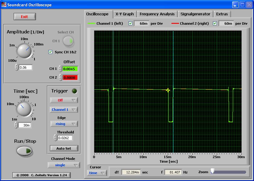

Can I get a "woot woot!" for the square wave output?
Now should I feed this into the PIC or should I use LM2907 to convert this to voltage then feed it to PIC's ADC?
btw the wave has 1.1 V amplitude.
Don't use an LM2907 inaccurate tachometer IC to convert frequency to a voltage. Use the micro-controller as an accurate frequency detector and indicator.
The output of the comparator should be 5V p-p not 1.1V.
