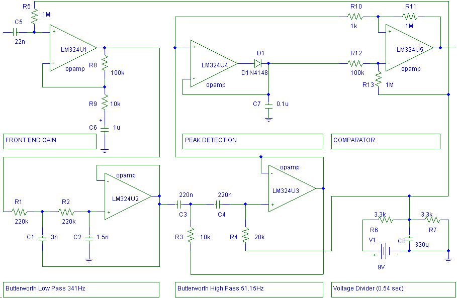

Here is the latest version that I am going to build today - add replacing the opamps and new voltage divider setup.

LM324 with latest schematics:
Idle Vpp reduced to 0.1V
With Input Output Vpp still at 1.1V
At the instant of plucking i still get phase inversion..

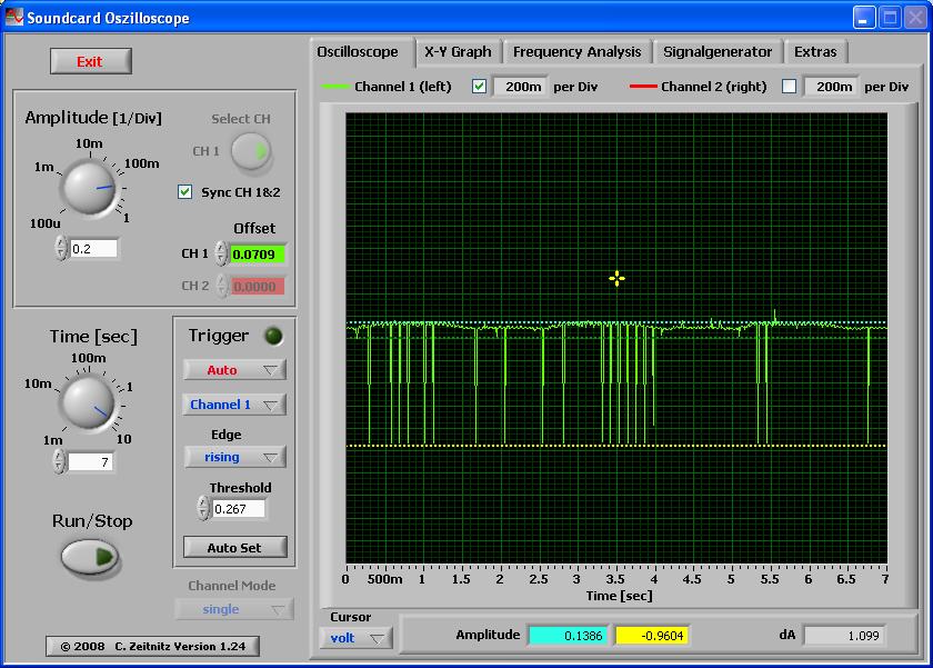

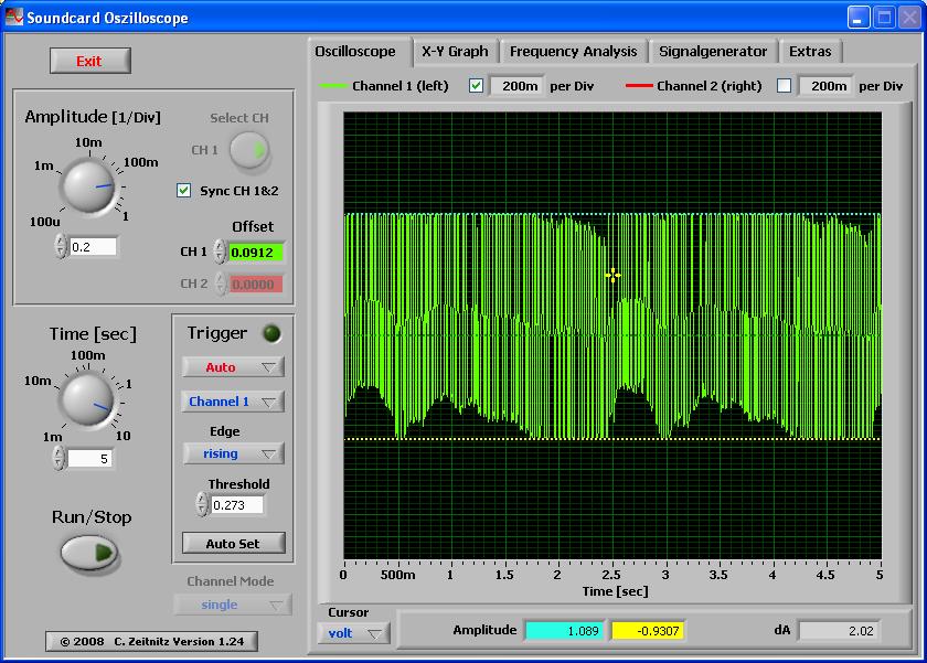

The output of the peak detector can be found here. I am not sure when I say this but aren't there too many peaks here? I thought that the harmonics should have already been eliminated from the filters. Some of those looks like the harmonics and not the fundamental.

It looks like your circuit or your sound card scope is clipping. The signal levels of each opamp should clip at 7.8V peak-to-peak if the input impedance of the sound card is high and the 9V battery is new. So the sensitivity of your scope is wrong.
Maybe your sound card is using a mic input but you are supposed to use a line input.
The output of the peak detector is at the connection of D1 and C7 but it looks like you measured the output of the peak detector opamp whose output goes close to ground between the positive peaks of each cycle of sound.

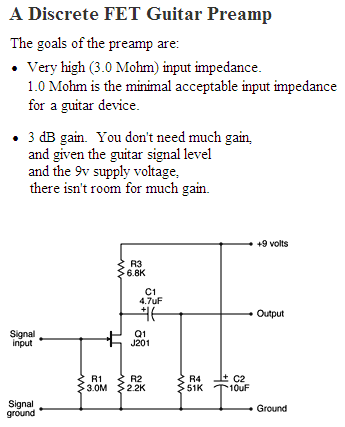

Here is a FET preamp that does not have phase inversion. It can drive the LM324 preamp. Its high output level might cause phase inversion if it drives a TL074.

Ok... I took a break from my project for a few days to clear my mind about what to do. I'm planning to run some output and input amplitude tests for each stage of the circuit, see where the phase reversal begins.
Since everything except the first stage of the circuit is unity gain, I don't see any other stage contributing to the phase inversion. I am not sure how much gain this stage provides me with (I couldn't calculate it properly with my knowledge), but what i learned is that phase reversal will happen due to the input swinging out of the range of the opamp. Am I amplifying the signal too much on the first stage?
What's even weirder is that I am not getting enough Vpp as it is! Maybe I could decrease the gain on preamp and add in a power amp between the current 5 stages and the PIC.
I thought LM324 had phase reversal prevention btw, does it not?
Correct.
The gain is (R8/R9) + 1= 11.

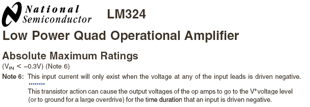

The datasheet for the LM324 explains that the output will suddenly go high or low when its input voltage goes negative more than 0.3V.
The output from a guitar's pickup could be driving the input of the first opamp well below ground. If you add the FET preamp (that I posted) to the input then the input of the opamp will not go below ground and there will be no phase reversal.
Probably, then the output of the first opamp will clip and produce many harmonics.
This is meaning the input Vmax≤+0.3V Vmin≥-0.3V, right?
Assuming my guitar outputs 3mV; which you thought was too little, the first stage shouldn't have a phase reversal.
If I misread my voltmeter and the guitar output was 30mV, the first stage still won't have a large enough input to have phase reversal; yet 30mV×11= 0.33V will cause a phase reversal on the 2nd stage.
What if I changed R5 value to 3MΩ, would that help? Can't I redesign the opamp based preamp for a higher input impedance like that?
If I was to build the FET preamp you suggested, will that be replacing the current first stage(the preamp)?

It is the mic input of your sound card that is clipping at about 2V peak-to-peak.
The Zeitnitz Oscilloscope instructios say the input voltage range of a sound card is 1.4V peak-to-peak!!! They say if you want to see a higher voltage then an input voltage divider is needed.

The software oscilloscope and sound card have an AC input, not DC so you won't know when a signal goes negative.

The designer of the FET preamp I posted limits its gain to only 1.4 times because he knows that a guitar can produce a few volts of signal.
The input voltage range of an LM324 is -0.3V to 32V. If an input goes to a voltage more negative than 0.3V then phase reversal will occur. If an input goes to a voltage more positive than 1.5V less than the positive supply then that input will not function.
The output of the first opamp will clip at +0.1V and +7.8V so the other opamps will not have phase reversal.
The value of R5 is 1M. Increasing it to 3M won't make any difference.
If you use the FET preamp then the first opamp is still needed to provide a low impedance drive to the lowpass filter. The gain of the first opamp should be decreased since the FET has a gain of 1.4 times.
I can't find the J201 N-channel JFET locally, can I build the circuit with 2n3904 NPN BJT and get the same results?
