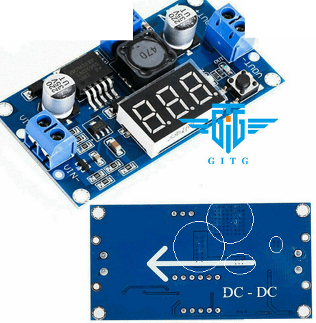

Vias.
I havent noticed them until i started this project. Now i see them on ready to purchase modules like this one. It was suggested that i add some around the ground track by pin 1 of MP2315. My PCB program does not have this feature so i would need to do this manually. Problem is i dont know how many, how big, or how close they should be. Trying to understand the many different vias but it can get confusing. It was suggested that a pour around a net would be better than adding an array of vias.

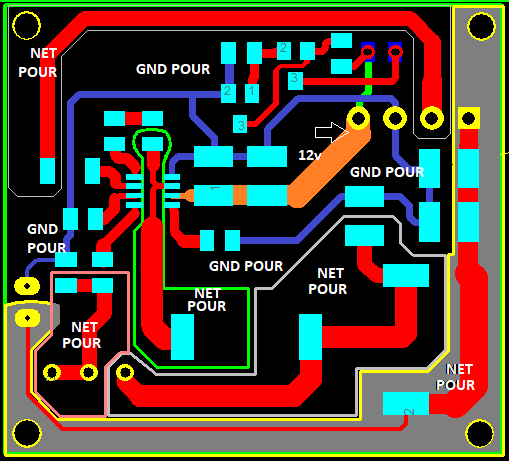

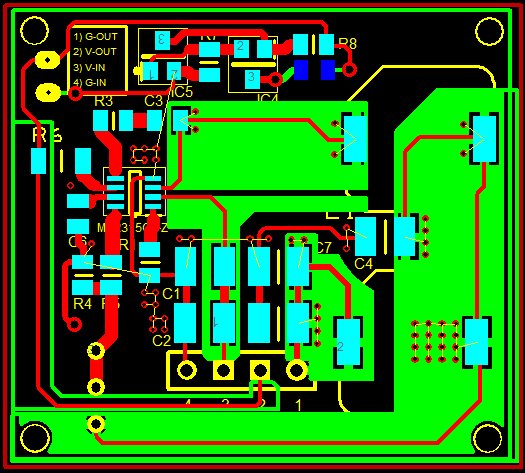

Net Pours.

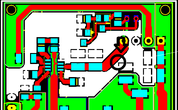

sometimes when you show someone a new tool they tend to use it for everything. Have i done that here? Do I have too many separate pours on this pcb? I mean tracks should be wide enough to provide the voltage required so why not surround that track (net) with a polygon and pour a big fat copper pour around it. Boom problem solved. Well I did that and then did another, and another, and another. So if you can make sense of my image ive got quite a few net pours for signal and current nets and then a ground pour. I colored a few nets for clarity.
The blue colored tracks represent the ground track. Its pour makes a continuous connection of every pad and through-hole. With wide and sufficient spokes. And then one huge GND plane on the bottom too.
The 12V is in a tan color (has no pour) Ive highlighted one net pour in grey.
If you look closely you can see the outlines of the other net pours. Im concerned I may not need every net to have a pour. I mean these pours place nets very close to one another right? Is that good for this buck module?

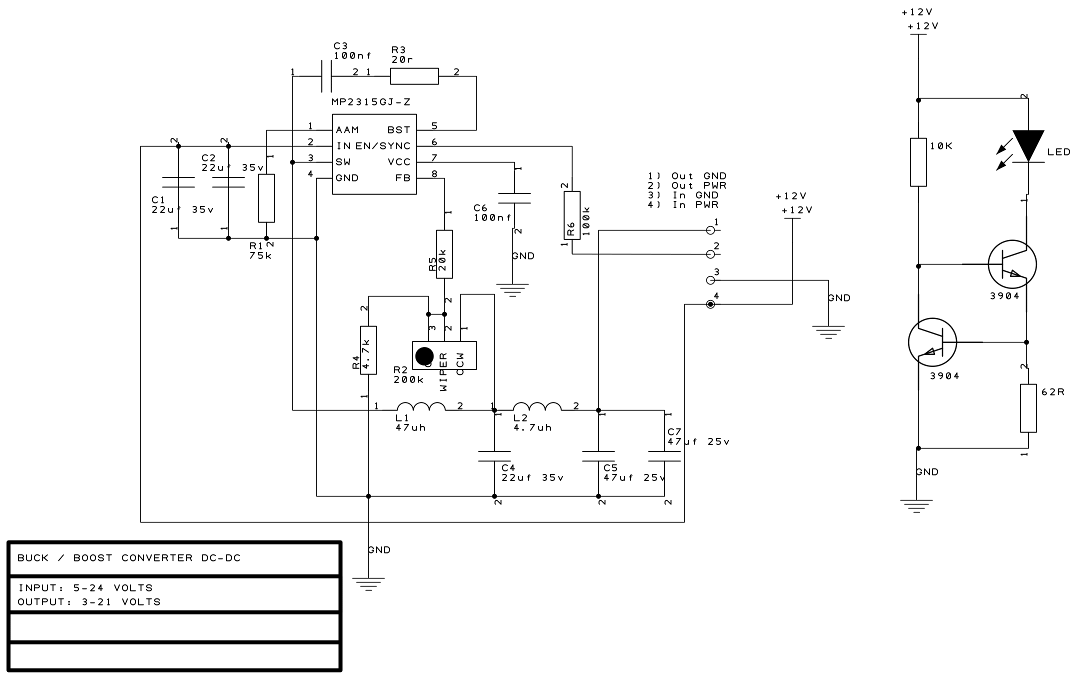

Regarding grounding loops:
From what i have read and can understand what not to do is connect components ground at multiple points. When I began designing a member showed me how to connect tracks. He advised not to have more than 2 points on any one pad. Basically you connect in then out. Try to avoid having a third track stemming from a component. I have done that here.
I also have no isolated ground planes like is shows in the photo on the top layer and the entire bottom is a ground plane as well. I am going to conclude that for this small project there are no grounding loop issues. I am still curious about using pours for signal and current tracks. Notably if I have too many or any un-necessary pours.

After reading the article I made some changes to my PCB. I feel that they apply to my project.

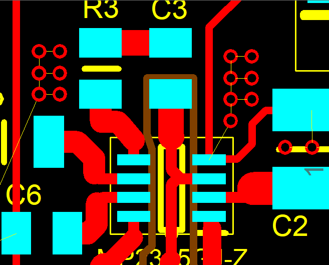

I placed 2-3 ground vias near each capacitor. The manufacture states the following.
"..in order to keep the parasitic inductance and resistance of the connection lower than 5% of their internal ESL and ESR"
But this line goes against what ive been taught here by the group.
"Capacitor connections shall be made with the shortest traces possible, avoiding thermal reliefs." No thermal relief?
Im sure they have a vaild reason for doing so but unless someone here can explain why Im going to keep the relief spokes.
Ive also looked over my schematic and relocated C4 closer to L1 and altered the track so it connects directly to L1 instead of L2. How much of an improvement that will do in unknown but it is logically correct.
The article also suggest that the two inductors showed be further apart from each other when one is being used as a noise filter.

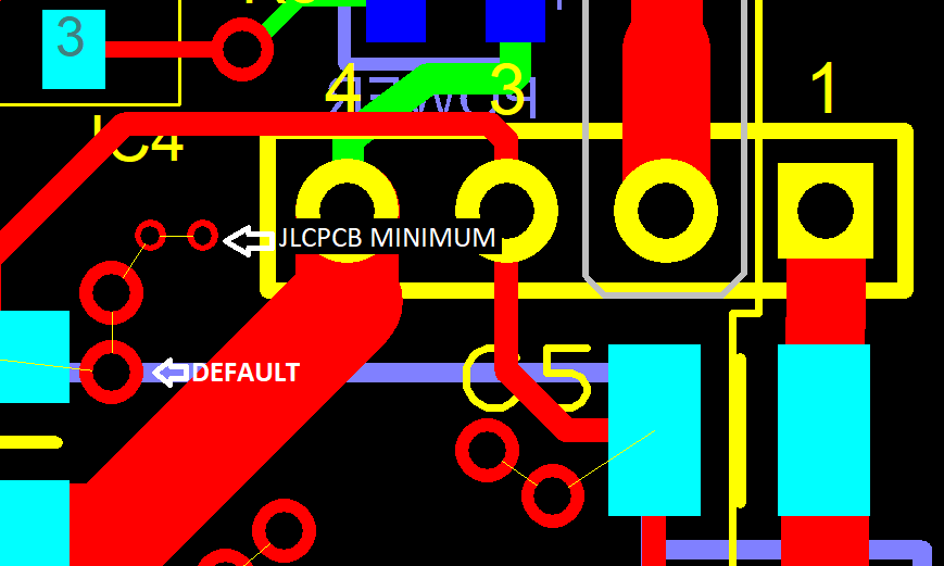

Design spark (free) also does not do tented vias so i had to rearrange an SMD led so the vias were not directly on the pad.
I was looking for what the via size, its hole, and how far to space them would be.
Probably you can make a VIA any size you want.
jlcpcb Drop down to "drill hole size". They show the smallest and largest holes and vias. and spacing. I often do not use the smallest hole. Look at what they can and cannot do.

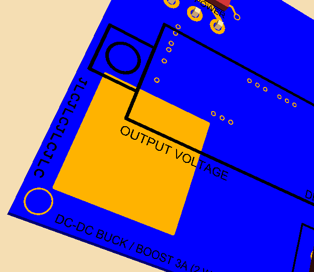

OK tell me i did this correctly or not. I used Design Spark and added a heatsink.
1) created the appropriate size via (.30mm hole x .80mm) and spaced them as advised (1mm apart)
2) assigned the vias to the components net.
3) Added a POURED SHAPE* to suit the component. assigned to the same net, moved it to the bottom layer.
*a poured shape is different from a copper pour area
In this project L1 is a filter so a heatsink is only needed for L2
Inductors and capacitors and resistors will run cooler if they have a good connection to copper. The whole point of a thermal is to stop heat from getting out.
While I try to add a copper area on the bottom layer and vias DS throws an error that equates to "tented vias" and thats not allowed. I mean they are but not in DS. It only works when the copper area and via share the same net. And i dont know if thats what supposed to be done. I have a few questions posted with the DS forum in hopes that they help me figure it out. If not i can just use a small number vias linked to ground with no copper shape on the bottom.

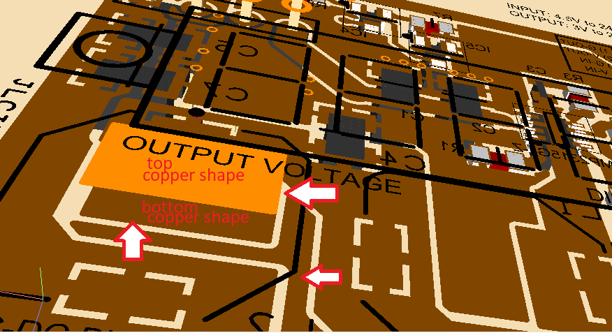

I can appreciate now why it is important to thoroughly understand your circuit. To know where the heat will be, and choose to widen the tracks or use copper pours to control it. If this project was not associated with such an in depth article I would have no clue which to use. I have also learned that wide traces and copper pours may appear to acomplish the same thing but there are subtile differences that make them very different.
From what i have read further reguarding moving heat away using copper pours is there effectiveness is highly opinionated. And while there is lots of discussion on spacing, size, and the number im not finding much on how to apply it in the PCB software. So I still have a few questions on how to add vias as a heat sink. And I mean in Design Spark. Specifically the copper shapes and the vias. What net would you attach them to? Ground, the components, signal net?
If i had the choice i would choose none. but DS does not allow it. (throws errors) Id create the top and bottom pours and place the vias in the void. Save it as a group item and put it in place. Any other pours that are connected to nets and grounds would wrap around it. It would be an island. I think it would be better if i could remove the bottom solder mask too. Thus exposing the copper.
This image shows what I have done. The copper shapes and the array of vias are connected to the signal net on L2. The vias do not show because of the color limitations of DS

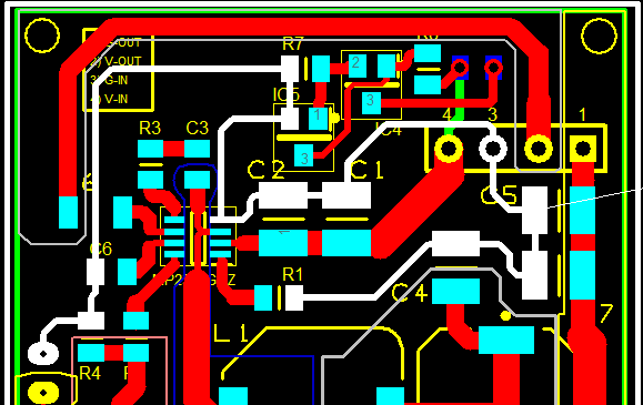

Reguarding Multiple pours on one layer.
I was concerned about the gap between the pours.
Its perfectly fine to have multiple copper pours around nets on one layer without creating any signaling issues unless your circuit has RF signals.

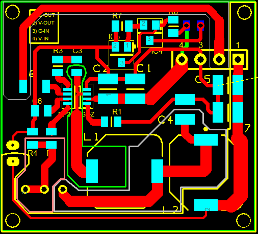

Ive redrawn the PCB to take advantage of the manufactures layout suggestions. I only relocated the track to pin 3 as it was too close to pin 8.
I also did what i could to place all the components where they need to be i relation to the IC and have the grounds of those components in the same general location.
The current mirror at the top is just for an led. Its ground connection is through a via that is on the bottom copper pour layer.
I now have a clear understanding of copper pours and via arrays. I still dont fully understand on identifiying potential ground loops and avoiding them. But i do think this layout is an improvement.

For heat transfer, put an array of VIAs within and around each component connection pad.
They need to be connected to each pads respective net and copper areas in the same net as the pad, on other layers.

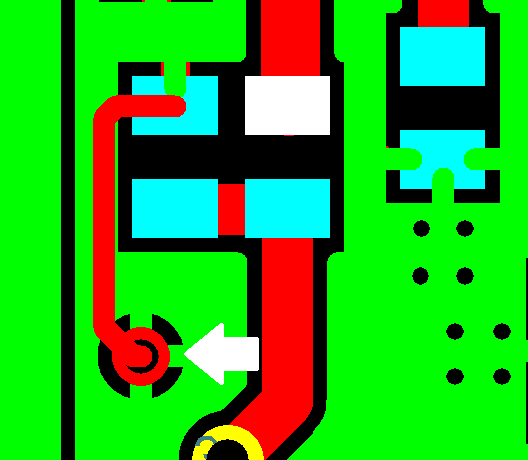

Ok. Im working on that. Of course i have a question regarding spokes.
I get the concept of using vias for heat transfer and a means to join top and bottom planes for better conductivity. For these non soldering purposes i set the spokes to none and set the via to non isolated as shown on the right.
On the left is where i use via to connect a track to ground on the bottom layer. Since im not soldering anything to it does it need spokes? Can i just set it as the others?

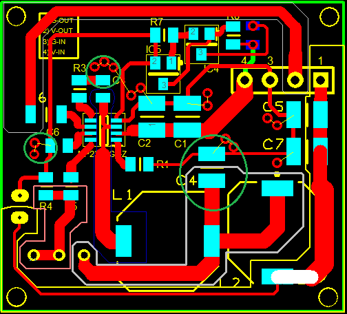

Below is hopefully the final version of my buck converter. Shown with a few copper pour areas filled.

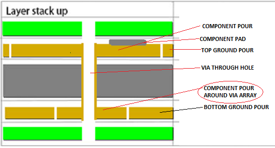

Ive re-read this and may have missed an important step. "on other layers"
since all components are SMD all nets are on the same layer and the vias are through hole would there be an advantage (heat wise) to put a small copper pour or pad on the bottom layer and assign it the same net at that on the top layer? Or just leave the bottom as a ground pour.
Hope this image helps explain.
If heatsinking is absolutely vital, then try to make the copper area on other layers the same as for the component or even larger, and link them with a grid of VIAs.
With ICs that need that style of cooling the heatsink pad(s) are often grounded so not a problem, but for other things then make an island in the ground plane; just try to ensure it has a decent ground area around it still.
Thank you. I wanted to be sure I knew how it was done. The manufacturer doesn't say one is needed but it does say if the placement of the other components can / will affect the chips performance. The inductor does get hot. I put an array under it. Ill read up on how hot it can get.
I have seen on pcbs large pads on the bottom layer under a component with no solder mask. I think they serve a different purpose though. Like when the components pad is covered by the component so a paste is applied then it is heated from underneath to melt the solder.
