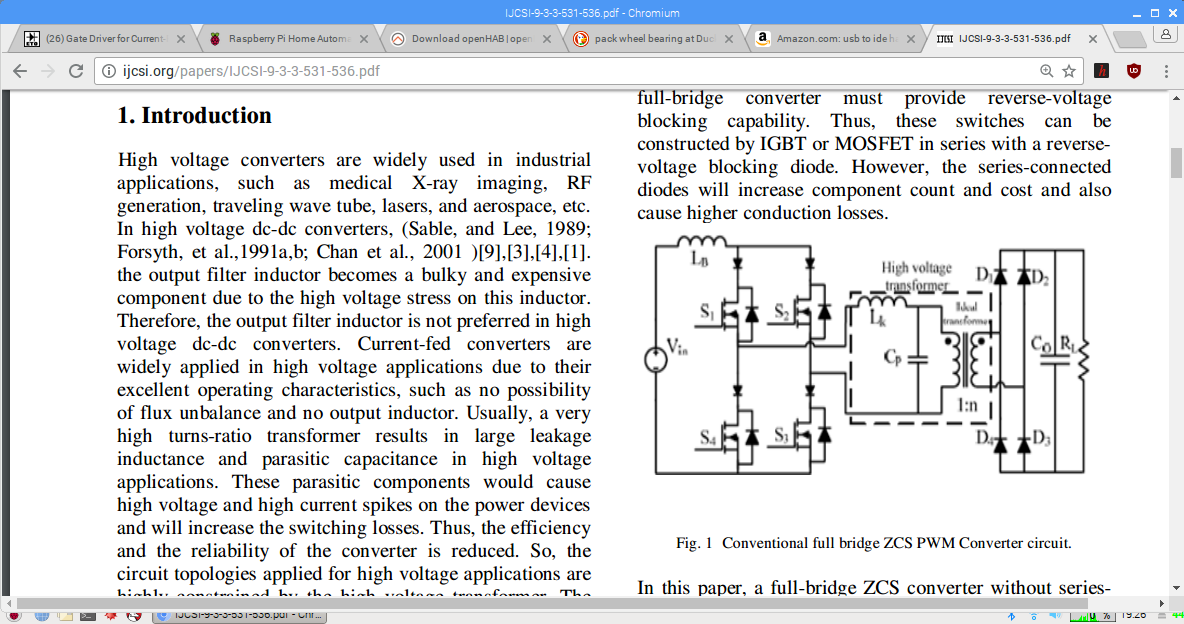

I am trying to find a gate driver for IGBTs for a current-source full bridge topology. The main difference between current-fed and normal voltage-fed converters is that due to a boost inductance at the input, there should always be a path of current flow. So, as we give dead time in voltage-fed converters, here we have to give overlap time. However, I am facing a lot of doubts and problems. Some of them are:
1. How will I use de-sat protection?
2. How will I ensure other protection schemes such as over voltage?
3. How will I ensure that there is always some path for conduction and current never gets chopped?
I would be highly obliged if one can suggest me a good IC.
Edit: Also How will it help if I use MOSFET instead of IGBTs as no Desat protection is used for MOSFET?

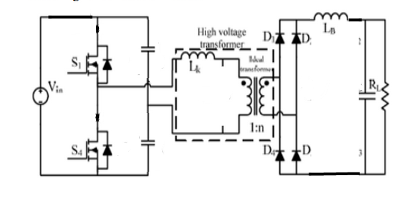

Many years ago I did a MOSFET, half bridge version.
I just noticed what I did was different. I moved the input inductor to the output.
The 1/2 bridge reduced the silicon and reduced the turn ration on the transformer.
It was one of my best. Ran cool. I almost shipped it with out heat sinks.

Suggest you start with showing what exact topology you have in mind, how you expect it to work, what are the input/output parameters etc. Without that it is very hard to give you any reasonable advice.

Vout =500V
Vin=28-42 V
Iout=2A.
Topology is a full bridge isolated boost with passive snubber.

What is the highest peak plus transient voltage that your switches will see?
In my opinion, unless they're seeing 600V or more, mosfets are probably a better choice than IGBTs. There are of course, multiple factors involved in the decision.

Like Ron said, allways one top and one bottom switch has to be on. The cycle of ON devices should be:
S1 S2 S3 S4
S1 S3 (D1 D3)
S1 S2 S3 S4
S2 S4 (D2 D4)
I think you want to make A.
About 30 years ago I made B. Where a simple PWM boost drives one MOSFET . A simple D-flip flop divides the frequency by 2 and drives the gates. The 4-MOSFETs switch when the first MOSFET is on. So for the 4-mosfets there is no AC losses. They switch with no voltage on the Drain.
Because I must keep the cost down, I made C with only 3 transistors.
I made a "gate" drive that is very simple. It will take some time to remember how.
I found (D) in a old pile of prototypes. I used a simple boost PWM IC. Any time the IC wants to turn on the FET it turns on both FETs. When the IC turns off the FET one stays on. See the two OR gates and the toggle flip flop.
I don't know if this helps you. I think (D) could be changed to a full bridge.
