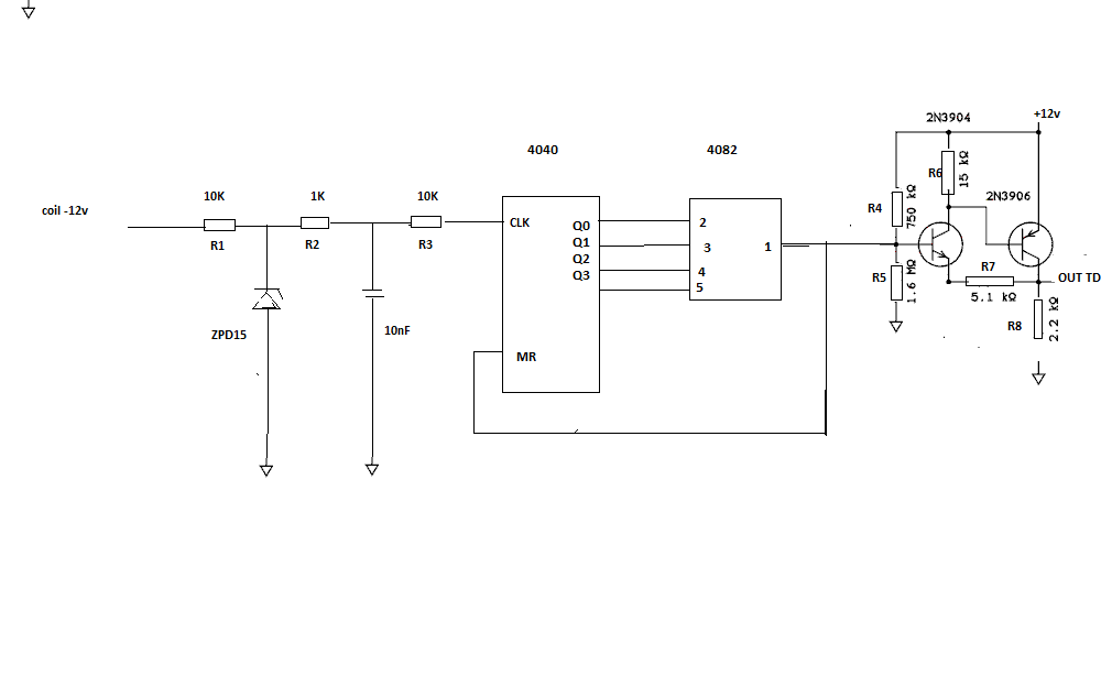

OK folks, please be patient, I'm just a rusty old amateur tech person.
Here is my schematic. The 12vdc to the circuit will be provided by a 12v regulated supply to eliminate transient noises. It will supply the 4040 and 4082 along with the ouput buffer.
That (stolen;)) output buffer part of the circuit was is originally powered by 9vdc, so the resistance values will need updating ? suggestions please ?
What do you fellows think ? I need something simple that will provide that strange TD signal that Mercedes requires.
BTW it's for a (Euro) 1988 500SEC that is getting digital ignition which cannot provide the standard TD signal ...
Denis

Makes sense and also makes counter parts count down to just ONE 4040.
What about the R values in the ouput buffer, are they OK as is or do they need tweaking ?
Denis

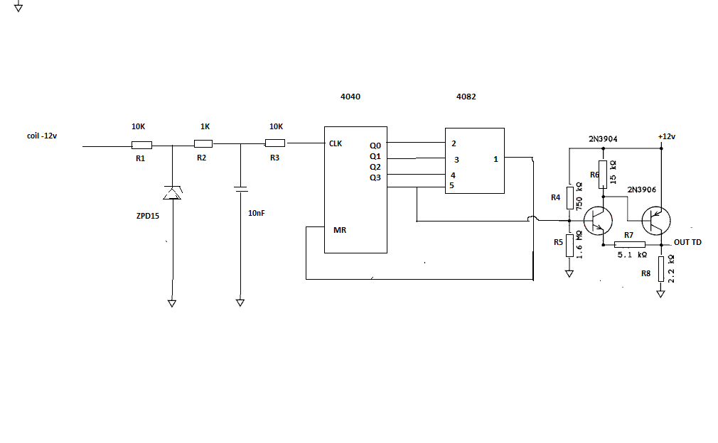

Ok the most recent version of my schematic (without the regulated 12vdc power supply).
Is 10K enough to limit that coil signal ?
Any comments, suggestions ? o_Oo_Oo_O
Denis

Although 1111% is indeed 15 decimal, remember that when the counter resets it starts from 0. So there are a total of 16 counts.
You require to decode 14. Which can be easily achieved with an inverter at Q0.
