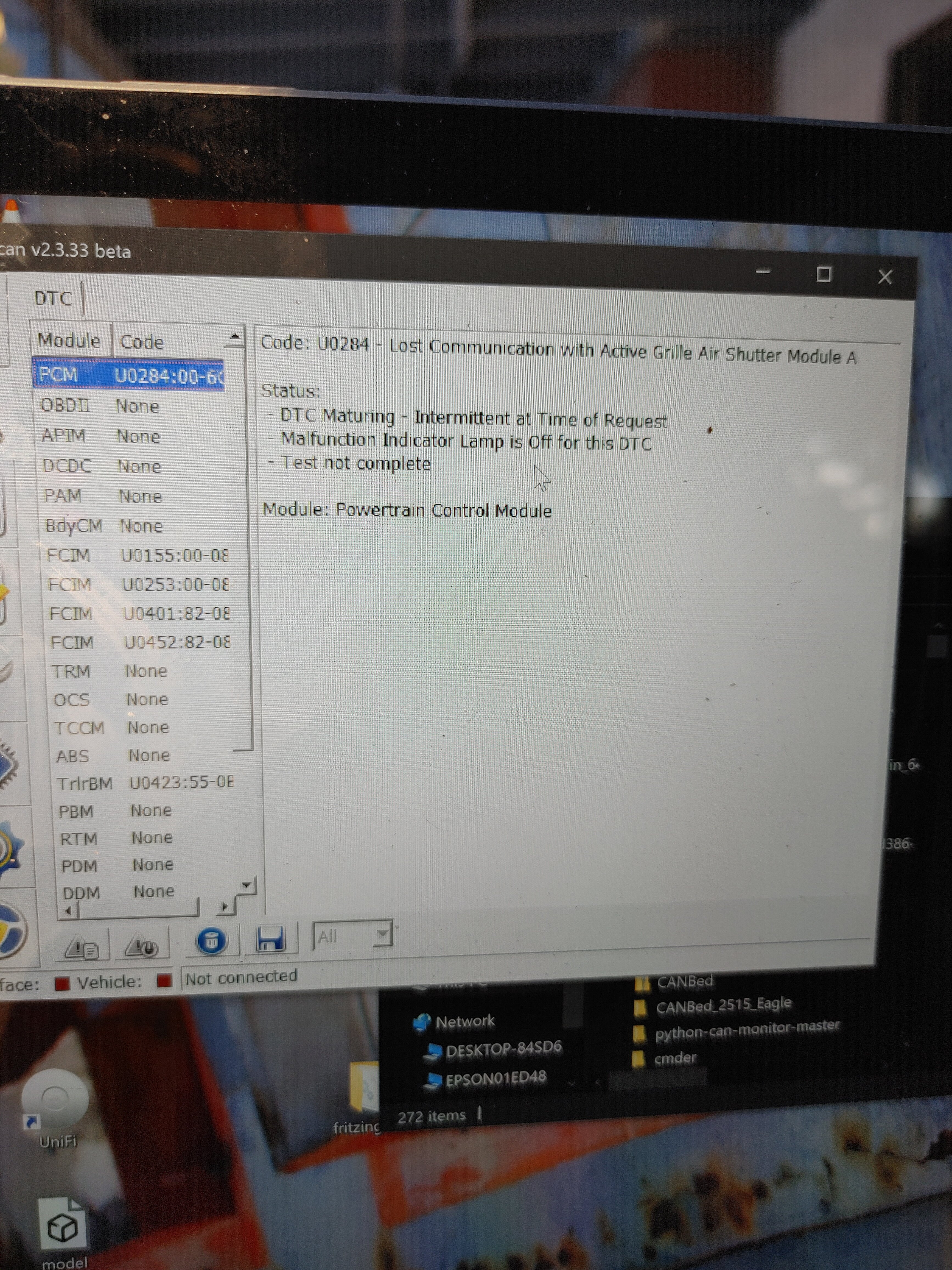

I am interested in the wake up messages as well. I upgraded the power seats in my truck and the new Driver Seat Module is connected to the medium speed bus. As you said before there is only one Hot At All Times circuit that powers the module, according to the donor trucks wiring diagram. So i would like to create a module that will send the wake up messages when the Hot In Run circuit changes state. I purchased a 2ch CAN interface for a raspi and i have access to a functional truck of the same year as the donor truck. I am new to decoding these signals but I would be glad to give you some CAN dumps or other information. There is very little information on these systems so i would be glad to help out.
Would you be able to get a log of the CANbus from the functional truck? If you can get a log of CAN bus waking up, and one of it shutting down, that would probably give a very good idea as to what the wake-up signals are.
Yeah, I will let you know when I get the logs.
Quick update on the DSM, I finished making the adapter to connect the new wiring harness to the old and the DSM allows the seats to move without CAN communication. However I was not able to get the seat memory function to work. The old module(non-CAN) seemed to store the position data in itself, I assume the new module does the same. The old module also directly controlled the pedal position where as the new module communicates with the steering column module to command the pedal position. There is also an audible tone that is heard when setting the seat memory position on the new system which I believe is also commanded over CAN. Maybe there is an acknowledgement message sent by another module to allow the memory to be set. There was a feature that changed seat position based on 2 different keys used in the ignition, not sure if this feature was equipped in the donor truck but I suspect I can't get the memory functions to work because I don't have the correct communication to the module yet.
I am working on the A/C controls as well. I hooked up power to the module and it did nothing. So that module must need the wake up commands. Now that my seats move, even though they don't have memory, I'm going to make the A/C controls my primary focus.
I'll record separate sessions, concentrating on specific modules. Any guidance would be welcome since I am new to CAN bus sniffing.

Sorry this took so long. I was able to log the working vehicle MS CAN Bus and after some trial and error I found that these 10 CAN Frames were able to wake up and allow control of the HVAC module of the donor vehicle.

These messages had to be played in sequence in order for the module to wake up and allow control of the temperature and duct settings. I tried to play them one at a time but it would only wake up the module and flash the illumination LEDs and turn back off. This also happens if you just send any CAN ID. Seems like the illumination function reacts to any valid CAN message, I noticed when you first insert the key into the ignition the illumination in the vehicle will turn on for a moment.
I recorded a session, on the bench, playing the 10 messages once without touching any buttons on the module. I waited a moment and played it again but after the module woke up and allowed control, I pressed the Seat Heater button on the module.

I was looking for a much, much longer log showing wake-up on the CANbus. Your burst of 10 messages lasts just 35 ms.
The module is sending messages with id of 0x503, and the behaviour of those messages is the same as the ones that are in the range 0x500 - 0x57F on Landrovers and Jaguar cars. (The ones in the range 0x580 - 0x5FF do the same job, but in a different way)
What I would like to see is a log of the car waking up that lasts about 5 seconds, but only of messages in the 0x500 - 0x57F range. A similar log for shutting down would be useful.
The situation is that modules need to use quite a bit of power to run in a way that they can read CAN messages, so when the car is asleep, the modules can't run in that mode. When the modules are fully asleep, they take virtually no power, but any disturbance on the CAN bus will wake the modules. For waking, that is reasonably easy, as the modules will be woken when the first module wakes. When shutting down there has to be some way that the modules agree to stop transmitting. Obviously the modules will stop at slightly different times, so each module will stop transmitting, and then wait to make sure there are no more messages to do with staying awake, and ignore the other messages. Some time after all messages have stopped, the modules will go to the low power mode.
So any message at all will wake the module, but it may then go to sleep if there are no sleep/wake messages, only to be woken again a moment later.
What happens is that all the modules that form a "ring" with each module transmitting 100 ms after the previous one. The first byte of each message is the ID of the next module in the ring, without the 0x5 at the start. The IDs go up in order, so if you have three modules, the sleep wake messages might be like this:-
0x525 33 12
0x533 37 12
0x537 25 02
with 100 ms between each message. That pattern would repeat as long as the car is awake. Obviously the other messages would be happening at the same time.
The 2nd byte has a 1 in the first nibble when the module is ready to sleep, and a 0 when it needs the CANbus to be awake. So in this case the module transmitting 0x537 needs the CANbus awake. The 2nd nibble of the 2nd byte is 1 when the module is working, and 2 when the ring is stable. As the car wakes up, the different modules work out the order of the ring, and it's a bit chaotic for a couple of seconds, but if they all follow the rules, it all sorts itself out in a few seconds.
The message you logged, of 0x503 03 04 00 means that the module can't find any to form a ring with, so the next one in the ring itself, and the 04 means there is a problem. When it transmits 0x503 03 14 00, that means it is about to go to sleep.
If you just transmit:-
0x501 03 02 00
every 200 ms, the module will stay awake. It will transmit
0x503 01 12 00
every 200 ms, each time about 100 ms after the 0x501 message.
When you want the module to go to sleep, you can just stop transmitting, or you can send:-
0x501 03 12 00
100 ms after that, the module will transmit
0x503 01 32 00
and will then fall silent and go to sleep. The 32 means that the bus is asleep, and there will be no more messages in the 0x500 - 0x57F range.
I think that once you get the module to stay awake, it will make working out the other signals a lot easier.
I've just realised that there's a simpler way of getting that module to stay awake. As well as the 0x503 message with its complicated systems for keeping awake, your module also transmitted an 0x583 message.

We have some progress! I was able to find the message that will allow control of the HVAC module... Sorry for the confusion, i will try to be more detailed. When i was describing the illumination I was referring to just the back lights for the buttons on the module. At first I thought the 0x5xx messages may have been just the brightness levels for the interior lighting of the vehicle but, with your insight, i see that these messages are much more complicated.
A friend of mine asked if i could help him with adding a Ford Trailer Brake Controller to his 2016 F150. It did not have one at the time of purchase. He had installed the controller but the truck would not recognize the new module. I had heard of Forscan before but I never used it because my vehicles were too old to take advantage of what it can do. We were successful in adding the module and now he has Ford Factory Trailer Brakes on his truck.(Ford dealer wanted his truck ALL DAY and wanted $150) Now that I am trying to add new equipment to an old truck, Forscan may become more useful. After we added the TBC module, i realized Forscan had some DTC information that was not causing a MIL status.
We found that a wire was nicked near the grille of his truck. We repaired it and all was well.
I bring this up because i was thinking maybe the 0x5xx messages are some kind of checksum or error reporting to a higher level. The reason i think this is because i found the message that will allow the HVAC module to wake up and turn on the "keyboard" functions of the module. The message is 0x3A0 [8] 45 00 80 02 89 24 00 00 played at 200ms. The 0x501 message was not needed to get this result: Youtube Video.
Since i was able to get the HVAC module to work, i identified the message sent to the Dual Climate Controlled Seat Module (DCSM) to activate the TED (peltier) chips in the new seats. This is what i wanted to accomplish in the first place but this was achieved without the 0x501 message. Whats most interesting though, i have since added the DCSM to the bench network and recorded a candump of the 2 modules reacting to the 0x501 message you had suggested before: CANdump
I would like to hear what you think. I am probably way off base.
