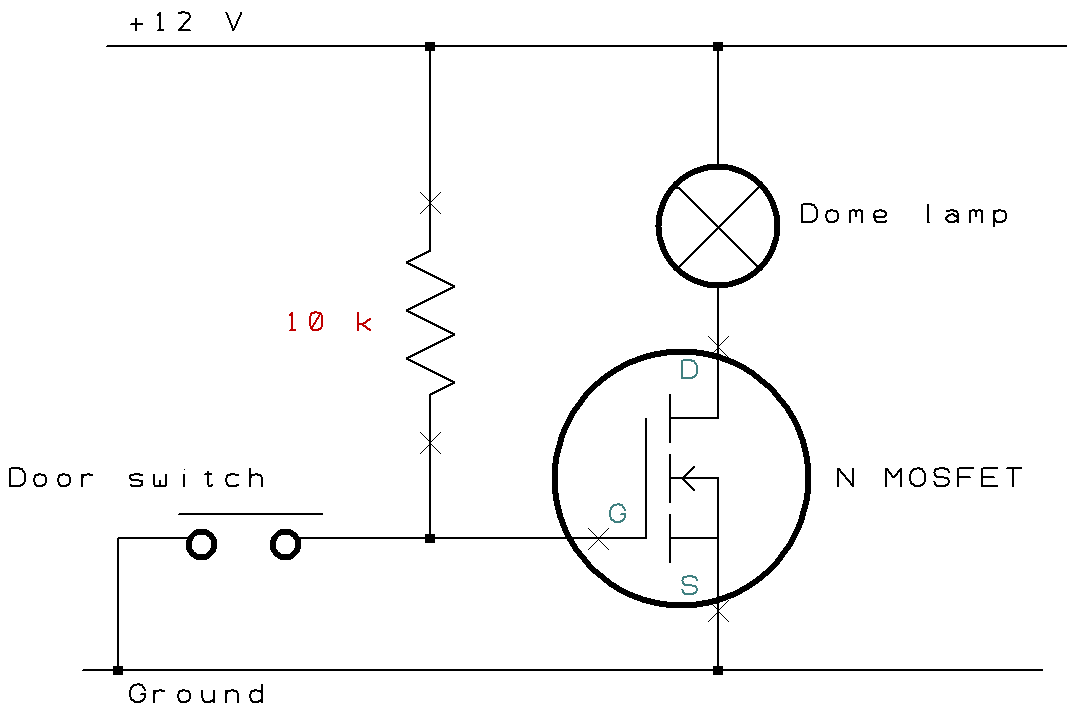

The door switches only turn the interior lights on when the front doors are open. Basically, the ECM I purchased used belonged to a truck.
Now on a smaller sedan I might be able to get by with the rear interior lights not working when the door is opened. However on a vehicle this big it is not too fun in the 2nd, 3rd, and cargo area to be opening doors with no resultant interior lights.
So I grabbed myself a wiring diagram and found that the main dimmer switch allows all of the interior lights to come on when a ground signal is received. That circuit then goes through the instrument cluster where there is an internal relay.
That gave me a bright idea. I have the pinouts for the VSM and know which pins/wires are connected to the VSM via the rear door switches. Real easy access!
The only issue that I have is that door switches send a ground signal when the door is shut. In that scenario, the interior lights come on when the rear doors are shut which is exactly opposite of what I want.
Is there anything simple that I can do to force a ground signal to the main dimmer switch? I don't want to do anything invasive since the door switches are a nightmare to access and want to leave what is working well alone.
A relay for each door switch? Would that work? Anything simpler?

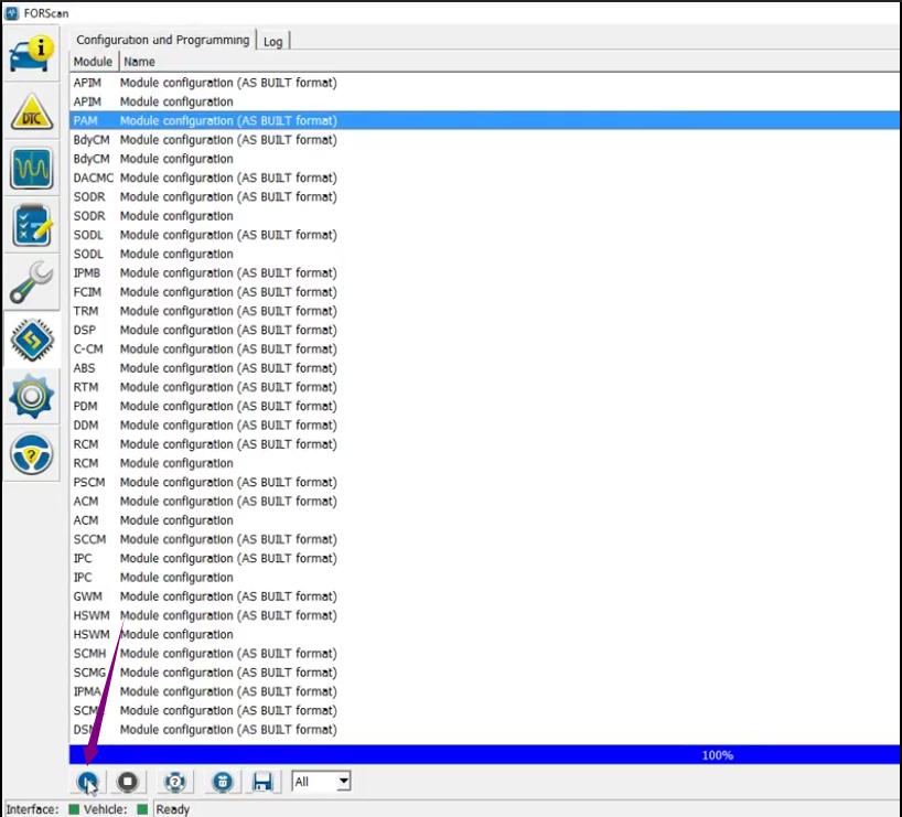

Got the cable and ForScan. I cannot see any location which allows modification of the VSM unfortunately.

Do the door switches connect to anything at all now that you have a VSM designed for a truck?
Relays are probably not a good idea as you would need one for each door, and they would probably end up being turned on the whole time that the doors are shut, so the current taken by the coils would be discharging the battery even if the lights are off.
One problem that you could have is that the switches may not work reliably with a really small current, and you can get leakage currents quite easily if there is moisture anywhere. As the switches are on when the doors are closed, they will take current when the car is left with the doors closed. Car manufacturers get around that by pulsing the current to the door switches. They would be using something like 10 mA or so, but only turning that on for perhaps 1 ms every 100 ms, so the average current is only 0.1 mA per door, which is fine, and the delay of 100 ms wouldn't be noticeable.
You could have a MOSFET for each door, and a compromise current of 1 mA which will probably work fine and won't add much to the current when the car is off. I can draw the circuit out if you want.

Once you have clicked the Forscan connect button & the connection has finished setting up, go to Configuration and Programming - the diagonal IC symbol.
That should show a list of accessible modules in the vehicle - what do you get in there??
You could do a backup of the vehicle as is, if you follow this -
That uses the same functions pages, to read all the accessible module.
The VSM settings could be part of the BCM data, from looking at the file I grabbed??
Would you mind drawing this circuit please? Thanks.
When the door is closed, the switch will closed, so there is no voltage on the MOSFET gate so it is turned off.
When the door is open, the switch is open and the supply voltage will be applied to the MOSFET gate via the 10 kOhm resistor, so the MOSFET will turn on and the dome lamp will come on.
There will be around 1 mA flowing though the 10 kOhm resistor all the time that the car is not being used.
Depending on how the rest of the car works, there could be issues with this.
The VSM is only looking at the front doors. If the supply to the dome lamp turns off when the front doors haven't been opened for a while, then opening the back doors won't bring the light on.
If the VSM (or whatever powers the dome light) detects that the dome light is on when it didn't turn it on, then you could find that it will refuse to turn the light on after that.
I will have to look further into the circuit but this is great! Thanks!
