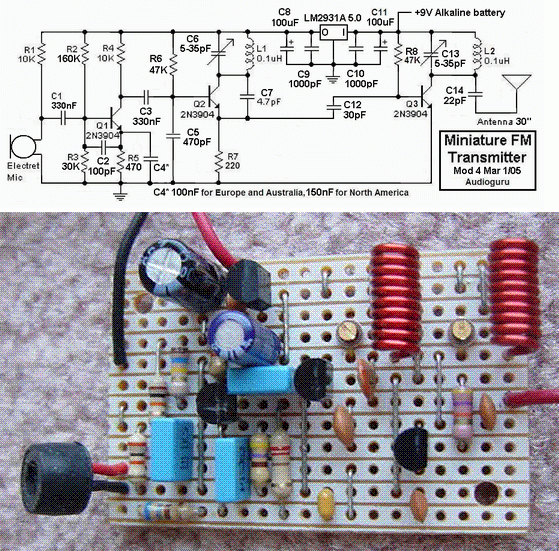

Hi Burningmace,
Your changes to the transmitter circuit will stop its oscillator from working.
the coil must be from the collector of the oscillator transistor to +9V and the RF amplifier must be capacitor-coupled to it and be biased with a resistor.
Here is my FM transmitter circuit:

audioguru - I did see that before and it looked too complex, but on a second look it's actually not as complex as I thought it was. Is there a simple way to remove the electret mic and replace it with my audio jack?
I've ordered the parts for the transmitter, plus a few extras I needed. I assume that using standard 33K instead of 30K on R3 and 33pF instead of 30pF for C12 shouldn't make a difference, as it's within tolerance of the components anyway.
Will 6 turns of PC molex cable wire around a standard sized pencil do the job? I figure I'll need to stretch it to be about an inch long.
No. You need magnetic wire. You can buy some online or scavage some from old transformers or coils. If I remember correctly, the coils are 9 - 11 turns with about 5/16" inside diameter. I don't recall a center tap, but you'll have to double check that.
I know from experience that the most critical part of getting an oscillator to osciallate is the Q of the network. The coil is usually the part that determines circuit Q. Use the correct wire and wind it correctly and you'll probably get good results. It's not all that hard really.
Hi Audioragu,
I like the design of your FM transmitter. I can see the preemphasis cap is C4 and calculate its turnover frequency is ~2,260 Hz, depending on the tolerance of C4.
How do you generate the modulation? Does C7 have variable capacitance with voltage? If so, is it ceramic X7R or what type of cap did you use? I don't see any other components that could generate the modulation.
