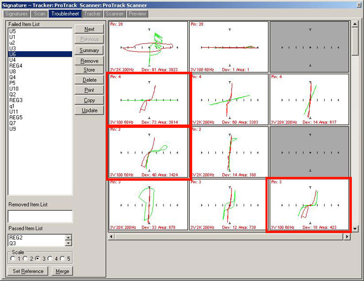

Check all solder joints and contamination. THen check voltage waveforms if you can on all interface pins. Failing that a VI scope trace with a small current source AC signal and series R to any junction can often find EsD damage on pins ( Huntron tracker method) with large capacitance and phase shift on 1kHz not being a linear straight line in XY mode on scope. but a round phase shifted trace due to ESD damage or shorts or opens.

Is the like the old octopus tester?
Something like that... The capacitance of CMOS increases dramatically when wounded by ESD, (but not shorted yet), ( as do all diodes incl LEDs) so it detects faults not easily found when thousands of nodes and no documentation exists. No need for transformer, just signal and series R for current sensing and limiting with VI mode on scope. Sensitivity increases with f (kHz) for capacitance and also increases with forward voltage outside the rails of Vcc/Vdd, thus highly non-linear response beyond the rectangular zener-like curves can occur with damaged IO circuits.
Huntron has been a favoured tool for "supertechs" to debug unusual prblems. With two units (one known good) a comparison gives even more information.
Modern units have full schematics with fixtures for bed of nails and RF probes and memorized waveforms for automated testing.
