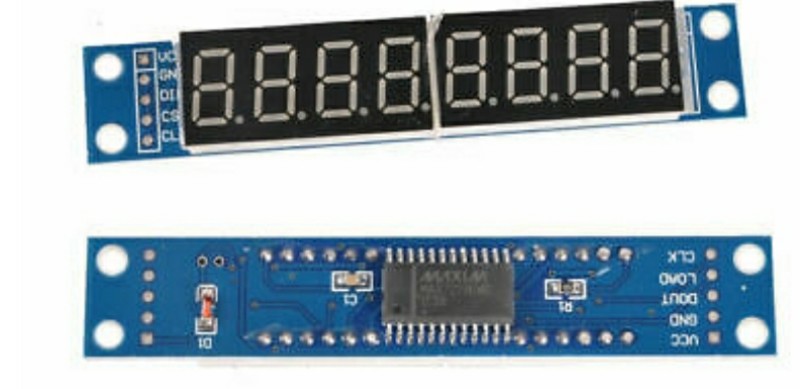

An LED driver chip such as the MAX7219 handles all the complexity of driving either eight 7-segment digits or an 8×8 LED matrix. You just tell the chip what to display and you're done with it until you want to display something else. Much less overhead and busywork in your code that way.
I have several of the MAX7219 chips but would need to redesign my board. I am wondering why most of my routines work great EXCEPT Five, Three and One. Only common thing I come up with is a middle segment is used but it is used on the 12 - 7 routines with no issues. That should eliminate any shorts or defective Led matrix.

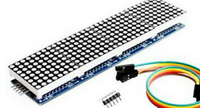

Last time I did this... I arranged the 8x8 matrices into a array of 32 x 16.. Then lit the leds like pixels of a screen.
The screen was held in a " backbuffer " and was written to the led matrices in an interrupt... Very smooth transitions.
I have video's but they are for 4 8x8 modules..

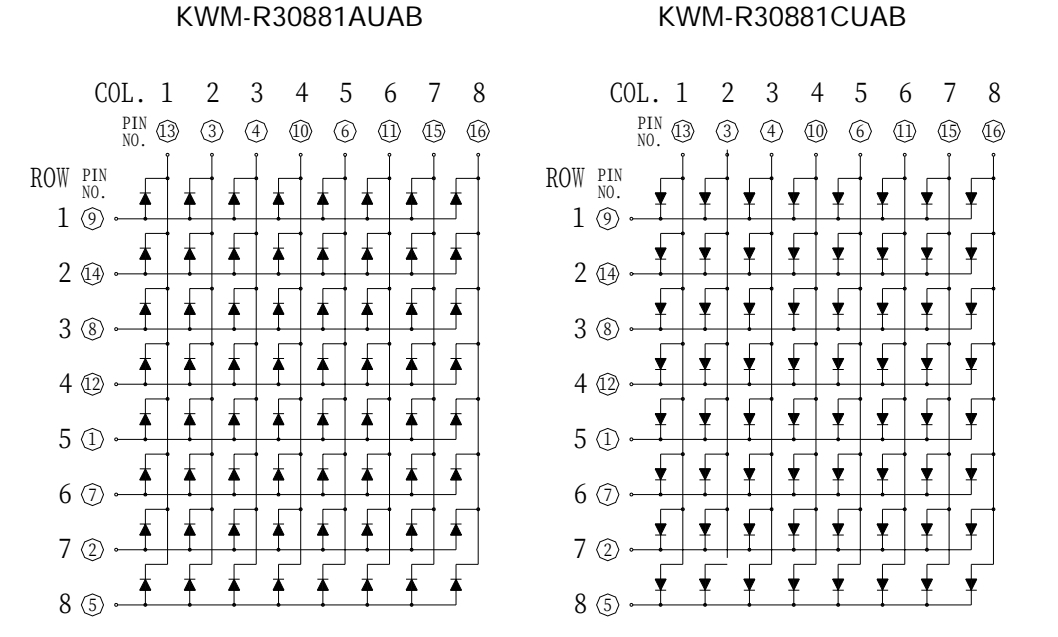

Not sure why but went from common anode to common cathode and no ghosting?
Sorry, your code is more of a mystery than I care to unravel.
However, I believe you are using 8×8 LED matrices if I recall this saga correctly. I don't quite understand what you did to switch from "common anode" to "common cathode" as the nomenclature really doesn't make much sense in an 8×8 matrix. You can talk about row-common xxx or column-common xxx, but if you get right down to the details, a line of LEDs will have common anodes. The line of LEDs at 90° to the first line will have common cathodes. Whether the first line is a row or column depends on how the matrix is oriented.
So, I'm assuming you didn't change your code to "switch from" common anodes to common cathode. What you probably did was swap connections around. If this is indeed what you did, the problem is you had some shorts or wrong connections to start with that got corrected when you switched things around.
To illustrate my point about common anode vs common cathode, compare the schematics of a row-common-anode and a row-common-cathode 8×8 matrix. Rotate one of the images 90°, and you'll see the connection are exactly the same.
Just to be complete here, the above applies to monochromatic LED arrays. If you have an RGB array, each dot has a red, a green and a blue LED. In this case, each RGB LED will be either common anode or common cathode, but there will be a separate red, green and blue connections for the non-common column or row.
all I did was change the port disginations. The matrix pin outs are the same.
changed this
PORTD = Cathodes_Data(x) //rows top to bottom
PORTB = Two(x)// colums 8 (L-R the X is the scan
to this
PORTB = Cathodes_Data(x) //rows top to bottom
PORTD = Two(x)// colums 8 (L-R the X is the scan
worked like a charm
