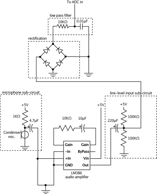

So here's what I found from my searching. LM386 amplifier -> diode-based rectifier -> simple cap / resistor based low-pass filter.
Am I on the right track? Attached is a diagram that seems simplistic enough. Of course I don't require the line-level portion of the circuit, so if I just leave the supply bypass capacitor (220u) in and the 100k resistor connecting it to ground, it should be fine?

Nice try, Omar. But:
1) You don't want a condenser mic that needs a 48V bias voltage. Instead you want an electret mic that has the 48V built-in its electret material.
2) The 1k resistor value feeding power to the Jfet inside the electret mic shorts its signal. With a 5V supply then use 4.7k ohms.
3) Use a low noise, low voltage opamp, not a noisy LM386 power amp.
4) Instead of a full wave bridge rectifier by itself, make a half-wave "precision rectifier circuit" that has the rectifier inside the negative feedback of the opamp so there is no "dead zone" of input signal.
5) Instead of your low pass filter, make a "peak detector circuit" with an opamp that has a fast attack and a slower decay.
My Sound Level Indicator project drives LEDs in 10 steps as a VU meter.

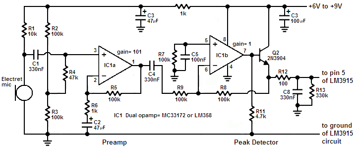

This is the mic preamp and peak detector circuit:

I used an MC33172 dual opamp because it works when its supply voltage is as low as 3V and works when its inputs are at its negative supply voltage which is 0V in my circuit.
Four AA alkaline cells make a total of a little over 6V when new then slowly drop to 4V when dead. If you don't use a higher voltage and regulate it then the max output from the opamps will be a little more than 5V when the battery is new and will be a little more than 3V when the battery is dead.

I'm using the preamp and peak detector given by audioguru in post #13 - thanks audioguru! I am using a cheap electret mic, and get no more than 1V out of the peak detector, no matter how loud the noise I make. I'm driving the preamp with a 5V source. I want to run the output into an A-D converter using a reference voltage of 3.3V or 5V (I can use either), so I figure an output range of 0-3.3V or 0-5V from the peak detector would give me better granularity than 0-1V. I am a software person who knows enough about hardware to make me dangerous... I have a couple of questions about audioguru's preamp and peak detector:
(1) is R12 100k ohm or 100 ohm? I assumed 100k ohm.
(2) how can I increase the gain of the preamp? I think if I play with the values of R2-R6 I will change the gain of IC1a - I guess I can't really change the gain of IC1b?
R12 is 100 ohms so that transistor Q2 can charge C8 very quickly and the voltage is not reduced.
Nothing should be changed in my preamp circuit. The dual opamp especially must be one of those two that work perfectly when an input is at 0V.
If the gain of IC1a is increased then it will not detect high audio frequencies.
What is the voltage of pin 6 of your LM3915? On mine it is biased by 220k from +5V so its voltage is about +0.56V then the LM3915 is VERY sensitive. Loud sounds increase the voltage of pin 6 then it is less sensitive. Since you feed the signal into an A-D converter then another opamp is needed to boost the signal across R13. An MC33174 or an LM324 are quad opamps.

Ok, I changed R12 to 100 ohm, but I still don't ever get more than 2V out - measuring with an oscilloscope and tapping on the mic. I'm not using an LM3915 - I'm feeding the output of the peak detector into an MCP320x A-D converter. It's a 12-bit converter, and I'd like the output of the peak detector to be 0-Vref for the A-D converter so I get better granularity (I was going to say precision, but granularity is probably more correct).
