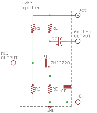

Has anybody tried using a piezo transducer feeding a Jfet? Its horrible frequency response will seriously mess up lung sounds.

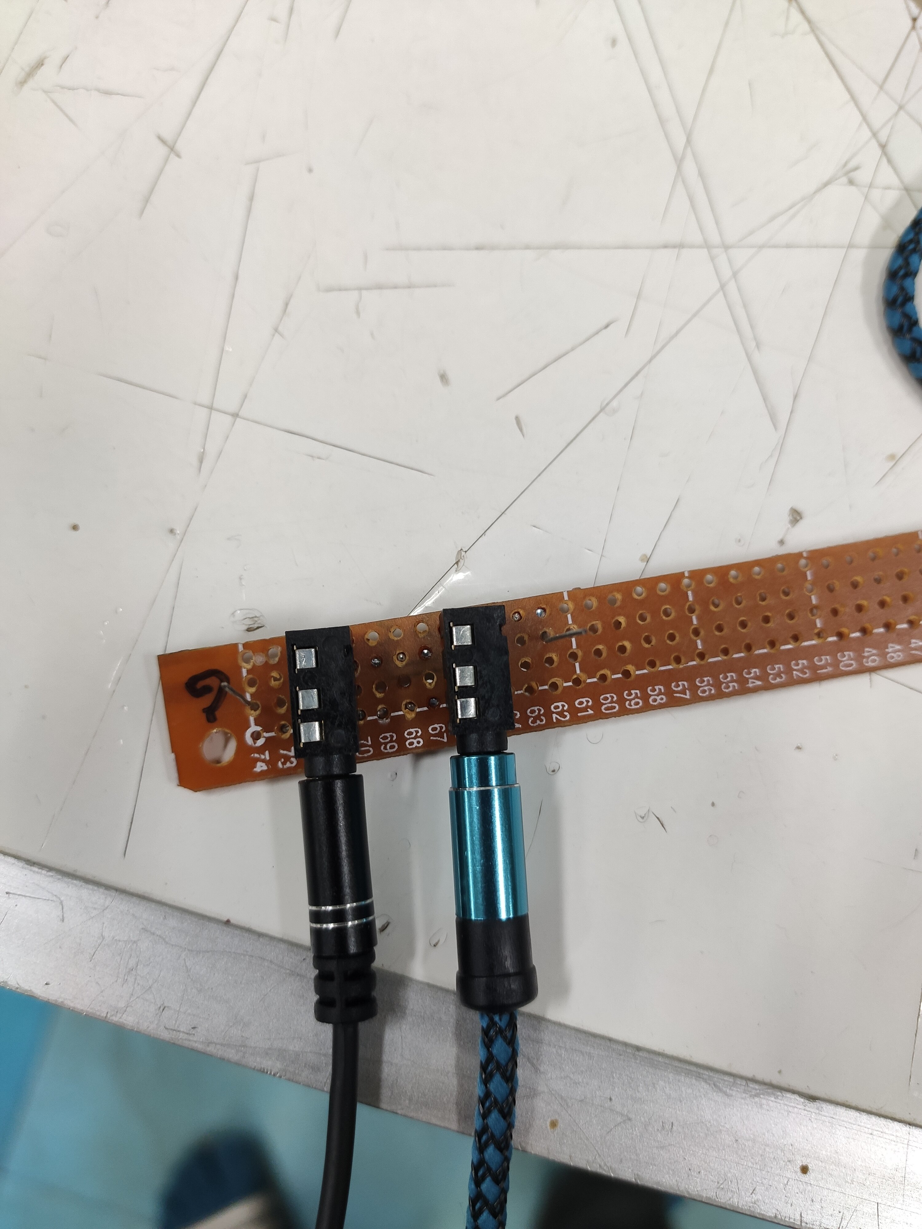

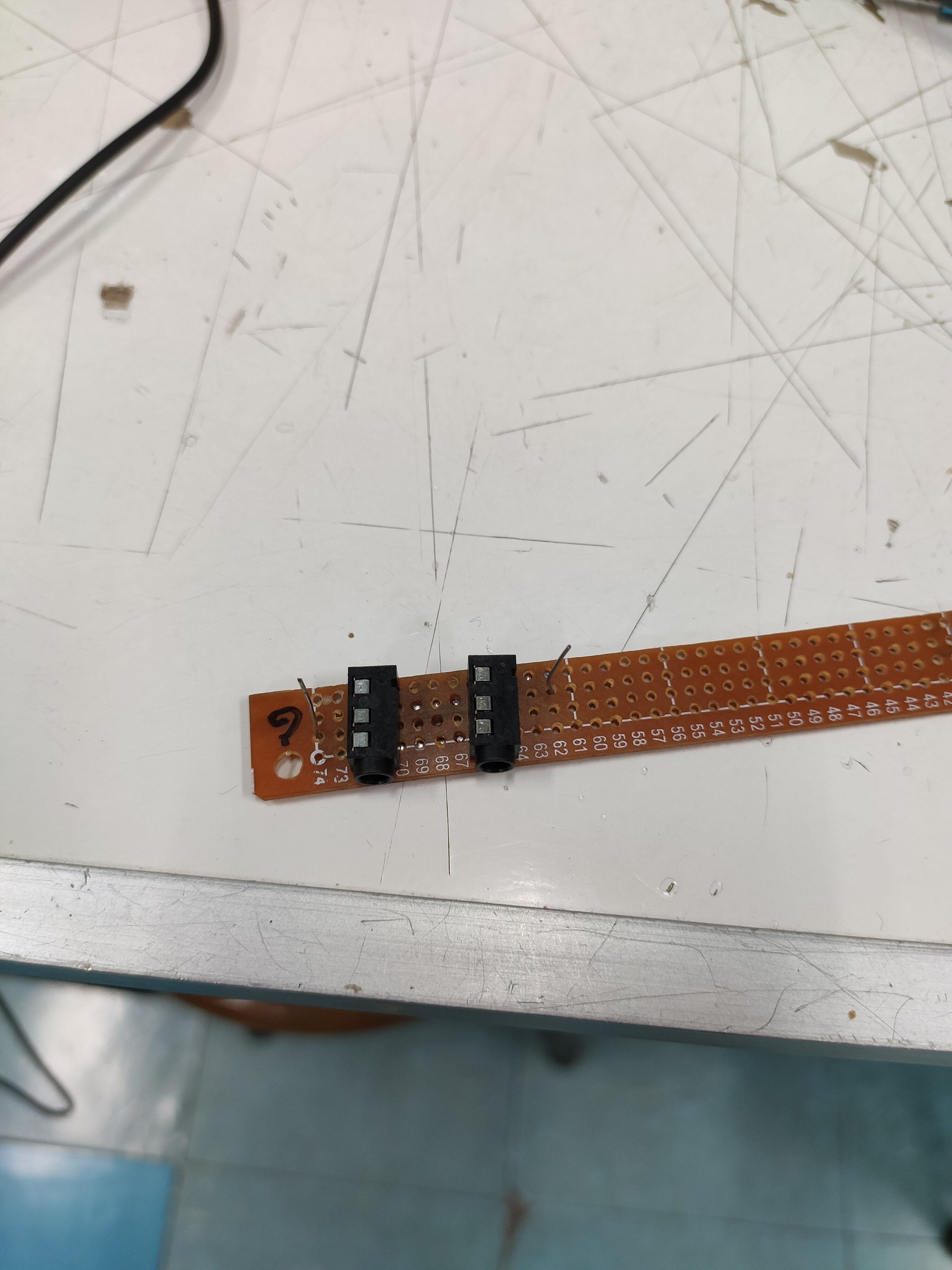

Sorry guys. I have been a while since my last update. TRRS female socket received. Done some experiments and would like to update.

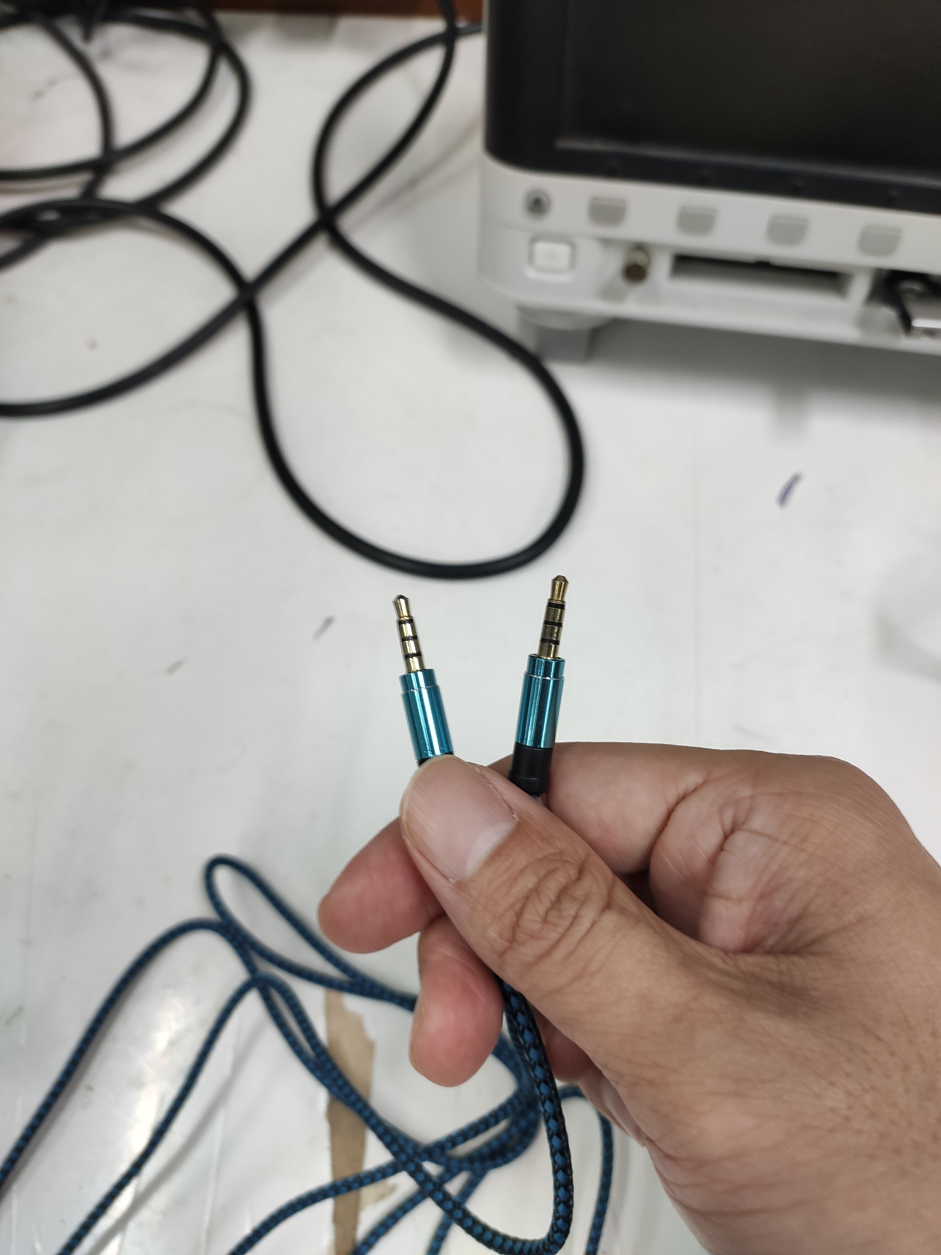

Here is trrs femal socket on the perfboard for phone input clipping test. Two jumper wires are for probing purpose.
Male-to-mele trrs cable for connecting to phone.

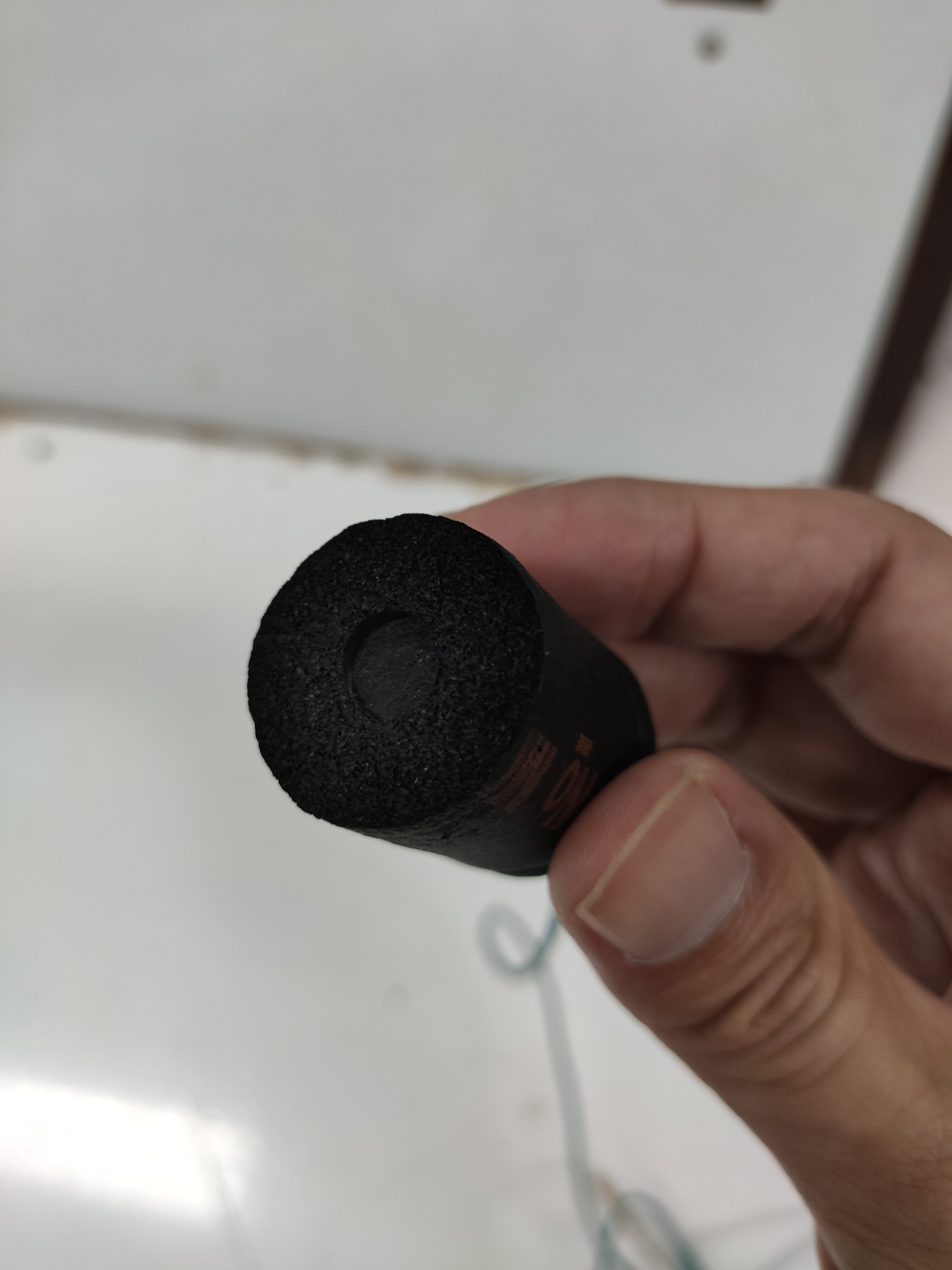

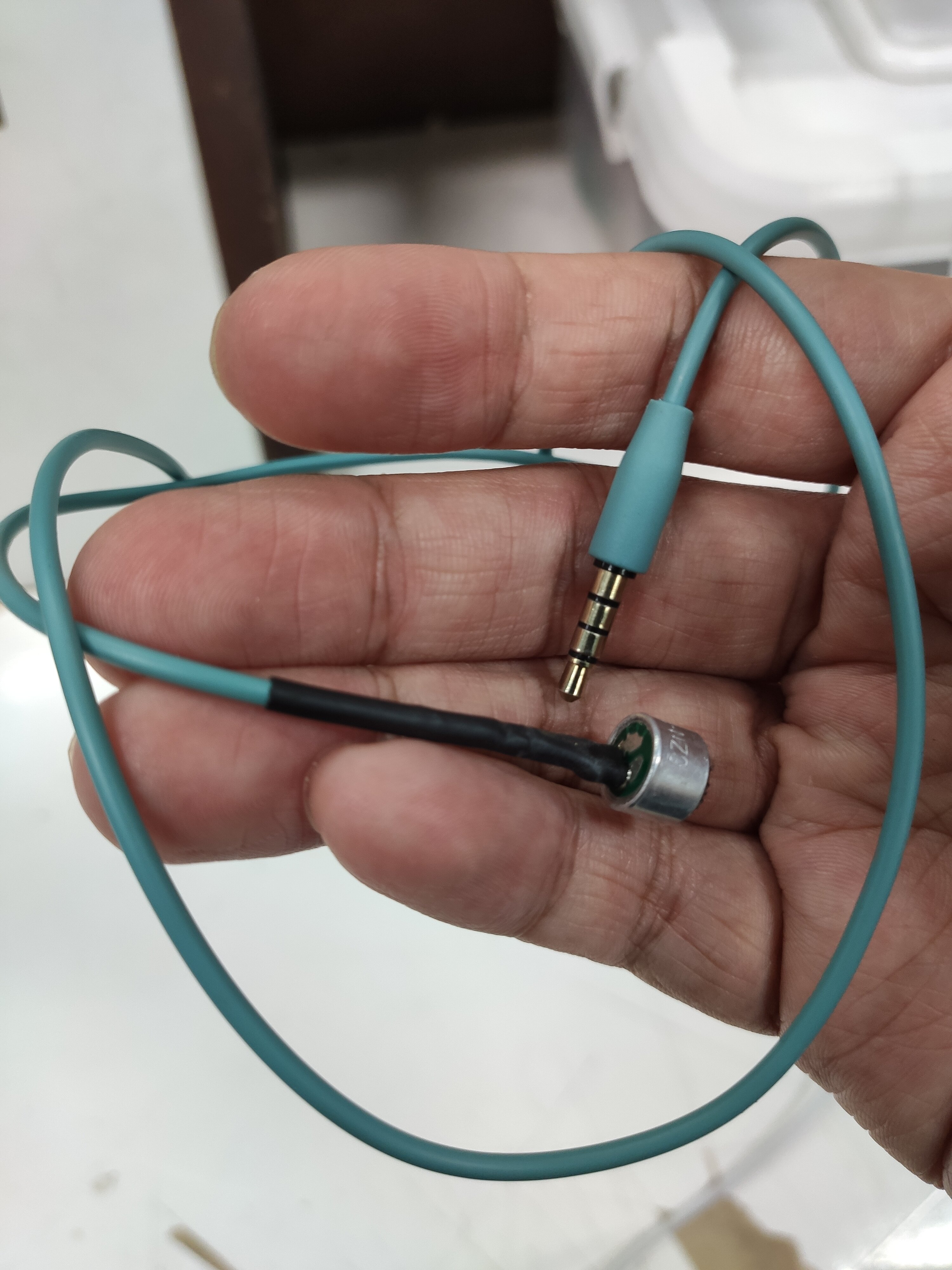

DIY Steth head with funnel and lavalier mic.
Connected according to this diagram.

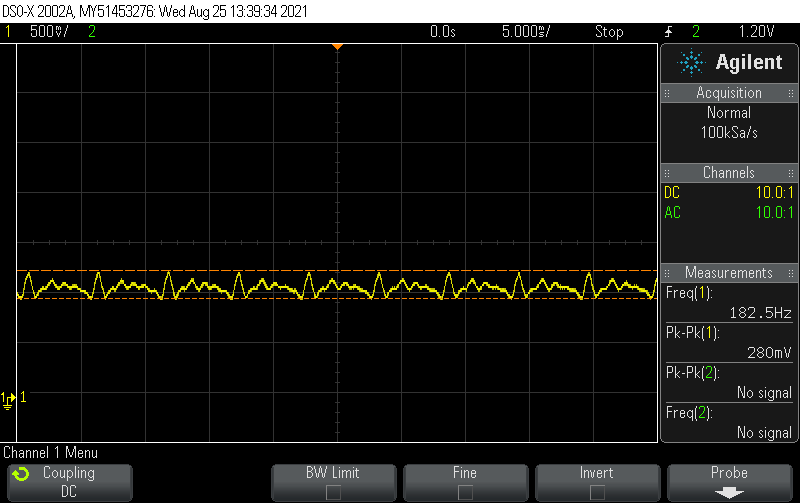

When speaking directly to the mic and recording the voice, recorded sound was clear and waveform had no clipping.
Since peak-to-peak signal of 280 mV does not clip the phone input, the output signal of the preamp circuit should be at this level as well. I then try to capture the voltage level of heartbeat signal and found that it is 40 mVpp.
In order to not exceed 280 mV, the gain of preamp circuit has to be less than 7. As the second stage has 1.6 gain, the first stage needs to be less than 4.38. I will need to adjust 1M pot to 158k if my calculation is right.

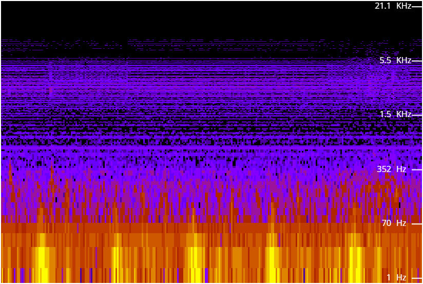

Here is recording and its spectrum. I think high intensity at low frequency corresponds well with the heartbeat.

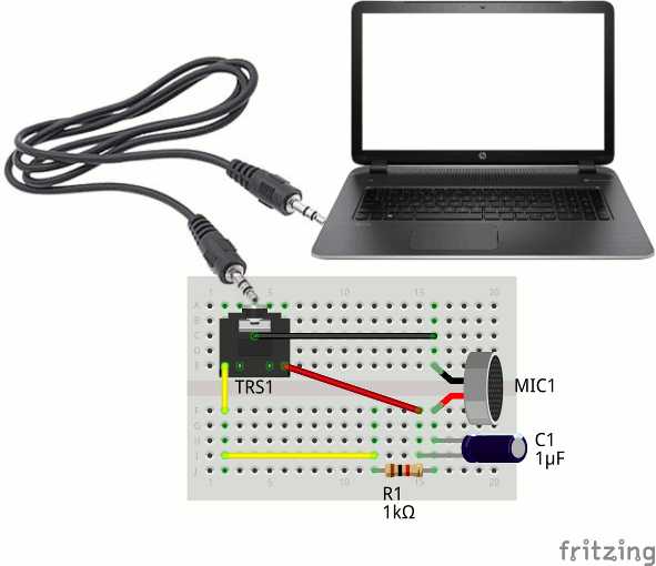

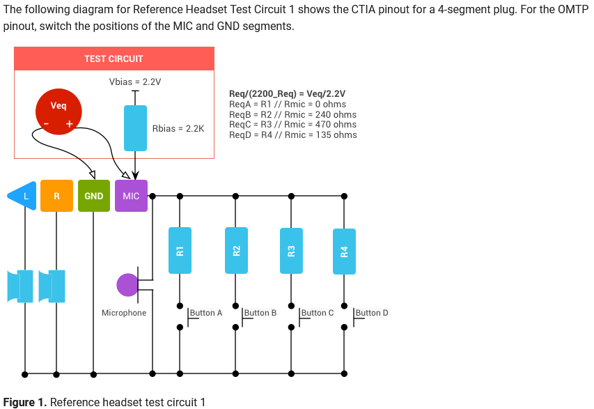

According to the android specs, 3.5 mm Headset Jack: Device Specification, Audio(mic) in is required; Headset insertion detection is required; a Mic bias voltage of 1.8V - 2.9V with Maximum output voltage drive >= 150mV on 32 ohm is required.
And the Reference headset test circuit looks like this:
The Iphone/Ipad specifications are similar.
The electret mic in headsets are expected to draw their drive voltage/current from the DC bias voltage provided on the jack. And the input circuitry is designed to respond to that level of input. and there are very specific requirements for how they respond:

My point being that driving them with a signal amplified by a 12Vdc amp will screw things up. Including possible hadware damage.
A cell phone usually uses a headset mic that has its electret mic (or Mems mic) much closer to your mouth (1-2cm) than a lavalier or handheld mic (10cm) then its output signal will be a much higher level.
All 828 electret mics spec'd on Digikey datasheets show that their output impedance is 2.2k ohms and draw 0.5mA DC max, then powering them with a 2.2k resistor cuts their signal level in half. The current of 0.5mA in the 2.2k resistor powering the mic from 2.2V drops the DC voltage at the mic to only 1.1V when many electret mics do not work or have "sensitivity reduction".
I did not know that cell phone headsets have 4 buttons which control functions with low value resistors parallel to the mic.
The test condition EN50332-2 of 150mV maximum drive on a 32 ohms headphone is to avoid hearing damage, the 150mV is not from a microphone.

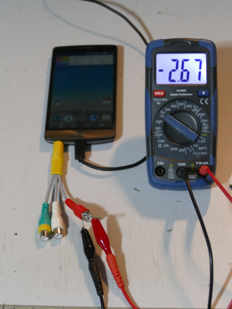

No, the 1.8V-2.9V @ ~<150mA is the DC bias voltage supplied by the phone that is intended to be used to drive the microphone. The 3 android phones I have available to meprovide 2.77V, 2.67V, and 2.9V
Here's one of them. (The red plug is right speaker output; but the same voltage appears on the green/yellow left speaker and the white mic in plugs)
An electret -- regardless of whether it is a stand-alone capsule, the one in a lapel mic, or the one in a headset -- can be driven directly from the trs connector without batteries using a simple circuit like this:
The same thing can be done with a trrs connector, with the power taken from either of the stero output connections.
I'm not saying that this is adequate for this stethoscope application as is, but it is easy to see that an amplifier that is also driven from this could be more than enough.
I don't have an iDevice to demonstrate with, but the same is true for them. Even my old feature phone provides 1.9V.

I did in my first post using WIFI for video call and also recently recording in the post #147.
You can listen to the recording here. The heartbeat was distinguishable corresponding well with its spectrum. Of course, high pitch noise almost swamp it. Don't know where the high frequency noise is coming from as all cables are all shielded.

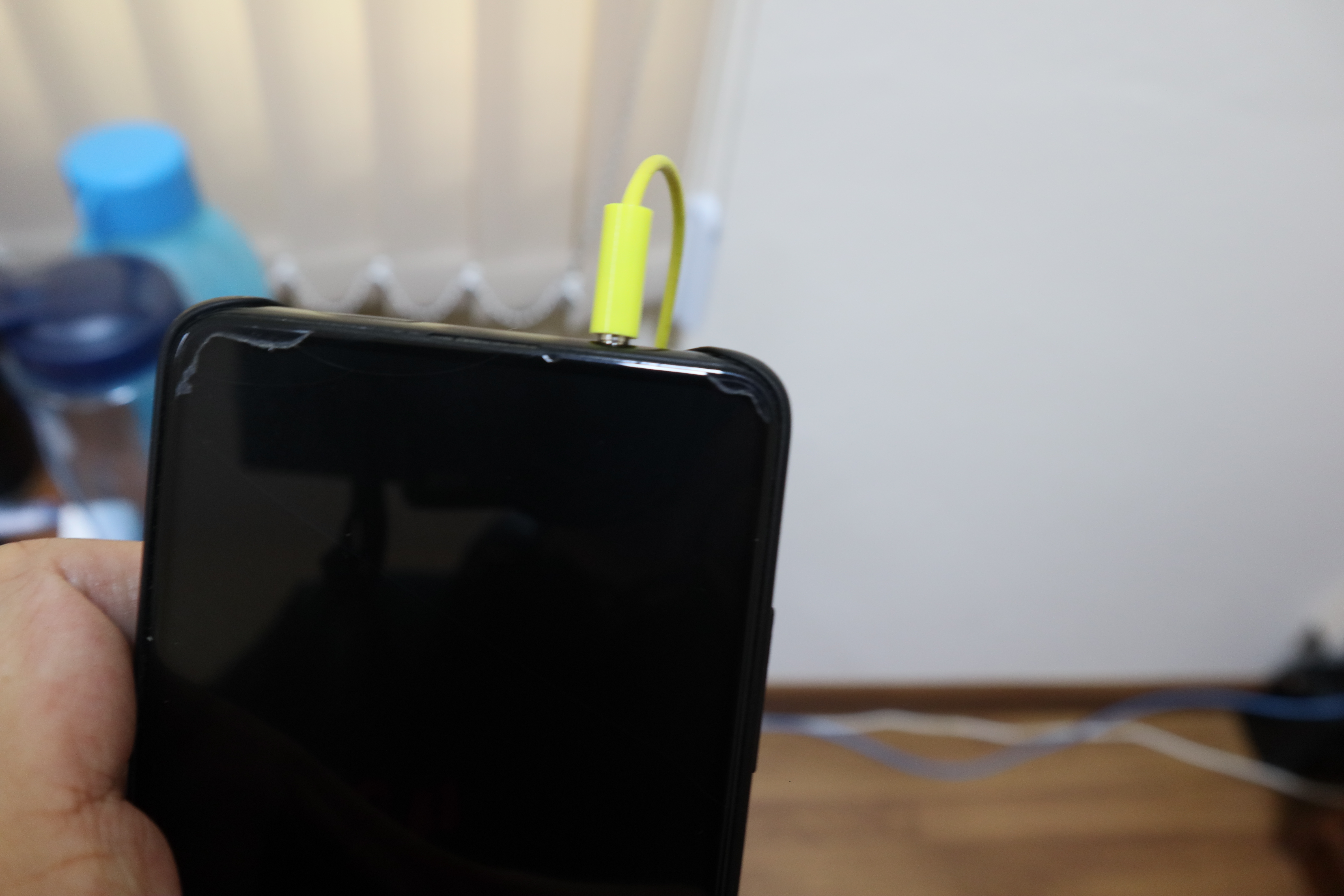

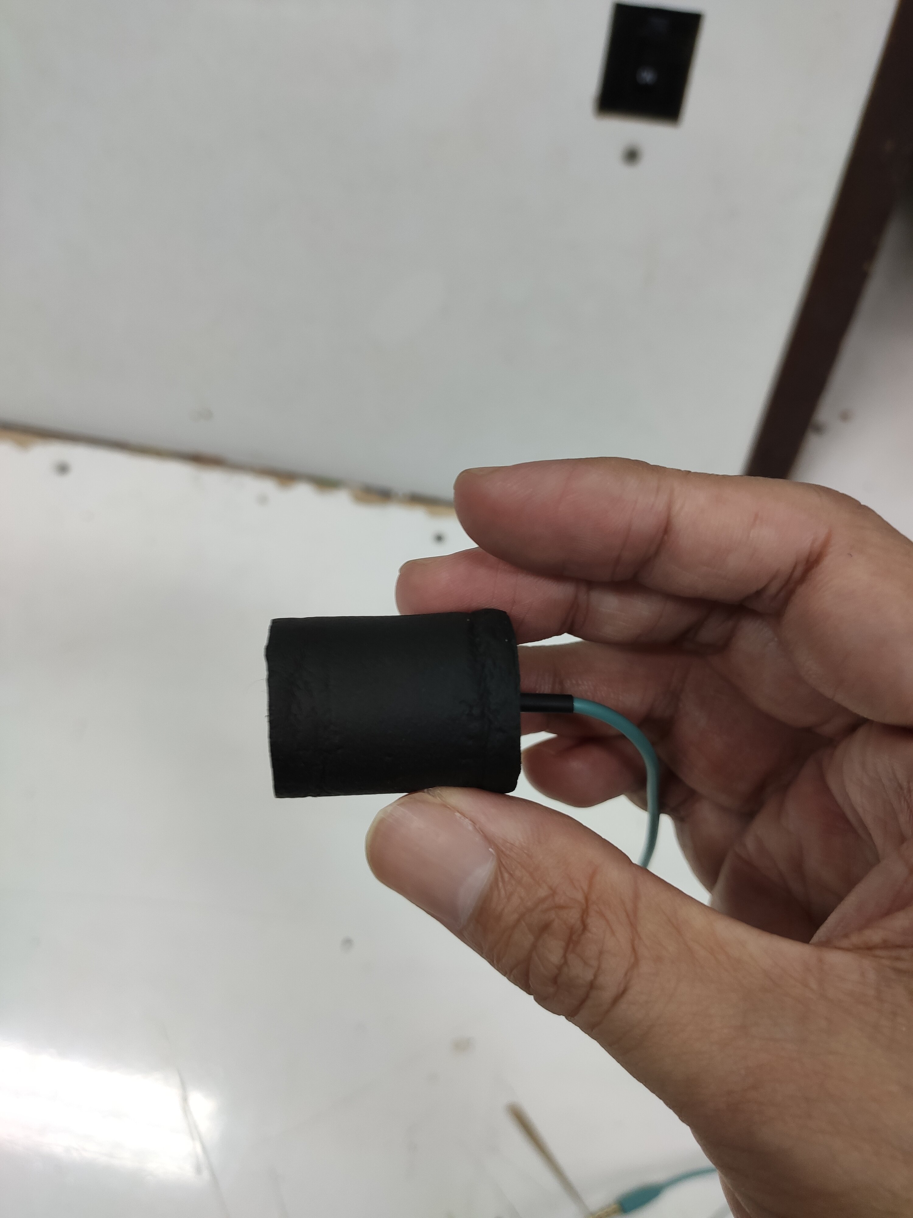

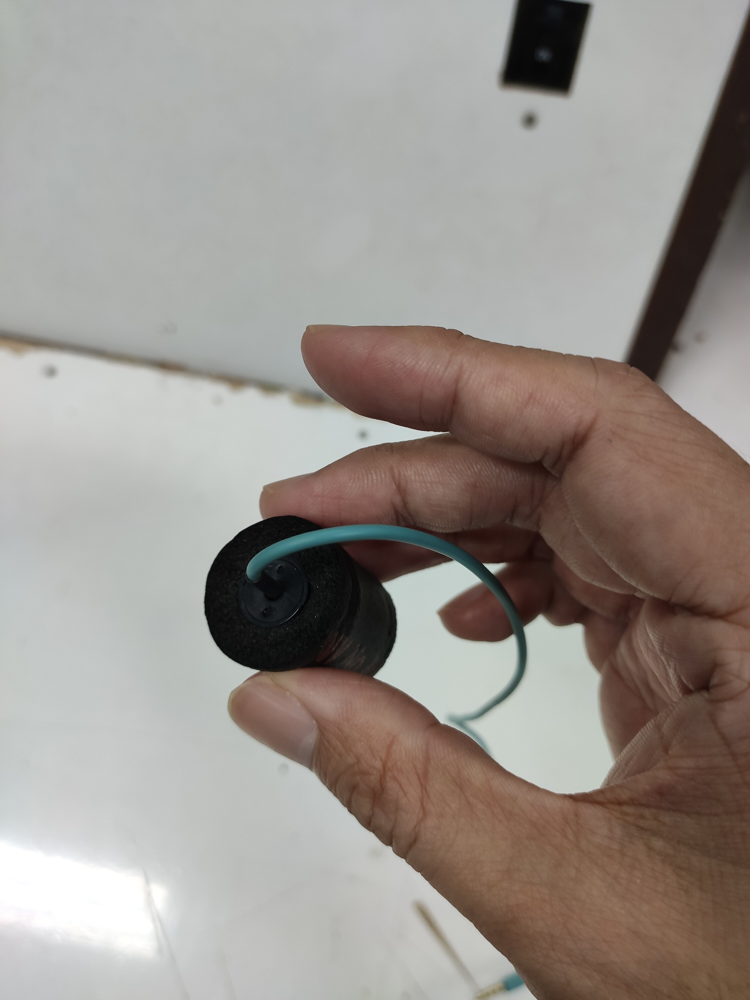

I had finished soldering electret mic to shielded audio cable and put it in heat insulation. At the other end, rubber feet is inserted to prevent the air coming in. Thinking of using hot glue on rubber as well to be sure it is airtight.
IMG_20210825_160341.jpgIMG_20210825_160745.jpgIMG_20210825_160801.jpgIMG_20210825_160804.jpg
DIY steth head with new hard plastic.

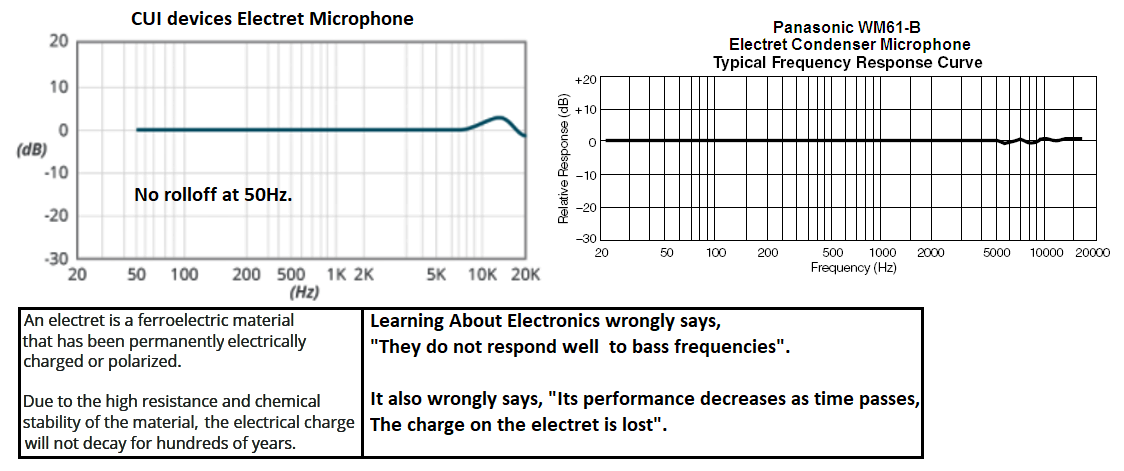

The Jfet inside an electret mic is an impedance converter with an input resistor to ground that is 1G ohms. Operating at about 0.4mA (0.5mA max) and with a low value drain resistor is voltage gain is not high. Its output level is about the same as a dynamic mic (coil and magnet). A preamp is still needed.
"Learning about electronics" says some wrong things about electret mics:
