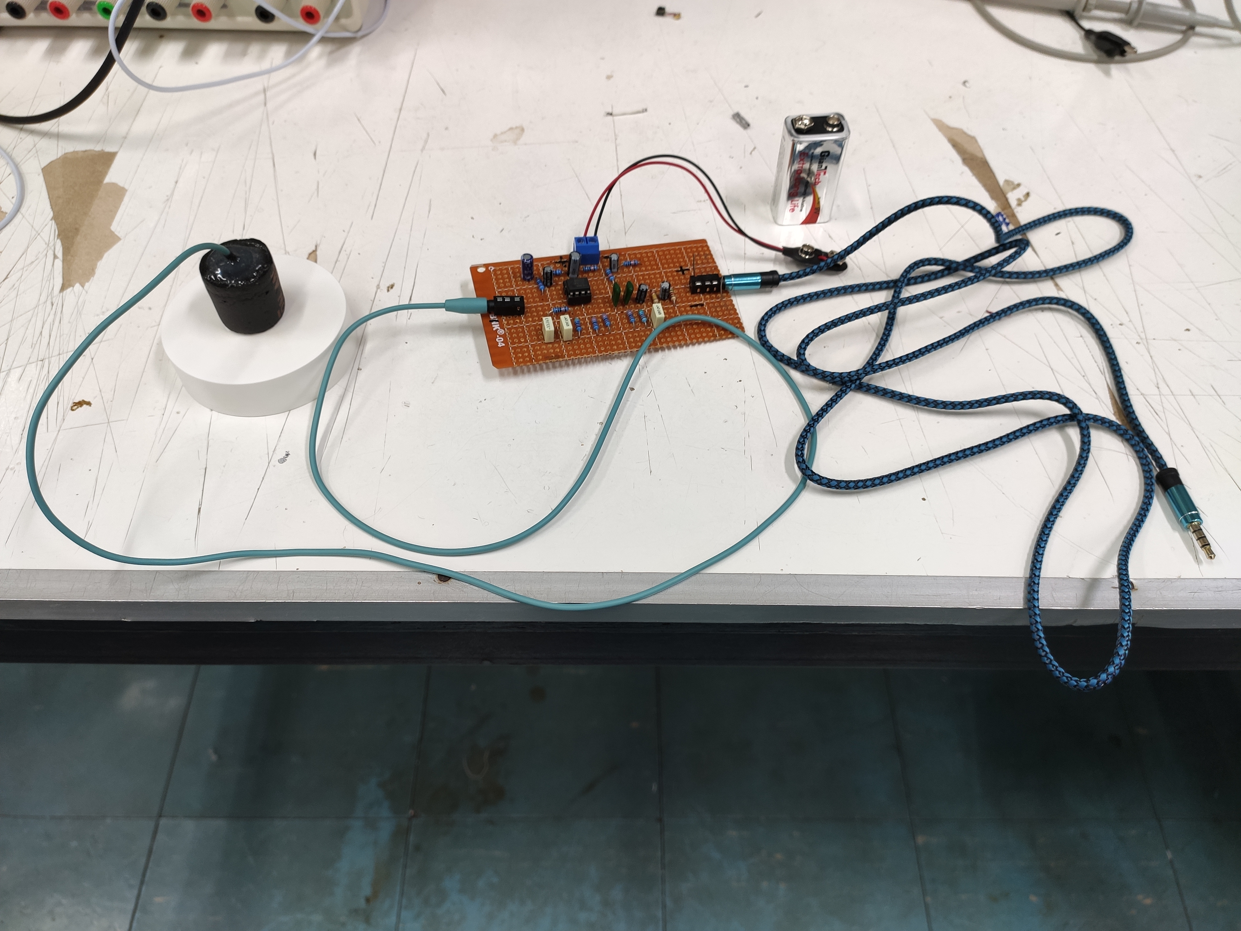

I modified the circuit by putting trrs sockets and changed R7 from 1M to 100k. The gain of the preamp circuit gain is then 5.

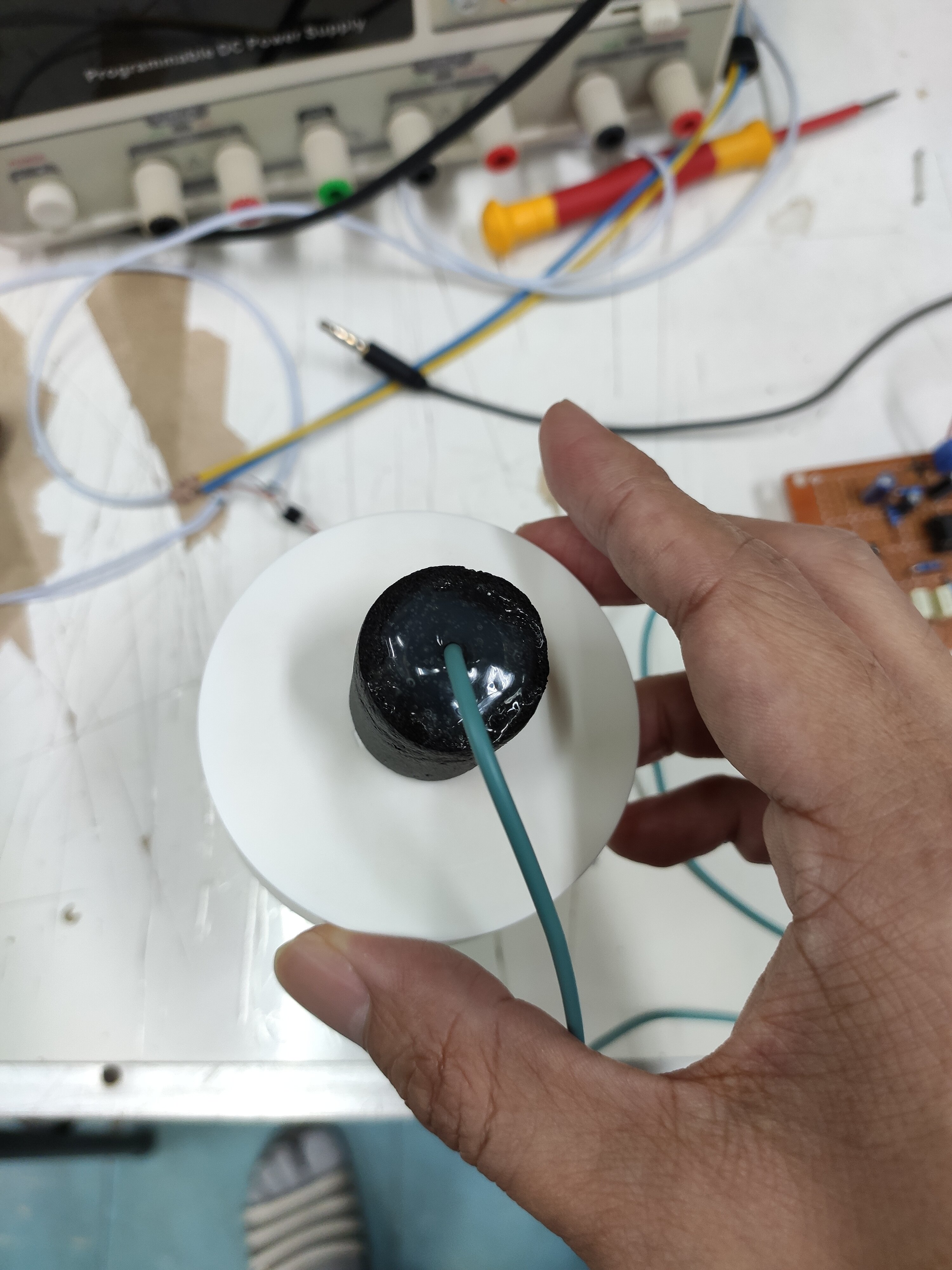

Below are DIY steth head with hot glue applied and test setup for video recording. Note that all audio cables were used.
Here is the recording of the heartbeat and its spectrum.

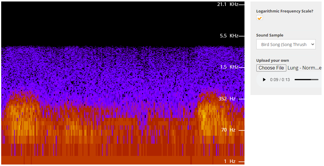

This is the recording of the breathing and its spectrum.
My friend said she can clearly hear the heart and lung sound from both recording. However, I still think the breathing sound is not really clear to me and I can barely hear it.
If I compare the spectrum of lung recording with that of very good one I found online, the differences are clearly seen T__T.

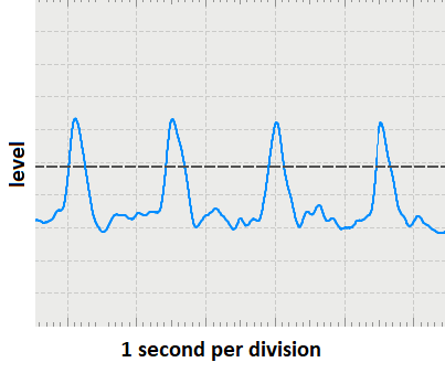

Before this thread, I have never seen your colored streaks spektrum. I always viewed waveforms like this:

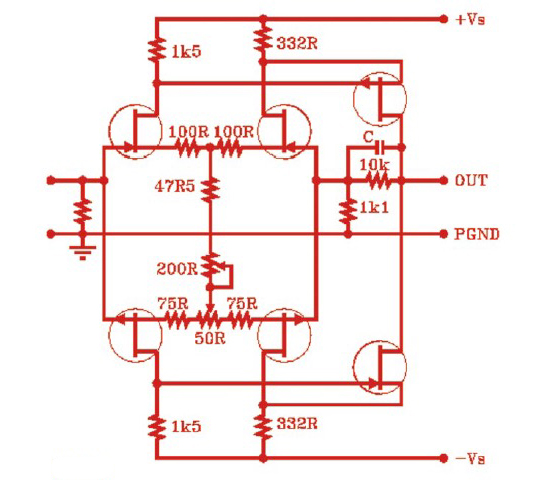

The topology of the FET circuit posted above reminds me of some John Linsley-Hood preamp designs? Look at the left half of this, for example; not identical but a similar balanced concept, with exceptionally good characteristics.

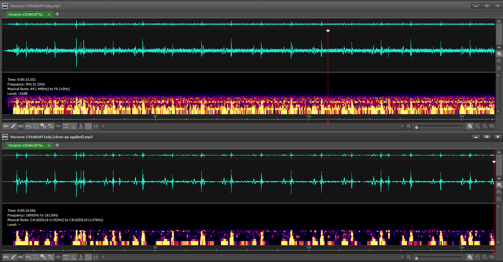

Here are the recordings of heart and lung sound
They aren't bad at all.
The heart sounds can be greatly improved with a little noise reduction: Your heartbeat recording with some cleanup and a little amplification applied, but you'd need to ask your doctor freind if anything important is missing from this version.
A visual comparison between your original and the modified version:
As you can see by the contrast between the TFFT spectral analysies, the noise is wildly distributed throughout the spectrum, so it is not easily removed with any of the normal filter circuits -- low/high/bandpass or notch.
There is a kind of filter called a noise gate, that suppresses sounds below an given volume. Ie. anything below -30db is squashed completely; but I do not know how easy this is to do in hardware; or even if that is possible at all?
I'll have a go at doing something similar for the breath sounds, but I think that may be harder to get good results.

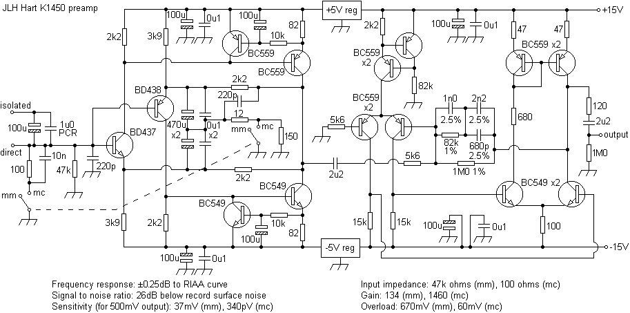

Easily done in hardware, it's fairly simple - and of course that's how it was always done in the past.
The classic example was for recording drums - by using noise gates on the drum mikes you can reduce the various spurious noises you get from drum kits, giving a nice solid drum sound - it really improves the drums.
This is an example of a more complicated commercial one:
The circuit came from here: https://audioxpress.com/article/EB-604-410-All-JFET-Line-Amp-Starter-Kit, and teh name on it is different, but who knows how much influence your guy had on this one.

Like most people on these forums, I use the free LTspice program to see waveforms or a frequency sweep on my pc.
That looks very complicated. How much of that is dedicated to the variable decay time?
VR2..
The bistable at the bottom is an electronic on-off switch, so the bottom third could be removed it you wanted it always on; everything across to Q9 and teh 4k7 resistor. Leave the 1uF cap in circuit.
Here's a simpler noise gate schematic, which is nice and easy to understand:

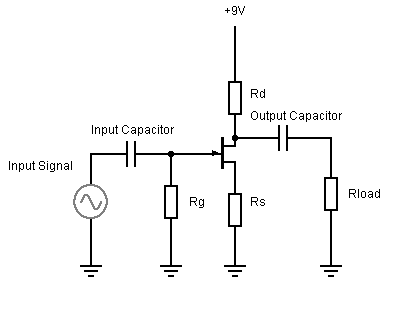

Part of the problem is that these circuits are for stereo (speaker) output levels; I'm looking for mono input mic levels.
My (quite likely half-arsed) notion is that a j-fet has a Vgs(off) value. So in a simple preamp circuit like this:
If Rs was an 'electronically variable resistor' -- several ways of achieving this I believe -- then a 'detection circuit' measuring the voltage across Rg, could vary the value of Rs so that when the value across Rs was below some (adjustable) threshold, Vgs moved below Vgs(off) effectively suppressing output until the voltage across Rg rises back above the threshold. And (maybe) the afore mentioned 'detection circuit' could be as simple as a diode with a correctly chosen cutoff value feeding the gate of a second jfet in place of -- or series with -- Rs?
