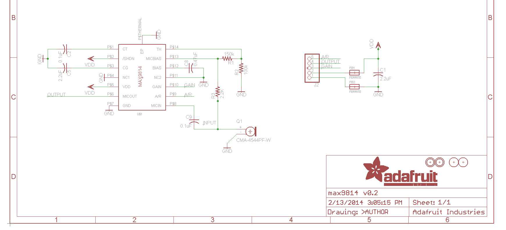

It would be a pain for me to insert anything in series given the tiny parts on the module. My concern here is not the implementation of the attenuation so much as why the simulation doesn't agree with measurement. Here, I also add the module schematic and mic data for reference.

LTspice assumes that the microphone has a very low output impedance but it is actually about 3.3k ohms in parallel with your 2.2k resistor that powers it.
I measured my electret mic as being 3.3k ohms when powered from 9V through a 10k ohms resistor (total of 2.5k ohms) which is different from what you have.
Hey, AG. If I put 3.3K in parallel with the 2.2K, that gets me about 5 dB greater difference between sim and measured. I guess if there is anything that explains the difference, as far as the sim goes, it's the constant current source used to simulate the microphone. The rest of the sim circuit is pretty certain. No matter how I do it though, my understanding is the JFET in the mic is operated in the saturation (Idss) region, ie, constant current region. I guess somehow, in reality, the attenuator (cap in series with resistor) is lowering that current significantly (it is not so constant), but I don't understand why.
You are operating the electret mic below its recommended voltage. The datasheet says the output level drops -3dB when Vs is too low at 2V from when its is at the minimum Vs of 3V. An electret mic with such a low supply voltage produces severe distortion at sound levels that are not very high. Adding 3.3k parallel with the 2.2k that powers your mic increases its DC voltage and therefore also increases its output level above what you and the Sim program think.
Since I measured 3.3k ohms for my electret mic and measured 2.5k ohms when powered with a 10k resistor from 9V then the mic is not a constant current source that has an extremely high impedance.
Look at a datasheet for a Jfet to see that its Idss is listed only when Vds is 15V, not at a lower voltage. Measure the mic, don't let the Sim program guess it.
Man, I agree with your "measure the mic" statement, AG. I originally sim'ed the value for the resistor and used that in the circuit and the output went almost completely into the dumpster, prompting this adventure in the first place. You're right, at 2V the mic gain is starting to crap out. Anything below that, suggests it is operating in the "linear" region of the JFET, which is not a good thing.

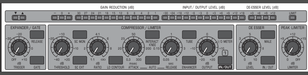

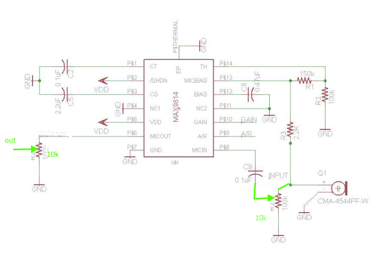

Ideas from compressors and limiters I use. You probably don't need this but you can use a 1k to 10k pot on the output.
I think you can add a 10k to 100k pot on the input to limit the sound from the mic. That is more like what you want. (I hope)
I have racks full of compressor/limiters.
This one does not really have a "input lever" but "Threshold" is that function. If the knob is set at -20 then anything below that value is not effected. Above is effected.
"Ratio" sets the slope of compression. 1:1=no compression. "00" is very flat.
Attack and release sets how fast the machine responds.
"Output".
The "peak limiter" is very fast and only responds to really loud that will over drive the next amp.
"Expander/Gate" is used to kill the volume if no sound. I use this for plays where I might have 20 mics and most are not is use but night be soon.
I think if you had the meter that this machine has it would be easy to set up.
That's impressive, Ron. Yeah, a lot of expensive things would make my life easier. :) But seriously, thanks for your idea with the pots. I would have to do something like that for building more of these.
