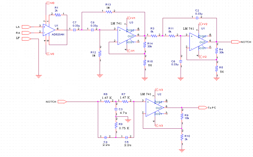

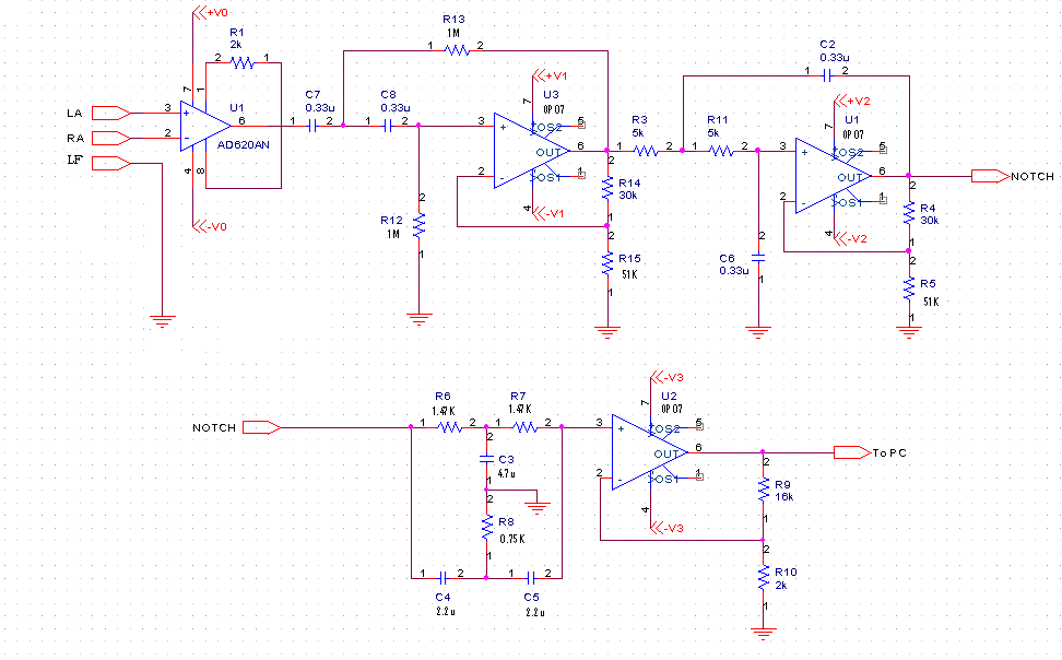

here is the final circuit..check it please and if you see something unproper tell me
The new droopy passive lowpass filter is not a sharp active Butterworth Sallen and Key type.
Your schematic has a grey background, is covered with dots, has big spaces which makes it huge and was saved as a very fuzzy JPG file type.

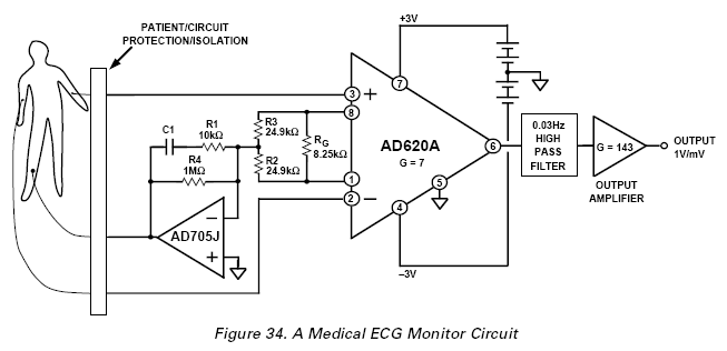

The common-mode signal (DC and mains pickup by the body) from the instrumentation amp is filtered and inverted then fed to the patient's right leg to cancel the common-mode signals.
so how i can make the common-mode cancellation opamp?
It was posted before. It takes the common-mode DC and low frequency AC from the instrumentation amp and feeds the patient's right leg like opamps A1 and A2 in this ECG circuit taken from the datasheet of an instrumentation amp:

Yesterday I posted an ECG circuit that shows an opamp making the common-mode cancellation signal. The circuit was posted twice in this thread.
Today I copied the ECG circuit from that datasheet of the AD620 intrumentation amp that you are using. It is here:
Don't you look at the datasheets of parts that you use?????

As you have already been told, your simple circuit is missing the common-mode cancellation circuit that feeds the right leg of the patient instead of your ground wire.
The datasheet for the AD620 instrumentation amp shows it in their recommended ECG circuit.

Simply look at the spec's of the AD705J opamp in its datasheet and find another similar opamp:
1) It has an extremely low input offset voltage and input offset current.
2) It has very low input current and a very high input impedance.
It is simple to make a highpass filter with a frequency of 0.03Hz.
It is simple to make an amplifier with a gain of 143.
