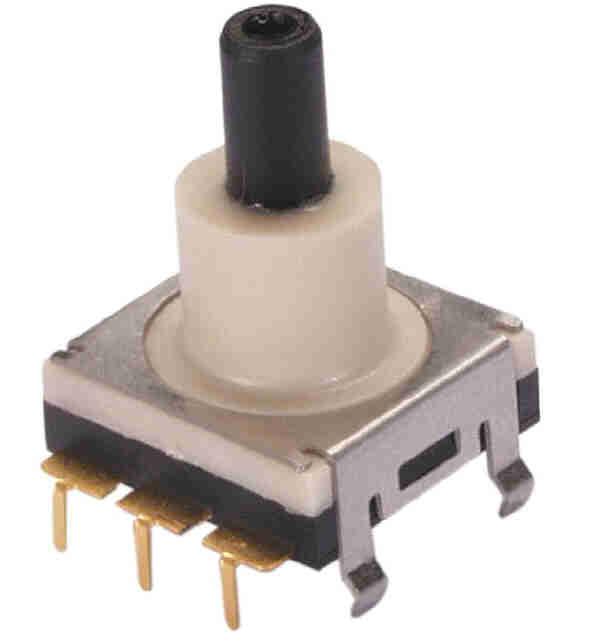

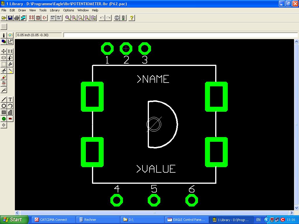

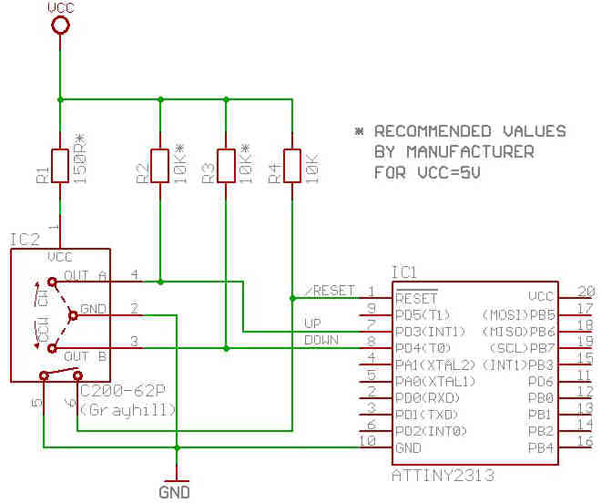

Optical encoder (rotary) Greyhill 62P
here is a part you might probably find useful for automotive and consumer electronic applications.
The Greyhill 62P series optical encoder does not require switch debouncing. Its bounce times are given 4/10ms for make and break. Its reliabily is given as 2 mio cycles. It also features a low power pushbutton type switch capable of 5DC/10mA resistive load.
I made an Eagle component and interested members will get the library on request via email.
Attached are a sample schematic using the encoder for up/down control and to disable the MCU via the /RESET pin.
Applying the encoder I recommend not to alter the resistor values recommended by Greyhill.

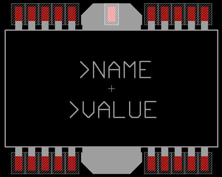

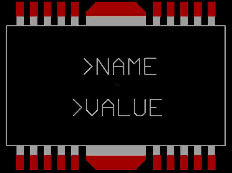

this is neither a hint nor a trick.
There is a package manufactured by TOSHIBA with the package name HSOP20-P-450-1.00
You'll not find it in any Eagle version.
Here it is.
Pins are numbered the normal way. The two fins have no internal connection, but are cooling fins to be soldered onto the PCB.
The do have SMD-pads burried inside the fins. Their names are: bottom 'G1' and top 'G2'.
Here is a screen shot of the device (used for the TA7259P) and zip file containing the package.
Regards to all
Oops. I forgot to make a solder stop pattern around the fins. Will be done instantly.

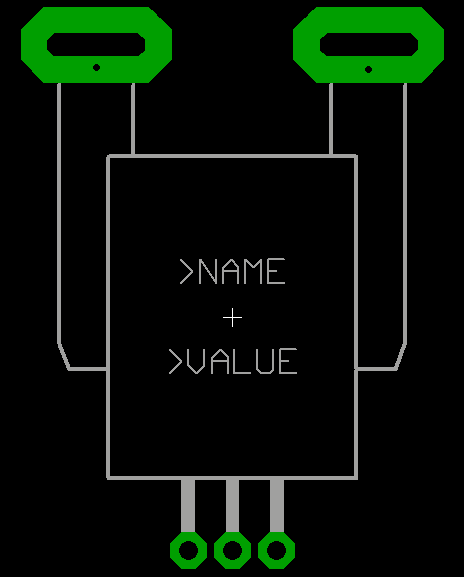

Current measurement with minumum losses.
I stumbled over an Allegromicro device these days which I guess is worth to consider for applications measuring AC/DC currents up to 200A.
The device name is ACS758KCB manufactured for ±50A, 100A, 150A and 200A.
It is isolated from the high power side and provides a linear output voltage according to primary current flow for logic devices such as microcontrollers (3.3 to 5V VCC).
The internal resistance of the Hall sensor is given to be 100µΩ.
I guess this device will solve many high current measurment problems encountered so far.
Here is an image of the package (shaped).
Note two small pads burried in the longitudinal big pads, which are traces in reality. Using longitudinal pads Eagle does not allow to change drill size for the desired shape. (The fins leading to the current sensor are 4mm wide.)
Attached is the ACS758KCB datasheet as well.
