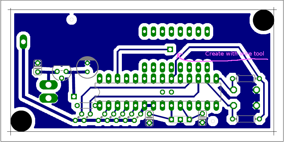

Extending the VSS polygon
To make my boards easier to solder I like to use a large isolate value for the VSS polygon. But this can prevent the VSS polygon (aka fill) from getting into some areas.
You can use the WIRE tool to extend the VSS fill through the too-narrow opening and into the region you want filled. Use the NAME tool to change the new wire's name to VSS. Hit RATSNEST and area should fill.
superprobe5_bottom_cheat-png.21204
The pink arrow in the above image points to a wire that causes the area to the left of the arrow to fill.
