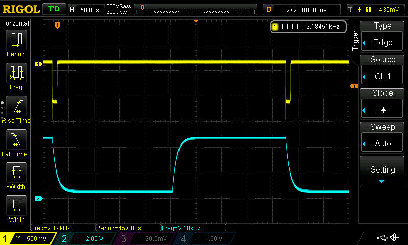

I need to detect a duty cycle going past a certain threshold. Here is a picture of the duty cycle in yellow; as this decreases from the current approx. 95% to say 50% (adjustable), it needs to trigger an output (TTL level). Preferably with some upper threshold too.
What is the best way to approach this?
Edit: the amplitude of the signal to be detected is constant amplitude TTL level (so, yellow trace at TTL level).
I would like to be able to set the on-trigger at about 50% with +/-5% accuracy, and the off- trigger at about 30% with same accuracy.
Edit: the frequency remains fixed at about 2kHz; amplitudes always are TTL level.

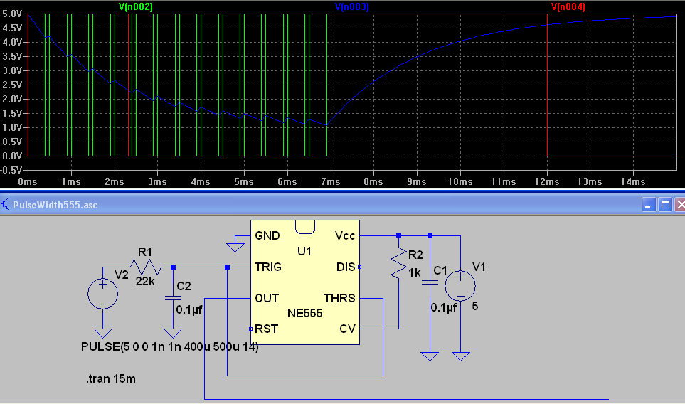

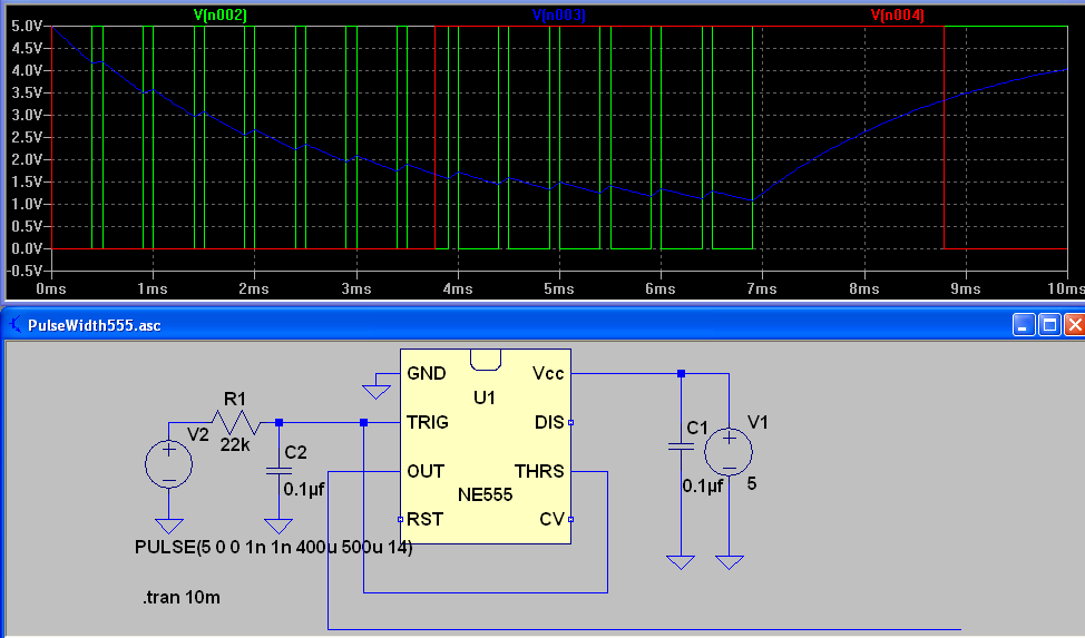

Input is the green trace. (V2) To the left it was 100%. Then went to a low % and then after 14 cycles went back to 100%.
The blue trace is after the RC. It averages the 0V and 5V to get a level.
Output is in red.
Right now it is set to trip at 33% and 66%. That can be changed.
Not right but something to think about.

And what components on the 555 are "in charge" of the 33% and 66% triggers?

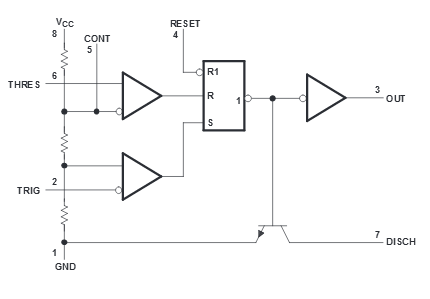

I tied 2 and 6 together and injected the RC signal there.
The 1/3 and 2/3 voltage points are set by the three resistors from 8 to 1. I don't remember but I think the resistors are 10k. ????
Connect a 1k from 8 to 5 and the "TRIG" voltage will be just below 50% and "THERS" will be about 95%.
***I need to look at the data sheet to see if the inputs will work that close to VCC.***
Another option is to add some resistors to 6 and some to 2 to shift the voltage up or down.
Put the CMOS gate/buffer just ahead of the RC. So the TTL signal probably is 0V and 4V the CMOS buffer 0V/5V.
Hi Ronsimpson, what are "2 and 6", and "from 8 to 1" and "from 8 to 5"?
I just downloaded Splice, I wonder why I have not used that before :cool:
Edit: oh I see, are these the 555 pins?
It appears the "top" input THRES will work to VCC. The bottom input TRIG will work all the way down to GND.
I do not like this circuit but I took up the challenge.

Next I did a analog design that is just like a 555 with out the three resistors. Two pots sets the two voltage levels. If I could get at the three resistors and force the levels to 50% and x% with a POT or two, then I would feel better.

Just for fun I added a 1K from pin5 to pin8. Switches at 92% and 46%.
Maybe the resistor should be closer to 820 or 750.
