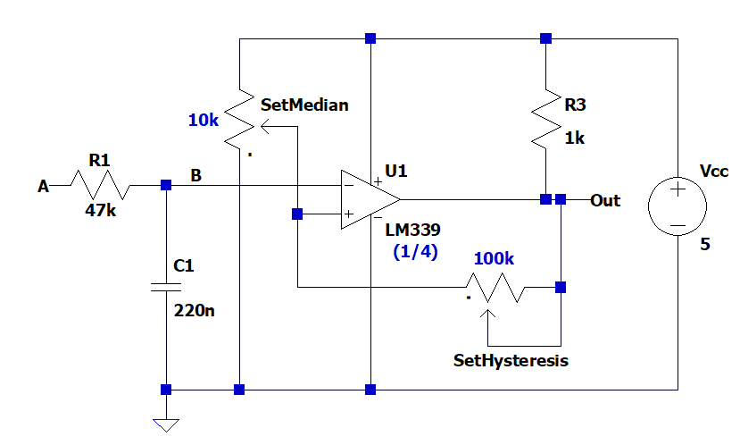

Here's a duty cycle threshold detector using a comparator, with one pot to set the median of two reference levels and another pot to set the hysteresis between those levels.
Thank you alec_t. I guess R1 and C1 are the low pass filter components?

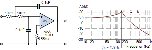

I had been thinking of using a 2nd order active LP filter: would there be merit in this case?

Well, maybe my simulation is wrong? Anyway, what I saw was that the output would not trigger unless the duty cycle dropped to less then 50%. And I need detection at less than 80% . So whatever gives me a signal when the duty cycle drops below 80% is fine for me.

Can't see the need for an active filter for such a non-critical task.

The sim I posted (#26) assumes input logic levels of 0.5V and 4V @ 2kHz and lets you set almost any % thresholds you like by varying the pot wiper positions. If hysteresis isn't great enough then reduce the value of the hysteresis pot from 100k to, say, 50k or less.
Edit: With Median and Hysteresis wipers at 0.6 and 0.2 respectively, my sim gives duty cycle switching points at 80% and 60%.

If a 555 cannot do what I need, is it safe to assume that alec_t's proposal suits the bill?
Hi Alec_t, I tried to import your drawing in LTspice but it cannot find the LM339: how do I import that and from where?
