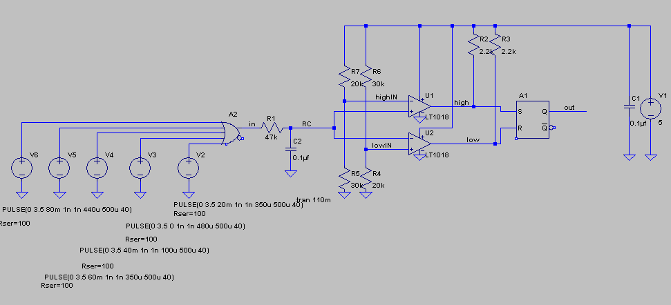

I don't understand (even assuming '55V' is meant to be 5V). If you low-pass filter (R1C1) a TTL rectangular-wave signal the result should be a voltage varying from about 0V to 5V (I used the range 0.5V to 4V, allowing for circuit losses) as the duty cycle varies from 0% to 100%.

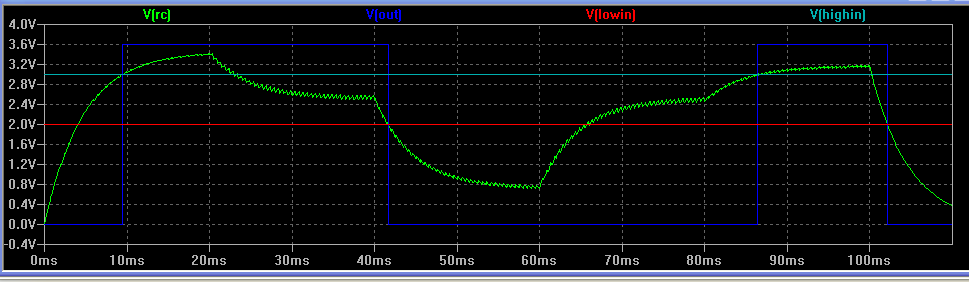

Red at 2V and green at 3V are the voltage levels to compare. (could be set by a POT)
Green Vrc is the filtered digital signal. 0% at time 0, then high %, middle %, low %, middle %, high %, 0%.
Vout in blue is the output. Set high if high % and set low if % is low. Will hold id % is in the middle.
V2 through V6 makes the signal. A2 ORs then together. A2 pulls down to 0V and up to 3.6V like a TTL gate.
Nodes highIN and lowIN can be made by POTs.
RonS

The actual duty cycle does not go lower than about 45% (the actual circuit producing this duty cycle is still in test phase too, I might get it too go lower in the future). I use an inverting buffer (currently 1x NAND gate from CD4093), but if needed that can be made non-inverting. When the duty cycle is 100%, then the inverter output is 0V, LP filter too. At the lowest duty cycle (currently about 45%) I measure 2.96V after the LP filter at pin 2 of the LM339.
RonS
You are absolutely amazing!
I will need some time to study this, thank you for taking the time for this.
Why would A2 pull up to 3.6V only?
Is there provision for hysteresis?

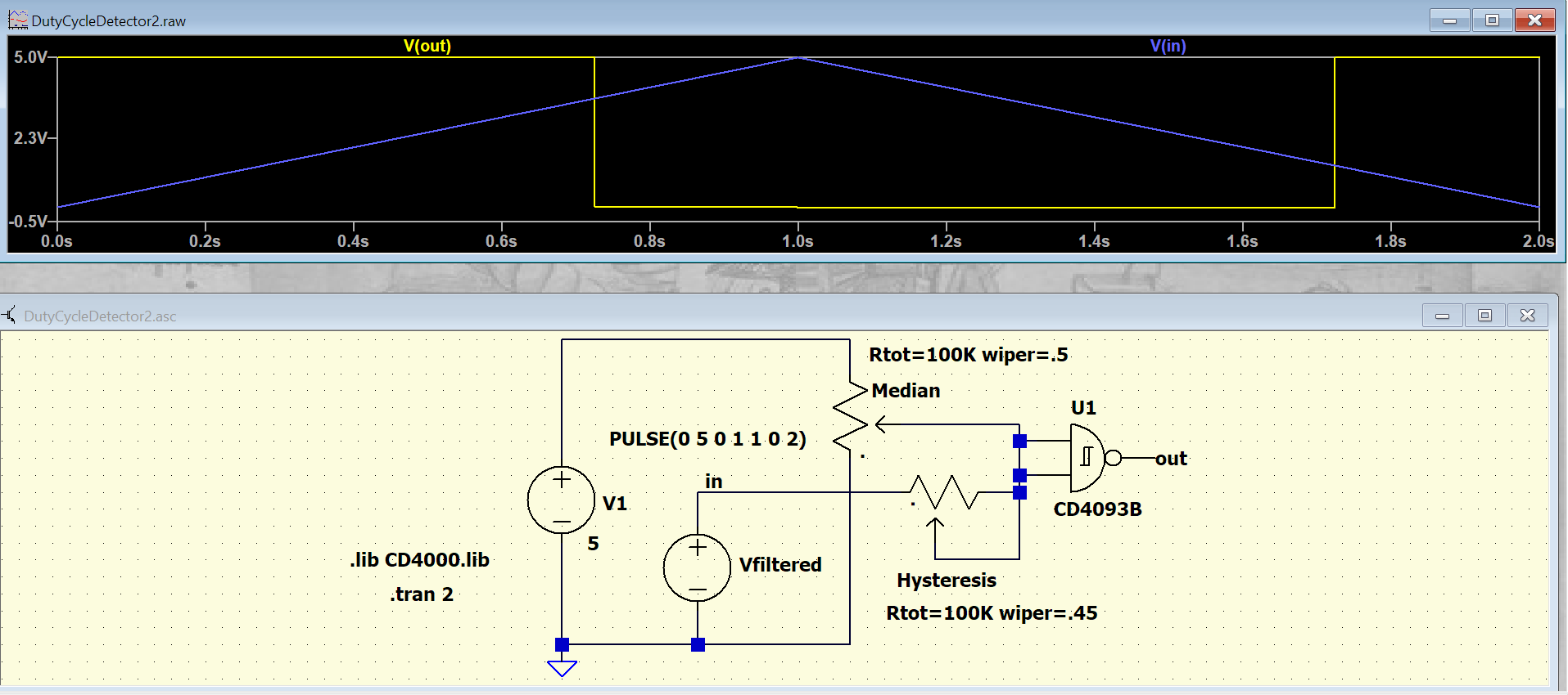

If you were thinking of using a CD4093 (or other Schmitt gate) as a buffer anyway, it would be a simple matter to use another gate in the same package to do the thresholding/comparison function too, like this :-
How much hysteresis do you actually need?

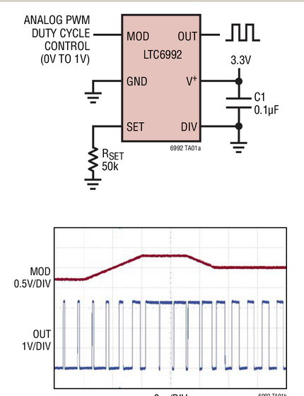

There are a number of these on the market. Set the frequency by Rset and DIV. Set the duty cycle by a 0 to 1V signal on MOD.
