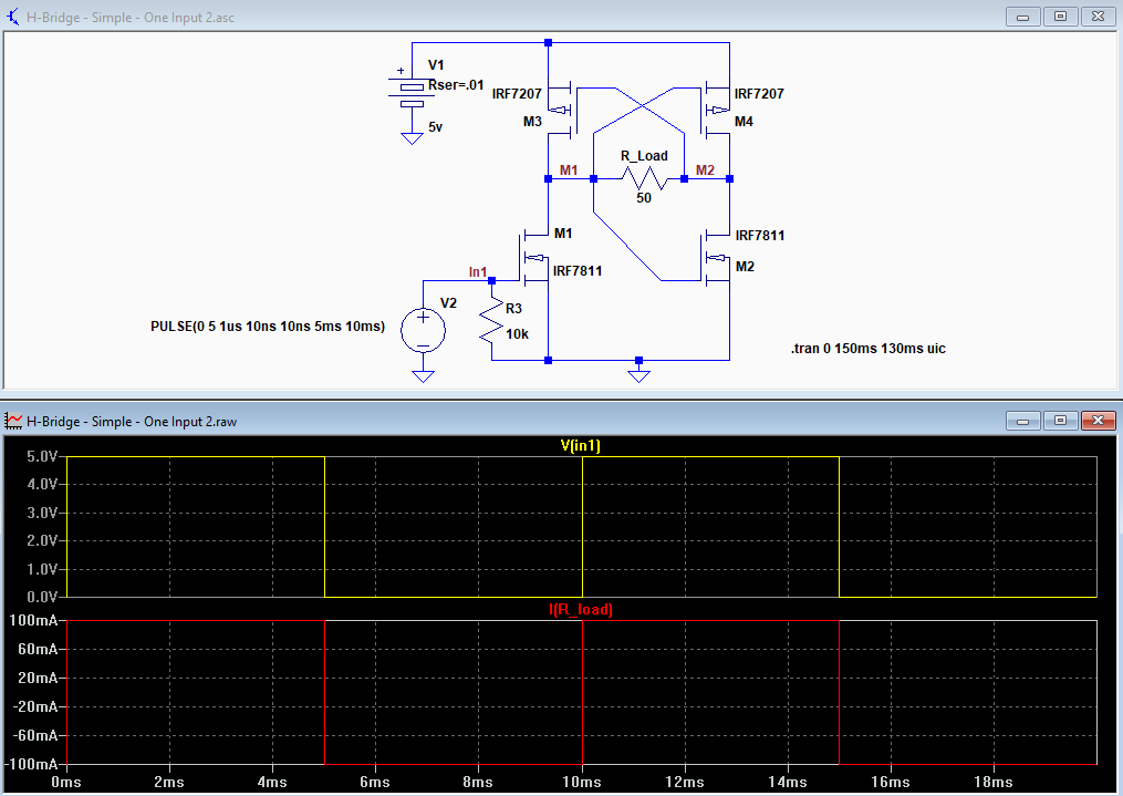

Here's a simple MOSFET H-bridge that should do what you want.
It uses P-MOSFETs on the high side to simplify the gate drive requirements.
You can use other MOSFET part types, but they must be logic-level devices with a max threshold Vgs(th) of 2V or less.

That is a very interesting circuit.

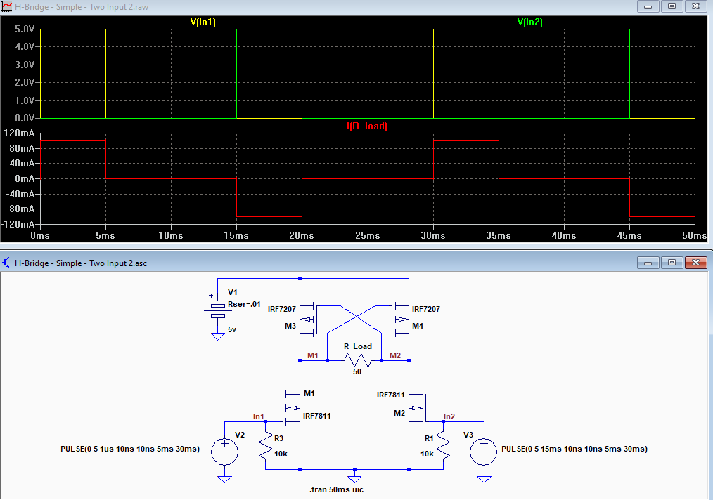

My I kindly ask you to adapt this schematic so that there is a IN1 to control cuurent going the one way, and a IN2 to control the current going the other way through the load?

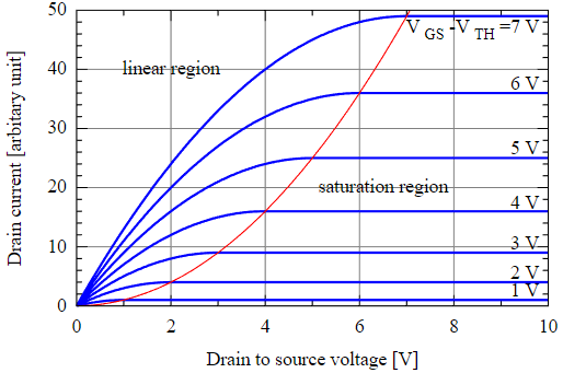

2. will the gate voltages be high enough to drive the MOSFET's in saturation?
Depends upon the voltage and the MOSFETs used.
As I previously stated, for a 5V supply and 5V gate drive, the MOSFETs need to be logic-level types, with a gate threshold voltage Vgs(th) of 2V maximum.
A pedantic note: when a MOSFET is used as a switch they are not driven into saturation (which is the active region in a BJT) but into the linear (or ohmic) region, as shown below (which is the saturation region in a BJT).
Why the solid-state physicists used the same word for a different operating state in a FET as compared to a BJT is beyond me. Guess they thought they would throw that in there just to confuse the rest of us

Hi, I try using a 555 output to change polarity on the load, with a MOSFET p-channel inverter so that IN1 is driven directly from the 555 and the IN2 is driven from the inverter. The issue I have is that the inverter has a slight delay causing both IN1 and IN2 to be on for the slightest amount of time and in effect causing a short between V1 (supply voltage) and ground.
So what would be needed is interlocking between IN1 and IN2 as there is on the regular L298P; how can this be achieved as simple as possible (frequency <200Hz)?

That is called cross-conduction or shoot-through, and is a common problem in totem pole and H-bridge circuits. Wally's timimg diagram shows a gap between when in1 changes state and when in2 does. If you cannot cause that to happen in your system, then a small asymmetrical time delay is added to the input signals so they change state in the proper sequence.
