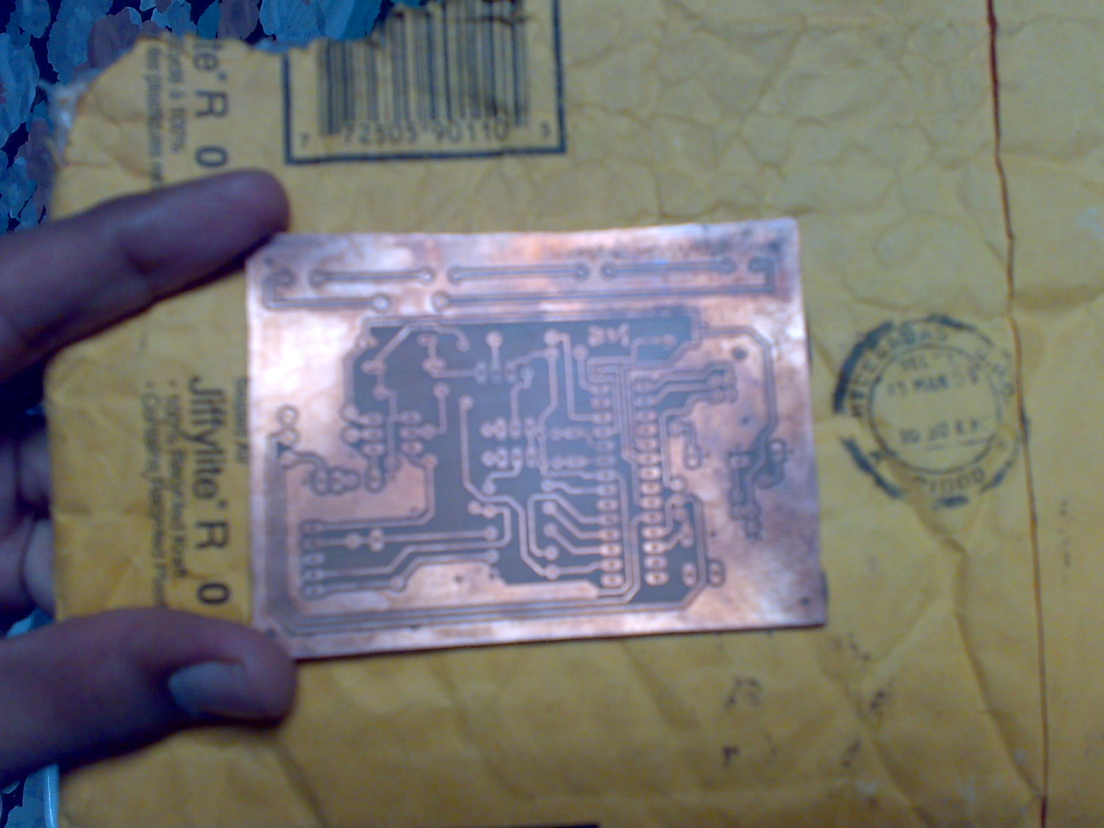

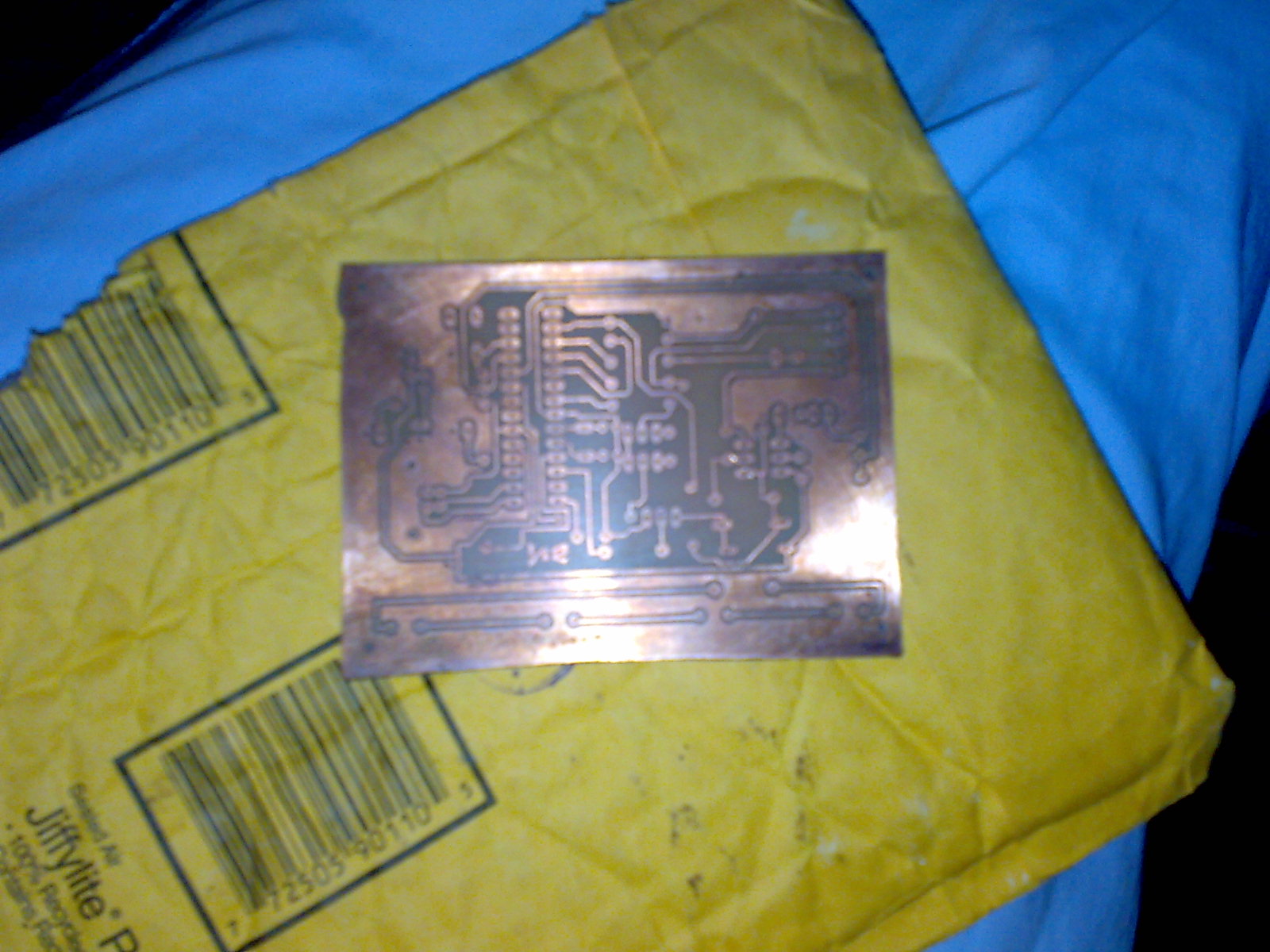

Magazine paper is the same thing as Presentation Paper they sell it at office max
it comes off easier then the photo paper.
sand paper i clean copper pipe with it 220. I'm going to get some 600 to day
etchant? I don't no what it has in it I got it at radio shack it looks like oil.
I will look for some next trip to the office depot. I use picture paper (hammermill brand) and I guess it is between what you used and photo paper, photo paper is a pain to get the coating off. Picture paper, you can use your thumbs and get it off with a small amount of work.
I tried hero999's idea "way" back but found the rags in the US are thick and thin and some crumbled up in the printer. As no one new exactly what magazine to use (different areas in the world). Though playboy I think was brought up and I had none of them.
So this looks like something to try. As for the FC, turns have I have 9 bottles of it I will never use again. I will only use the pool acid and peroxide). Much faster and less bad things to breath for me.
