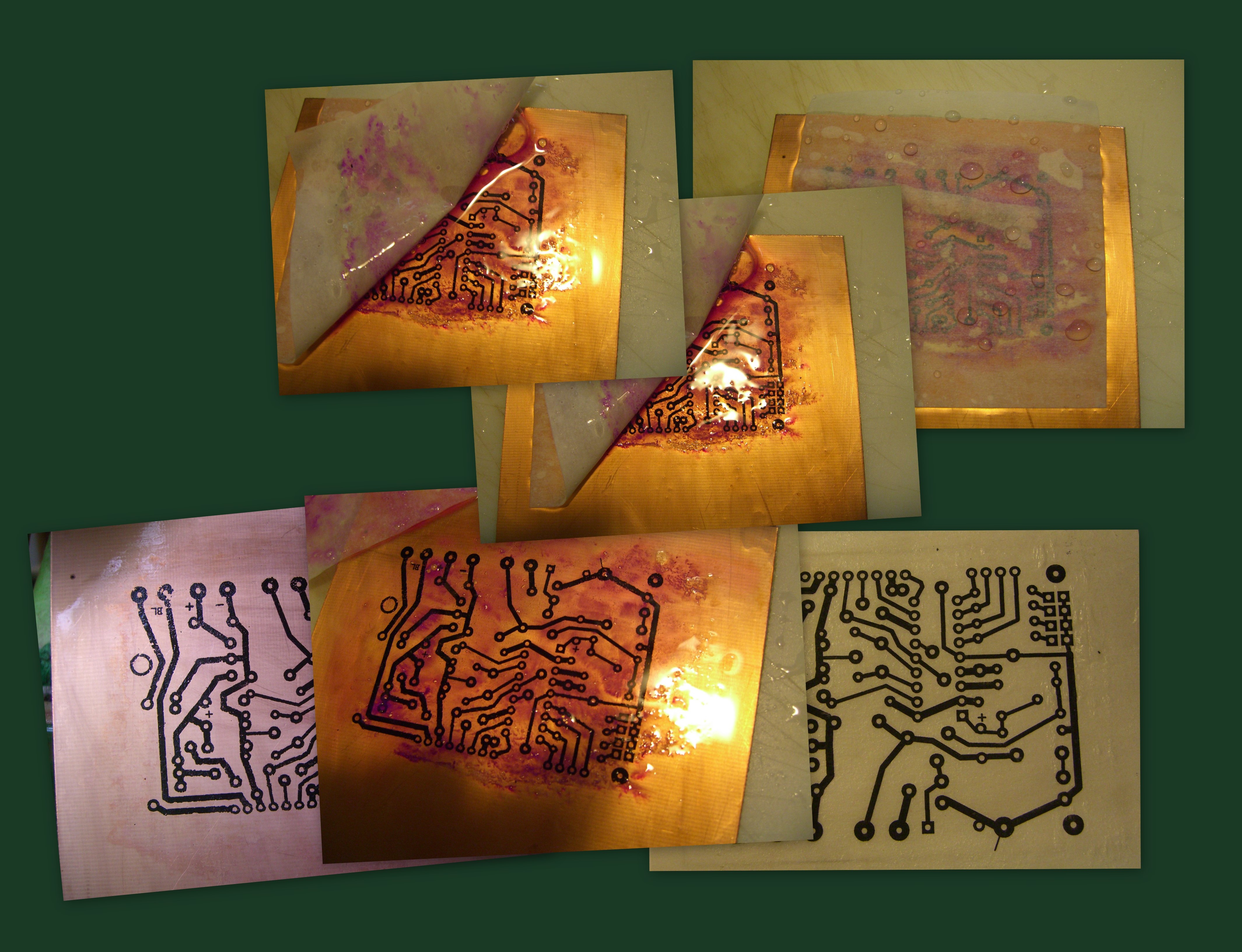

I couldn't find my wax paper, so I tried Parchment Paper, which has a silicon coating. I tried two boards. One I let cool after ironing and the paper peeled off leaving all sorts of spots. Second one I peeled off while it was still warm and it seemed to work fine, but when I went to use a marker to touch up and empty edge, I found the toner wasn't really stuck to the board well.
So Parchment Paper is a fail.
I managed to find my wax paper. I've printed off a design. I'm going to clean off the old board and try to iron it on. It goes through the printer without any issues and leaves a clean print on the wax paper.
"So Parchment Paper is a fail." (Not by a long shot!)
My wax paper Test wasn't the best I must admit.
I tried the Parchment Paper they used in a bakery and the toner coverage was miserable, I think it slid right off!
But with a coating of the Elmer's glue stick (washable) it worked great. Flatten it out with your iron before printing. Use normal transfer procedure. After about 90 seconds of soaking the paper slid right off! The glue turns purple again after getting wet, wash it off the board.

That looks pretty good. You need to start using a better test pattern, though. That test pattern has large traces. Try something with variable trace widths, large to small, down to super small, like 1 or 2 mil. Some 90 degree bends and other things that are tough to get.

I thought it looked good also, until I looked at it with a strong magnifying glass. But I don't think it pases mustard. :-(
