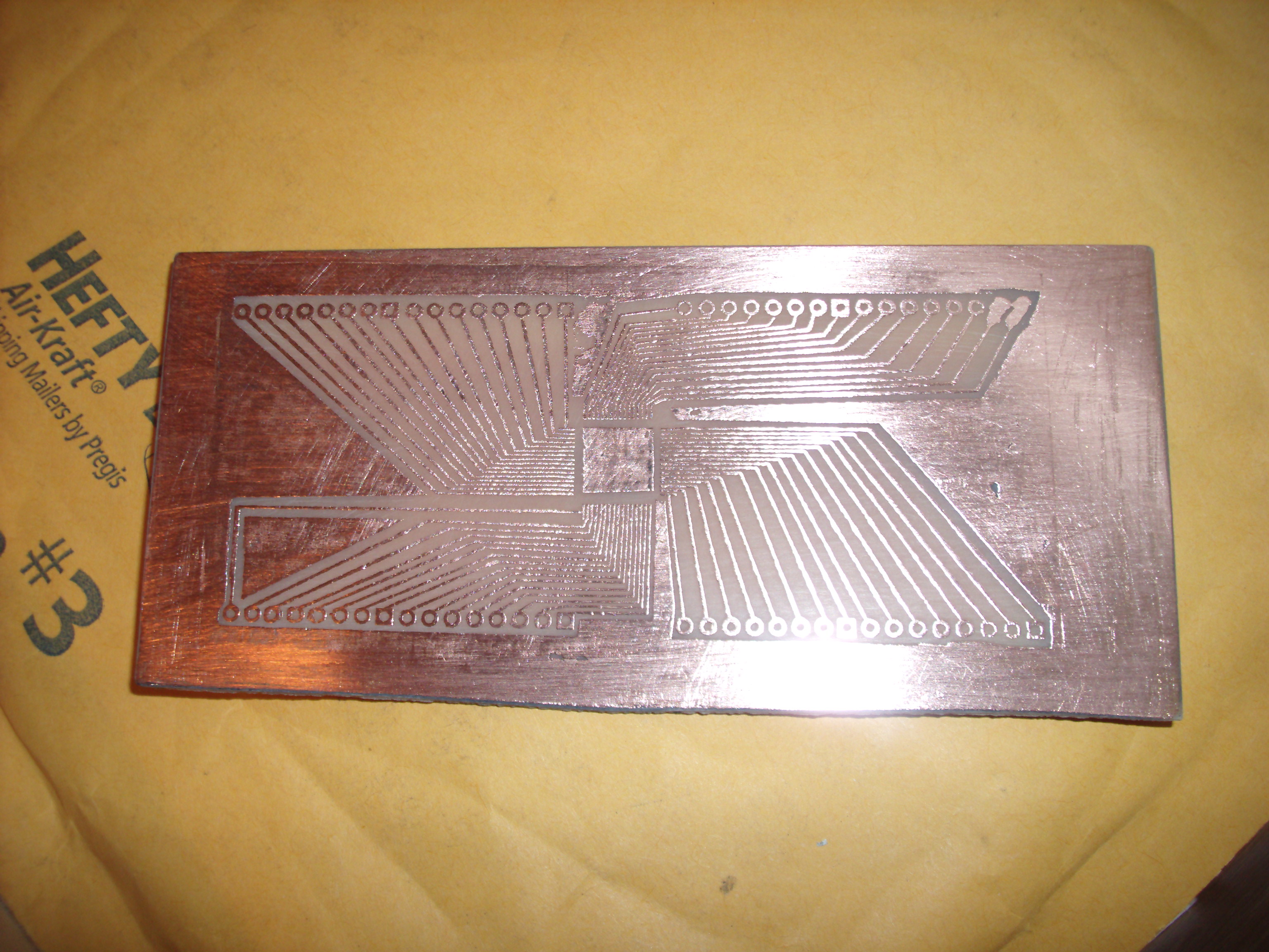

Well Here's with Presentation Paper Hero999 before you tell me how bad it is I have only made two
boards in my whole life. It had two pads that didn't take toner fixed them with a marker.
It could've been a lot worse.
It's a very complicated board, I would have never attempted something with such fine detail for my second board.
The toner probably didn't stick because you didn't apply enough pressure to that part of the board.
If I ever see any parts where the toner doesn't stick, I'll clean the board and re-print it unless it's really minor. That's the beauty of using magazine paper, if I mess up the ironing, it doesn't cost me anything. I can re-print until I'm happy with the toner transfer, then etch.

What the heck are you cleaning your board with?
Its all scratched up.
I think you did fine and agree with Hero999, it is a bit complex for just starting.
Did you use magazine paper transfer (like Hero999 mentioned in the past) or buy some presentation paper?
Also, the board is fine, but try something lighter in grit to take the oxide off the board and that will get rid of the scratches. I use steel wool on really bad board and that is a bit rough.
For me, if the board works when done, you did good.
Magazine paper is the same thing as Presentation Paper they sell it at office max
it comes off easier then the photo paper.
sand paper i clean copper pipe with it 220. I'm going to get some 600 to day
etchant? I don't no what it has in it I got it at radio shack it looks like oil.

I have never used anything but a metal polish.
If I used sand paper It would properly be 1200 grit!
Like I have written before, if the copper is shiny it is clean. Run water over it for a last check, make sure the water is not beading.
I use an old stash of Revere Ware copper cleaner but it is unfortunately not available any more. But most any metal or brass/copper cleaner/polish should be able to do the job. Brasso is a name that comes to mind.
In many cases the copper oxide layer is so thin that a plain pencil eraser will take it off, so it seems to me that using sand paper is a gross overkill.
