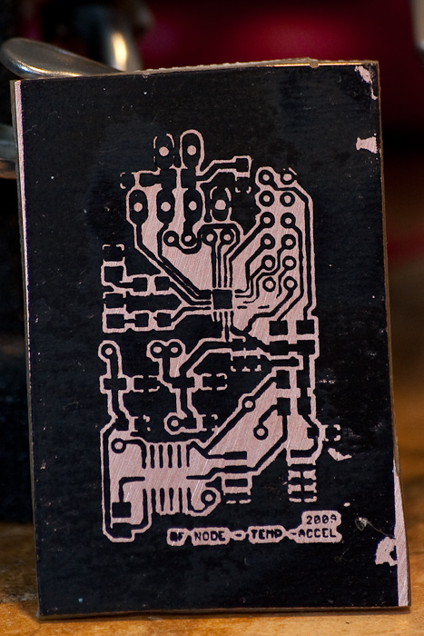

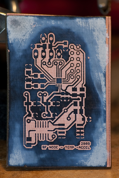

I'm still unable to get this Pulsar paper to work properly. I'm assuming it all has to do with the ironing I'm doing. They say, heat and pressure, but when I apply pressure the traces just get crushed.
I did something fairly small and detailed, so I thought I'd give the pulsar paper a try again. I didn't use that much pressure. I'm afraid if I used the method outlined on the webpage with the roller and the iron, then it would all compress into one big mass.
I had to redo it with my regular photo paper. Maybe I'll try the Pulsar paper again another time, but it's not looking good for me.
Pictures attached.
Hi Mark,
The problem is you didn't calibrate the HEAT of the iron. The objective is to never be able to reach the melting temperature of your particular toner. The more pressure (eg. entire body weight as a 'constant') the less temperature needed to achieve the "sticky" state of toner. These two properties (sticky and melting temperatures) are VERY close with just the weight of the iron and maybe a few pounds of downward force, however, crank up the pressure and you can crank down the heat, thus increasing the "spread" between fusing and melting temps. This is why calibrating the iron is so important otherwise you'll have too much temp for the pressure and total toner distortion happens. With a calibrated iron, you can leave the iron on indefinitely with max pressure and nothing will happen to the toner, It'll never get to melting temp so it can't distort... ever! It took us a long time to get all of this figured out.
