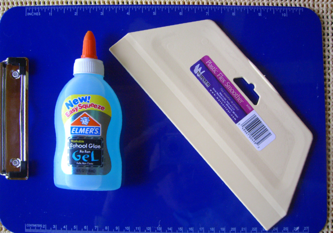

Soak times & Toner release "kit".............
Left picture shows a standard toner /magazine paper and a Elmer's glue coated after soaking in hot simmering water, for 3 minutes.
Right picture shows the $6.00 "kit", you can do 6 pages in 6 minutes. And there is enough glue for about 75 full pages!
The plastic clip board (blue background) came from Wal-Mart, the other two items from Ace Hardware.

What is the item on the left in the right picture? The spreader and the glue I get.
6 pages in 6 minutes. That is to spread them and dry time or just spread them? I might add water and a paint guy and spay mine for a thin coat.
For $6 bucks, heck, I'll try it.

"The spreader and the glue I get." They are laying on a blue plastic clip board. Makes it easy to spread the glue and clean up. Just one bead of glue across right below the clip and a swipe with the spreader.
"as long as it's laser printer approved" I have been putting all kinds of junk through my HP printer for years, just make sure it doesn't peal or create dust and you should be fine.
Coating takes about one minute per page, so you might as well do several. The drying time is dependent on many things but 10 to 15 minutes sounds reasonable, I did not time it.
Make sure you get the correct Elmer's, just like in the picture! White glue dose't work.

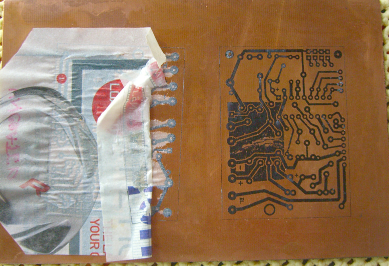

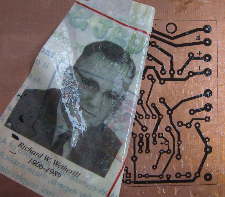

The left picture of the board below is wet and distorting the traces. Showing paper release after three minutes of soaking. Picture on the right showing tools for coating the paper.

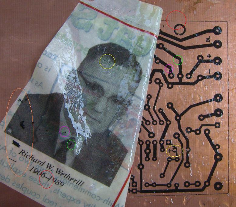

By distorted, you mean because there are droplets of water on the PCB giving a lens effect?
What I don't get is the extra toner that appears to be left on Richard's obituary. I don't see where on the PCB that it came from; especially the thick trace near his first name.
See attachment & match up the circles:
The paper is upside down & covering what would be shown in the orange section.
Good observation, don't know why I posted that picture. Not a very good example.

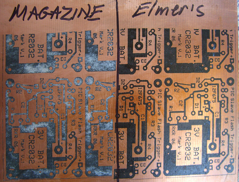

I just made a side by side comparison, both transfered at the same time, between a magazine paper and my Elmer's treated paper.
Elmer's treated paper slid off after a few minutes in hot water any you all know what I takes to get the magazine paper off. Note, that the hot water helped even the removal of the magazine paper tremendously.
Here it is:
