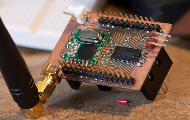

The first RF Node board I show uses a QFN chip (it's an MSP430F2012). As far as I know, QFN only comes in 0.5mm spacing.
https://www.electro-tech-online.com...-transfer-paper-cheap-easy-13.html#post771932
20090809-rf-node-photo-002-jpg.35044
0.5mm lead spaced parts are very common; If ExpressPCB doesn't have them, you should at least try using something more advanced like Eagle CAD.

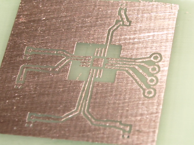

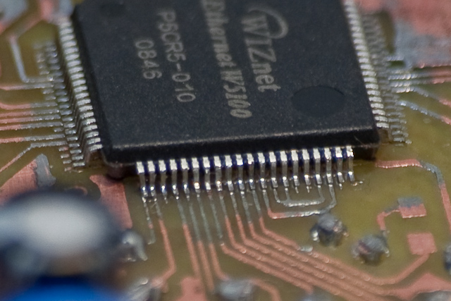

So, let me get this straight. Out of the two alternatives; you not doing the Toner Transfer process properly, or me and others in this thread lying, you chose to believe that we are probably lying without doing any research on your own to verify either story. You must have a lot of friends.
1. Because you gave it one try and cannot do less than 20mil does not mean others can't. For once, do something that I suggest and go to the Homebrew ML that I linked earlier. Pulsar advertises all over their site less than 10mil and shows plenty of images. IF YOU CAN'T GET LESS THAN 20mil YOU ARE DOING IT WRONG. Talk to the Pulsar support guy, who is very helpful, about fixing your process. It's obvious that you don't have a lot of experience here, why can you not take advice? If you want more examples of people being able to do Toner Transfer with finer pitch, they have a search site called google. "toner transfer pcb" will give you loads of examples.
2. There is a post right here in this thread that I've already linked to that shows my process. It's using Pulsar paper, but it's the same process I use for Photo paper. I'm not going to take video if that's what you want.
https://www.electro-tech-online.com...ansfer-paper-cheap-and-easy.94601/#post760928

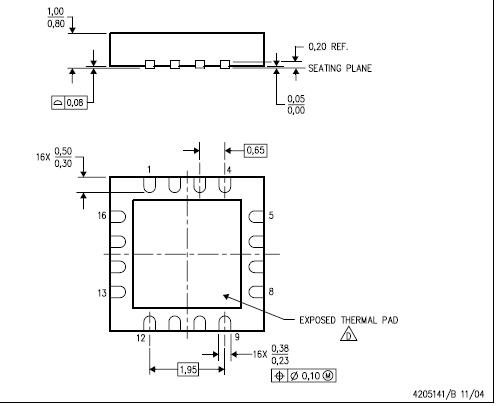

3. In the 8mil example close up picture you can clearly see the Wiznet W5100 markings on the chip. Here is the datasheet with package description. 0.4mm pin pitch
Image:
https://www.electro-tech-online.com/attachments/20090402-pcb-003-jpg.28060/
Datasheet with Package description.
https://www.wiznet.co.kr/rg4_board/...s_1&ss[p_num]=25&bd_num=15828&key=0&mode=down
It's nice to get really small traces but ultimately not useful to me or I would say most hobbyists. There's a reason I haven't done less than 8mil on a real board that I've made and populated, that's because I just don't need any smaller. I don't get any benefit out of it and without small easy vias, I don't see general hobbyists having any use for it either. ARM7 chips have all sorts of core power supply pins and PLL pins all mixed in with regular I/O pins, which makes making single sided boards with ARM7 chips a complete mess and even double sided board are a mess without being able to make vias under the chip. Those pcb's I have to get made in a boardhouse. If all you want is accuracy, check the direct print inkjet work done by some people. Check the pics in the Homebrew PCB group under 'C88 Test PCB'. Perfect solid 1mil trace test. Really nice. Unfortunately too much work for me for something I don't need.

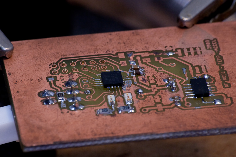

For QFN I use a hot air rework station. I really like working with QFN now as it's pretty easy. I put down a bit of paste, tiny bit on the thermal and a bit around the pads, drop it on and hit it with some hot air and it sits right down in place. Parts will align themselves to a degree, with tension when in reflow.
You can see in the close up, the little beads that are left behind from my cheap solder paste. Since doing this one I've been mixing a little extra flux in my paste before using it.

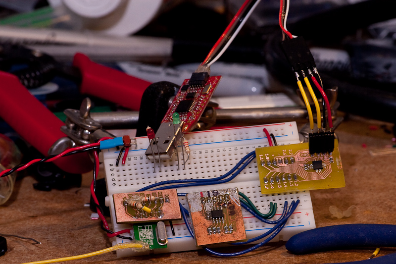

I tried to take a close up of my breakoutboard chip, but close up, the text was way too faint and unreadable.
20090810-msp430f2012-rf-test-001-jpg.35072
...and here is the assembled board with the vias. Unfortunately this will not be the final prototype for my generic RF Node. I just found too many improvements I can make to it.
20091104-rf-node-proto2-001-jpg.35073

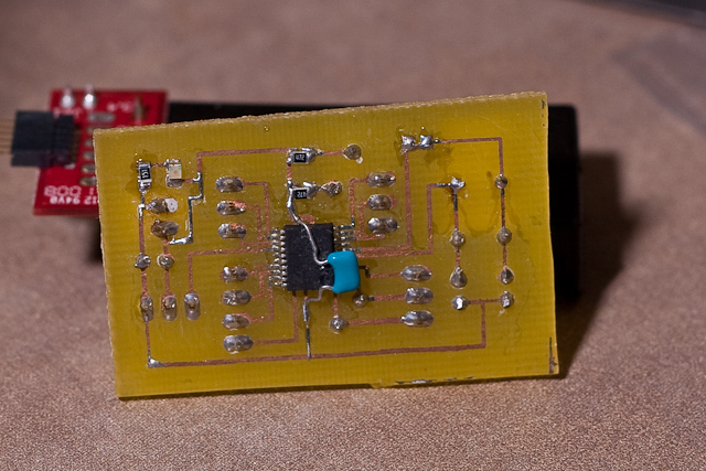

I found a picture a while ago of the first pcb I ever made using this process and posted it in another thread. This was sometime in 2005. Probably lucky, but right from the start I was able to do a decent board using nothing but my HP laser, my iron, and some ferric chloride. I attribute the success to following instructions. My methods and tools haven't changed since then.
20090723-1st-pcb-001-jpg.31697

What the what? Where do you get this stuff from? I can do 8mils without difficulty, I've done 6mils on a test board and I can likely do better than that. I'm getting pitting with the new etching method I'm using. The hydrochloric acid/pyroxide. Even then, I'm not getting this wavyness you are talking about. Ferric Chloride gives me clean nice lines, no pitting. I really like the acid etchant, but I'm only using it now for test stuff that I don't care about. The copper looks rashed for me, but I don't use that green Pulsar sealant stuff, either.
