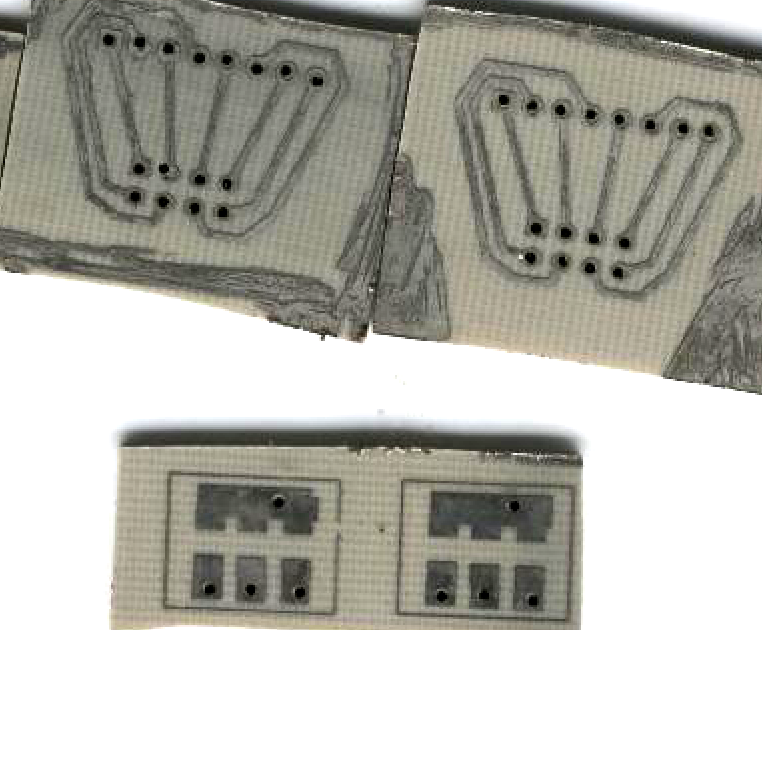

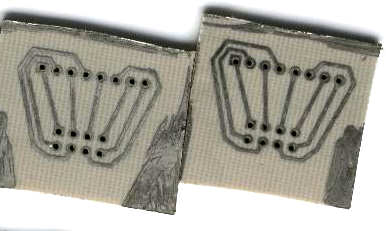

The dreaded photo board
Since I know lots of responses were on their way, I went ahead and perfected the photo system that costs no more than the TTS system from the printer. From that point I simply have a cost of developer (NaOH) that is pretty cheap considering how many boards an oz can process. So if you consider the cost of the iron electricity or the lamination I think its a wash.
This board is the same board I did yesterday with the TTS. This board using the PTS will show the better results of no wavy lines under zooming in, and no pitting at all.
Again the Pulsar foil is good but as the website states the white is not white until a second layer is put on. I do not know why the TTF system fails but I also see others boards with the same defects, pitting.
As far as a solder mask. In order to make comparisons that have to like kind. All the videos Mark sent me are on boards with solder masks. Can this same method be used to solder up these micro boards without a solder mask? Good question I cant answer that yet. All I know is that a soldermask is used in all the videos which leads me to believe that to do a like kind comparison one must use a solder mask.
As far as a toner solder mask. It does not have the heat capacity. I thought I already talked about that but lets put it here again. Toner goes off just under 300° F becomes liquid at about 320°F and is a gas anything above that as the plastics gas off under thermal loading. Solder temp minimum using silver solder paste is going off at 450°F. If using 60/40 Kester solder your temp on the area approaches 700°F. I know all of this because I used to work for soldering iron company by the name of MetCal back in the day. Bottom line is the toner will simply gas off with who knows what kind of toxic vapors. No thank you. A soldermask has to withstand the highest temp on a board and that is generally an epoxy. Helps strengthen the board too.
Chris

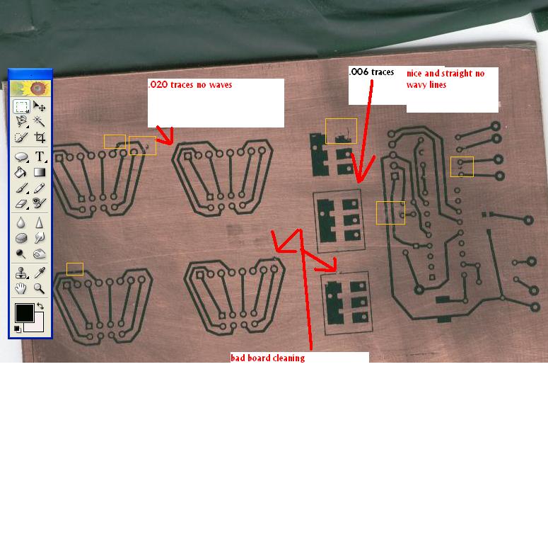

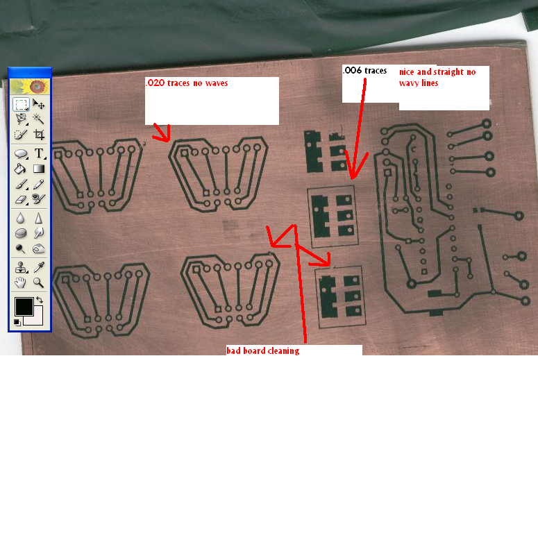

wavy traces??
I recently etched some adapter boards for my Junebug and decided to try some .006 inch traces.Just for ecxperemintal purposes.
no problem. just need to clean my boards better. used some scrap, cleaned but not real good.
note no wavy traces, no pitting all using the PULSAR TTS. used the green foil as well.Just follow directions and talk to Frank about minor problems. All solved with one phone call. Who you gonna call-Kodak or Fuji?? good luck
as far as cost you need to procure photo sensitive boards or apply chemical to make your own.$$
then you need to purchase the clear plastic sheets$only place I found them was staples but kinda spendy.
you still need to print out your design using ??
after exposing your boards you may still have voids?? pin holes??
not sure how you de-sentize a board?
having used the PULSAR TTS system, I see no reason to go with photo resist, too many steps, to many things can go wrong (not enough exposure or too much??
I stand behind my traces except the slight boo boos of dirty boards.

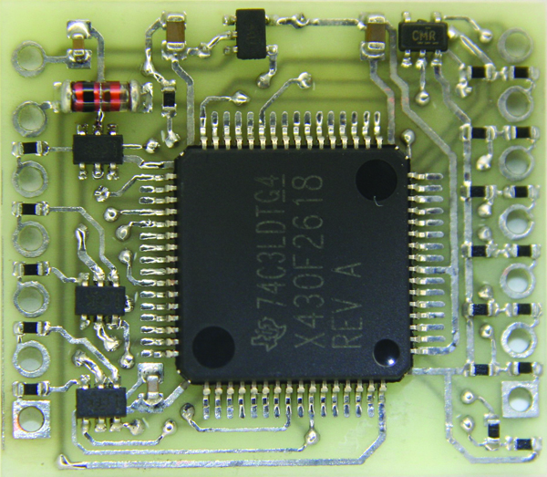

A bit more on the 2x SMT board above...
The board builders quote on how this was made...
"The project uses 0402 resistors, 0603 caps, and a 64-pin LQFP device, to name a few. It was built using 8-mill traces, 6-mill space, 20-mill vias, and 10-mill via holes. The board was pre-drilled and routed on a Sherline desktop CNC mill.
Notice that the board is .8" square with .1" header pins holes on the two sides. There are caps mounted BETWEEN each of the .1" header pin holes."

I have made some notes on Mr. Deb's board that was done and etched. I cannot see the etched boards to well very grainy. As I noticed when taking the photo of my PTS board the light from the camera makes the shiny surface reflect too much. Like taking a picture with the flash in a mirror. I will leave the resist on next time which should help any camera.
I made a boo boo when I made the PTS board in that it has to be print side down and I did it reversed. My old mind cant remember what we did in high school. But with research I remembered the printed side of the negative has to be down otherwise the few mils of clear will cause a lens effect. What I see under a scope is the that traces and pads grew slightly and created the pads that shorted although they do ring out I agree this will not pass inspection.
I understand the white verses the green. I also believe you when you say the green was specially formulated. The problem I see when doing a side to side comparison of green foil verses white foil under the same circumstances the white foil does a much better job of covering. I do not represent I know why but I think that is why I am having trouble with the TTS system.I do not use the white foil to etch with.
As I pointed out earlier, and thank you is a shout out to Mr Deb:D, I circled (actually squared) in orange places I also think problems occur. I also would be interested in some better pics of Mr. Deb's finished product.
I also get 6 mil and 3 mil lines around my boards. These tend to go away in places, and as such are not reliable in long runs.
The nice thing is now with the ability to easily create negatives that the PTS boards can really work with, I have a master I can use to easily remake the boards. I am working on redoing an old scanner and loading it up with bulbs so that I have even exposure. One bulb barely works with a 1" board. I will make another board up with putting the print side down.
Thanks to 3VO and this web site. I would not be where I am today with reinvigorating a 30 year old process. I gave up a long time ago that I would ever be able to make negatives from my printer.
Frank: I do not know of any thermoplastic that can take 500°F. There must be thermal gradients there or they are post labeling their planes. Having not seen their process I have to take your comments with a grain of salt. Are you saying it is the carbon only in the toner system? That I find hard to believe, carbon does not have enough outer valence electrons to "stick to" unlike plastics which are loaded with outer valance electrons. Or are you saying there is another "sticktion" method going on here?

the squares you marked are smuges
on scanner glass is only thing I can figure as I looked at all the traces before tinning with liquid tin.

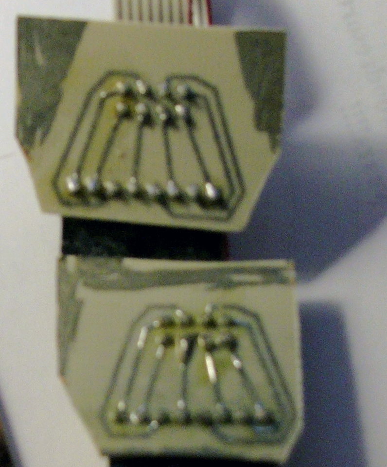

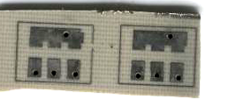

here are some photos of completed boards(not easy taking pics)same boards as posted earlier just tinned.
as well as boards before adding components.
