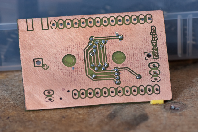

I've worked out a really nice process for doing via's now. Works really well for me and it's pretty easy. Unfortunately I use a hot air rework station and a bit of paste for it so it needs specific equipment, but I've gotten good results so far.
I'll take a pic and outline the process later, in case anyone with similar tools wants to try it.

Let me see if I can step through how I did this.
Etch the board and drill all holes. I actually put no drill holes in the via pads for this, but next time I'll do small starter holes as my drills were a little crazy without.
For the drill holes for the vias I use a small bit. (#72 .0250") This drill hole exactly fits my solid core 22awg wire.
I place the board flat on a piece of wood. Poke a stripped solid core wire into the via hole and use a pair of angle snips to cut the wire off flush against the board. So there's a small bit of wire in the via that's only being held in because the PCB is laying on the wood.
I do this for all vias on the board before putting a dab of solder paste on each via. Use a decent amount. I think the amount of solder paste is the only thing I really need practice with still.
After the vias have been wired and pasted, using the hot air workstation to flow the solder. Let it cool slowly.
Once it's cooled flip and and raise the board, so it's not flat on the wood surface anymore. I use a alligator clip workstation, but anything will do.
Paste the bottom and heat again. Everything should flow again and you should have a solid connection with the pastes and bit of wire.
In the pics only one of the vias didn't work out. In the first pic, third from the top right, I ripped a bit of the via pad away when drilling. Otherwise everything worked first try and it was real quick.
This might be one of those processes that works well for one person, but not for others, but I thinks it will be fairly easy to replicate as long the right tools are used. Unfortunately you really need the correct size drill bit, correct size wire for the drill bit, hot air station, and paste for it to work, so it's not for everyone. You also need to be good enough at doing double sided boards and having them align well. I use the pocket method and this board was close to exactly matched.
I got my drill bits from e-bay. The paste is from dealextreme.com The rework station is an Aoyue 968 from sra-solder.com
I took these pics a few days ago. The actually board is fully populated now and works well. I can take a picture of it later if ti interests anyone.

Perhaps you can manage with lower dia wire even. The current through VIAs do not call for 23AWG.
I propose to use even fuse wire of say 5 amps, like using a strands of flex wires by stripping an inch of it and go on using each strand.
Thanks Sarma.
If I used thinner core wire than the 22awg that I currently use, I would need to use even smaller drill bits. I'm not certain I can reliably go much smaller than these. They're pretty tiny. If I could drill smaller holes, yes, I could get even smaller vias.
I have a .5mm drill bit. As long as it's mounted in a very well balanced drill it's not that big a deal, and if you just need to get to the other side, shaving off a pinch of the end of a conductor is no more complex than a quick spin with an abrasive material, or a good yank with a pair of plyers to pull the wire smaller.
Do it and tell me how it works out for ya.
