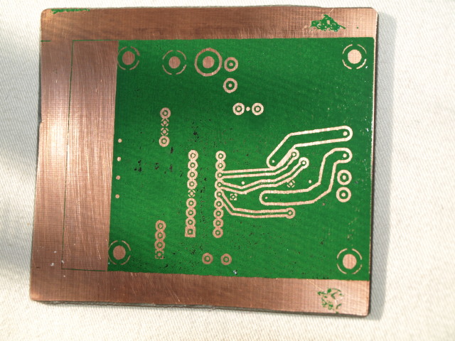

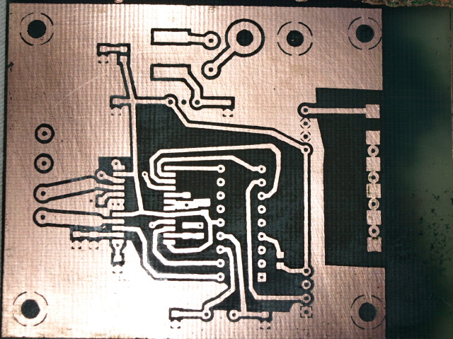

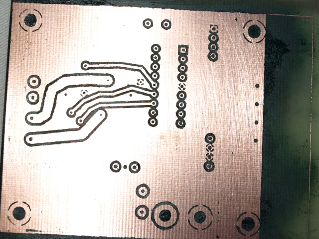

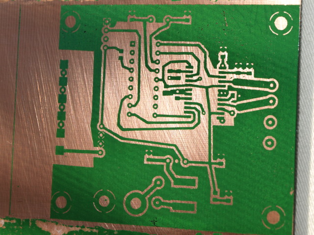

Success with the Pulsar system
Finally after many iterations and having to change things around to accommodate this heating methodology. Next week I will do a comparison method with photo resist and see how it compares time wise, cost wise etc...
To those that claim they can get a 10 mil line I need to see that. While I believe you can get a 10 mil line over short transitions I really doubt with this method you get easy repeatable results. Additionally Pulsars paper simply glide off and any other paper you have to scrub off the residue. I do not work for Pulsar and fell into their product with research into new methods to make PC boards. Even at very low heat, distortions still occur that again I do not see who can get reliably anything less that .020". Here is my shot at it with those .020" gaps and traces. Notice in the in the corner holes the distance to the ground plane to the pad in the thermal pad arraignment. This is 10 mils and as you can see it has a tough time registering accurately and shorts can occur. Here it does not matter this is done so the the soldering process does not get a cold joint. I would like to thank Pulsar for all their methodologies and advice. All the registration from side to side is perfect thanks to a process on Pulsars website. Please note something weird is going on with my camera as the pictures seem out of whack (no alignment back to front). I have no idea what it is as the board I have here lines up to a .010" tolerance. Not bad for home grown. The proof will be in the component insertion.
The laser printer is a Samsung color and I get all four CMYK guns saturating the density which leads me to believe a color system is superior in density to any mono system because you are putting on 4 times the toner. I use Adobe Illustrator to accomplish the CMYK black and to do the accurate page make up. I used Express PCB to do the layout.
The next task is to drill the board out and start to populate it.
Again thank you Pulsar with a stellar product with a repeatable and reliable system.
You know anyone living in an apartment who cannot actually make these boards because of health concerns (and rightly so!:eek:) The process of page make up to getting to printing is a lengthy one. I would get good at using ExpressPCB and Illustrator to make the pages up. I would then do the under the radar thing of advertising your services. I can show anyone how to do that if you like. The reason I say that is because I think we are in the beginnings of a home brew hobby related Renaissance with PIC microcontrollers and the ability to make you own PC boards. I can see already three to four different job postings right now. ;)

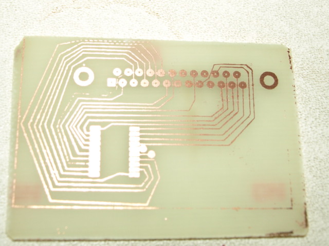

New photo based board
My first attempt did not have the exposure times right but since it was exposed I developed it anyway and etched it. It includes 1 to 6 mil traces. The one mil will not work, the 2 mil is flaky, the 3 mil is fine, and the 6 mil no problem.
I will post a compete report later as I perfect the timing. Twice the cost, about the same time to etch, better control of the registration and line widths, and no heat into the board.

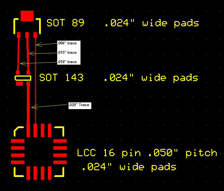

Mark,
You showed me three examples of 20 mil traces. There is no components with 10 or 8 mil pads and all these traces look to be the same size as the pads so again .020" is the minimum reasonable size for thermal transfer, which is the width of the smallest pads. I have included a photo of what I am talking about. This is a snapshot of ExpressPCB with three of the smallest components and the smallest pads. The pads line up nicely with 20 mil traces. Do you disagree? can you prove to me where your 10 mil traces are again. And no those also are not 8 mil traces. Again the smallest pad is 24 mil. so your traces should be much smaller than the smallest pad.
The good news is the photo transfer method just using the sun and the same laser output with Pulsars foil can achieve 6 mils without a problem which again is an industry standard as the minimum for PC boards.
