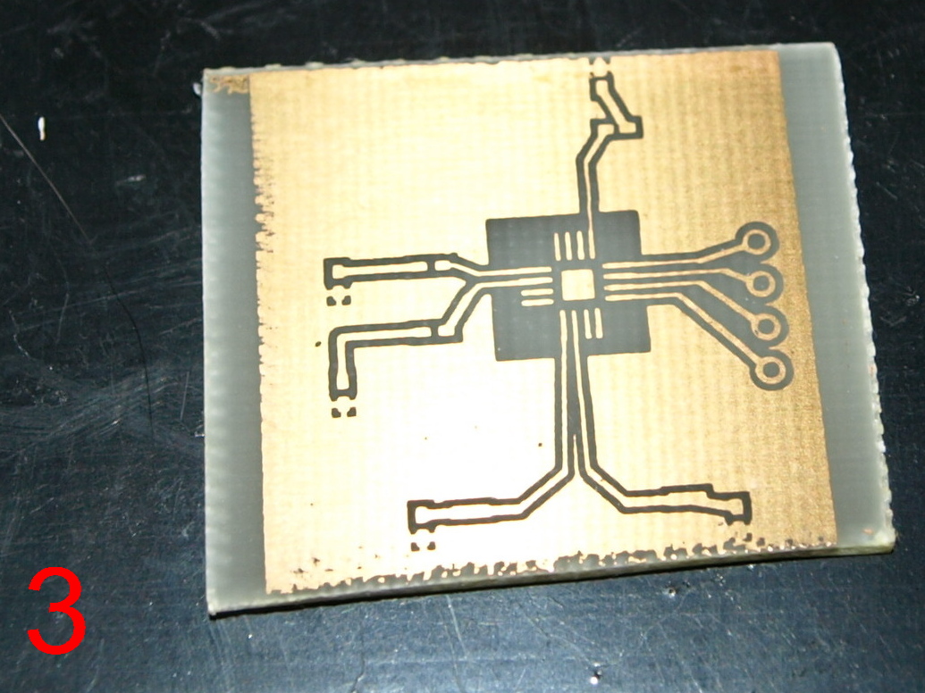

I have it down again with the PTS and I have to say it works perfectly even if I blow it.
The final board was 1 minute over exposed and one of the traces shot down to 5 to 6 mils. But the board rings out and if this is a signal pin with no current all the better.
This is what I am shooting for a board that is precise when viewed under a scope or as in this case zoomed in from a high res picture.
I have them in succession and labeled 1 through 3.

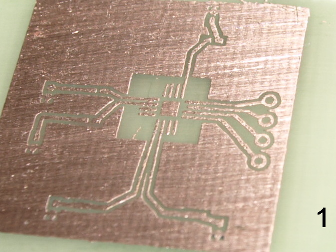

1 is the original TTS board and you can see the pitting. Again I think it due to excess silicon oils and potently waxes in the toner that get in the way. How do we clean the transfer is my question.
Total time from print to etch was 14 minutes. Working real fast! Now to find the pesky tin plating locally, and try out this solder mask technique with the toner system and see if it does not bake away. I have my doubts.

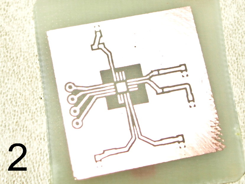

2 is my first attempts at the PTS and I put the negative in backwards. Shows very well the lens effect that created with all the increased trace widths.
3 is the final board with the very fine trace using the PTS (emulsion side down). Notice no pitting at all and fine edges.
I will use the TTS when it is appropriate (Over 20 mil) and the PTS for the fine work.

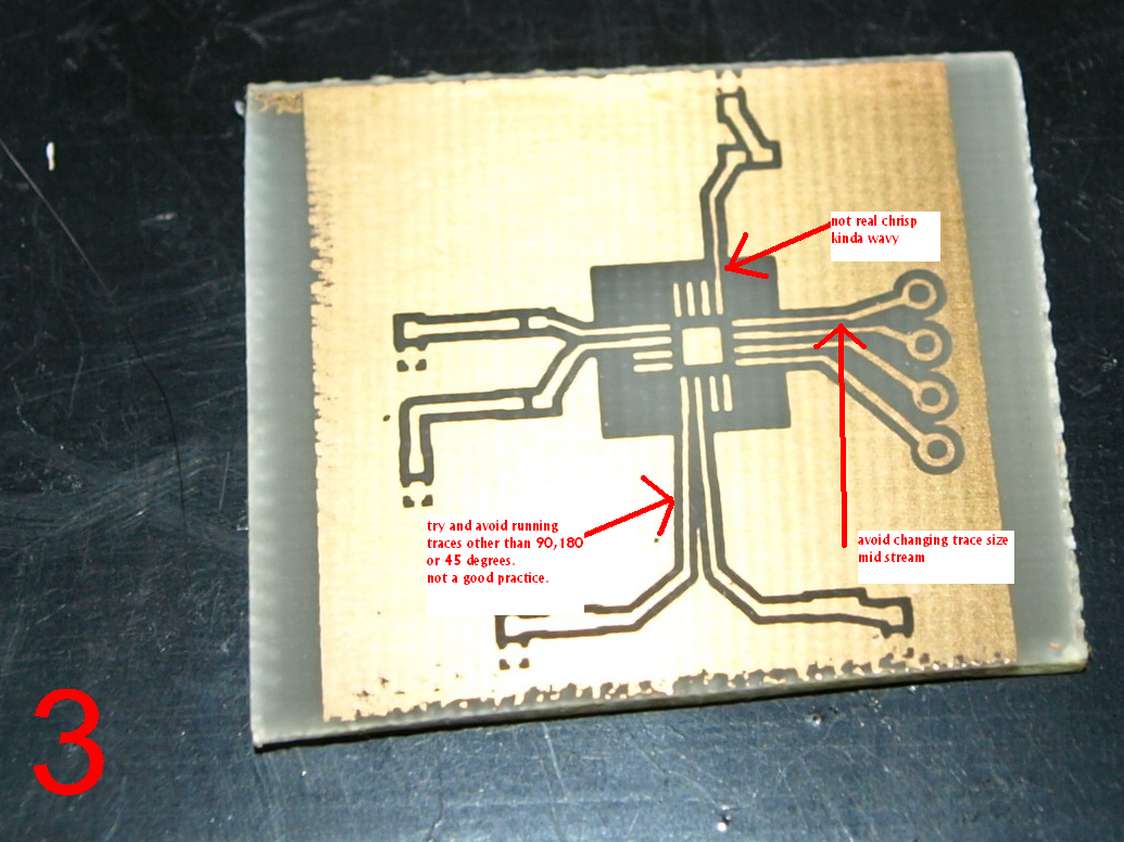

I would like to say the boards look nice but
several problems
why all the pitting when using TTS? are you sealing with green TTF foil?
your pcb design should not have traces that go cockeyed. As I understand it traces should only go 45degrees, 90 degrees or 180degrees, not any why you feel like.
Makes printing a mess as it dosn't print smooth.
never change trace size mid stream
post your schematic an I venture a better board design could be done.
If this is what yopu get using photo thansfer then your using the wrong method or get more practice.

I think the pittng your talking about has to do with the fact that you need to seal the toner with the green foils, not the white.
Once again let me repeat my testing procedure to compare the TTS (thermal transfer system) to the PTS (photo transfer system).
TTS process was used in figure 1 and was laminated using the Pulsar transfer paper which works incredible well, I have no complaint there in fact I highly recommend it over any other system that goes into ones laser printer. After that black toner laminate came the green foil to cover the laminated toner on the PCB which it laminated, and to the naked eye, very well. Upon the one minute method at Pulsar's website using ferric chloride heated in a bag I got what you see. The toner takes quite a lot of acetone to remove and the final board lightly buffed under water with green scotch bright.
The PTS process uses a negative which I make with standard photo methods. I use positive resist boards which are the same boards in size and weight used in the above TTS test. I set these into my light box and expose the board under 6500°K light for 12 minutes. I then develop the boards in NaOH for 2 minutes, rinse and put the board into the enchant bag with the identical 1 minute process above. The first board (fig 2) I did I had the emulsion side up. This creates a lens effect in the light box to the board that grew all the black areas by almost a factor of 2, and led to shorted out traces where on the .65mm pitch device in the center. The next board (fig 3) used the identical PTS process but the emulsion side was down, the proper way to expose a photo resist board. The issue here was I forgot to time this exposure and it was over exposed I am guessing one to two minutes. The result is a trace that went down from 10 mils to 1-3 mills. What is taken away here is that shrunk trace is the PTS system still being able to etch this trace out without any open areas. :D
The TTS system you can see has pitting on the surface. One can deal with this by flowing solder over all the traces but that is not a very professional way to make boards. You also heat stress the board as many have seen their pads disappear when they drill their boards out. Very frustrating.
The PTS sytem you can see in figure two and three there are is no pitting and the boards look new and undamaged due to heating the boards.
It is this heat cycling and pitting that is representative in the TTF system. I am sure someone smart can figure out how to eliminate the waxes and an oils when a laser prints. I attribute the pitting to these waxes and oils in the printed toner. It is not something you can see very well. The laser printer companies make sure of that as this would be pointed out. But for the transfer system any wax or oil residue on the surface of the print onto the the blue transfer paper will result in the foils not adhering in those areas, as the foil only sticks to the sticky toner when it is heated; hence why you need a heated laminator. I have no answer in dealing with the blue paper cleaning it of any residual oils and waxes. When it has been transferred it can be cleaned but again any microscopic glob of oil or wax just under the surface will not be cleaned and when heated will expand quickly compared to the toner itself resulting in a pocket forming. I believe that is what happens. I have advocated that a company such as Pulsar formulate their own special toner, free of waxes and a new laser printer drum that uses newer heated non stick technology and free of the developer which is nothing more than silicon oil impregnated into a sheet that post cleans the drum. This developer comes with the new imager that only lasts about 20,000 pages. Wonder why this is its because the silicone oil is depleted for one thing and these imagers use technology that can only handle light for so long before the paper which rolls over it mars the surface.
So again in the TTS test I used Puslar's transfer paper in the laser printer with density moved up to 5. I know this is not a density issue. The image transfer nicely to the board with nothing left on the transfer paper. So far so good. When the foil is applied I get excellent coverage. You can see the foil embossed into the traces and looking smooth and evenly covered. When I remove the foil it looks good. Again I do not believe the method is in question here. It is when post etch occurs and after the board is cleaned that under magnification you can see the small traces hugely impacted by pitting where the large areas are not so badly impacted by pitting. Regardless this pitting makes the copper thinner and attributes to losing pads when drilling. Again if none of this bothers you go for it. My PTS process is just as simple and takes the same amount of time and is inexpensively repeatable but mostly there is no pitting which is important to me.

It is wrong to think that you have achieved the best possible or even reasonable result with the toner system when you failed to follow directions.
As I recall you used a color printer. No one does that and I am quite sure the instructions call for b/w.
3v0
I am sorry but once again an assumption. Black being printed is black toner and that is the same in either a color printer or in a black and white printer.
If you look at the PDF in a previous post, and print it on a color or a B/W printer, you get the same result, black toner onto the paper.
So please do not be biased here, my printer is top of the line and works with printing superbly, it also prints your papers very well. The problem here is simple: toner no matter what color has wax in it (according to Frank), and the foils do not stick to wax, right? Lets not forget the silicon oil on the drums for release. Your foils stick to silicon oil? I really do not believe that.
You are so quick to demonize printers from any company yet your problem is clear you are getting debonding in microscopic sites that create heat related liquid stresses of oils and waxes that impede the full coating of your foils. Now I would agree that there are better toners out there for your process. Do yourself a favor and scientifically show, with spectrum analysis, which toners work best before jumping to anymore conclusions.
Lets stick to the facts instead of jumping to a false conclusion.
Have all your guests here make the board, with their favorite system, zoom in to 7X, and post their results. Anyone can dump this PDF into Illustrator if they want to turn it back into a vector based CAD drawing. From there they can copy and paste back into their favorite CAD system or simply import it.
The chip is the TI chip recently used in a post by Mark. The lines are all 10 mils and as so many claim here it is easily done with the TTS. So lets do that and post their results. Include the type of printer used and lets see what happens.

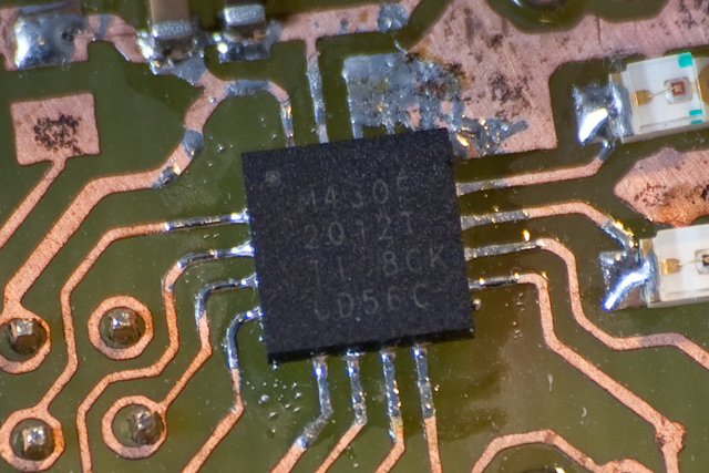

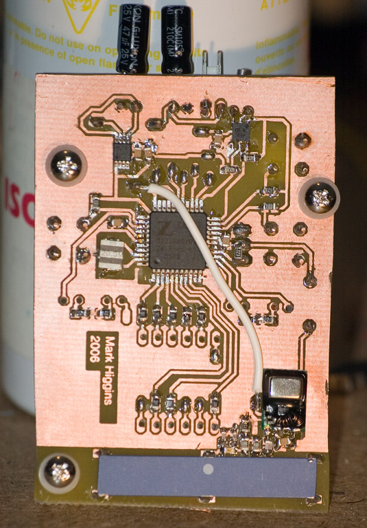

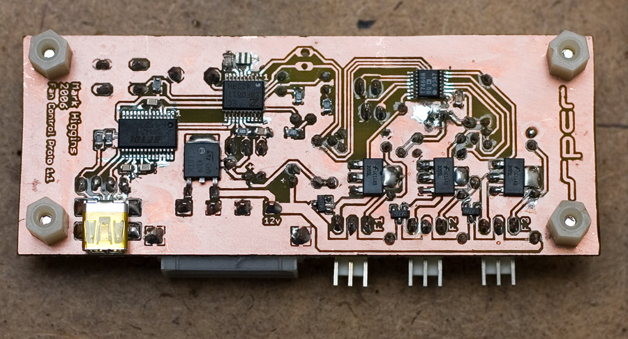

Well, I've already posted mine, and it looks pretty good. I don't have any pinholing, a bit of rash on ground planes, but not on the traces themselves. I only get this rash when using the new muriatic acid/peroxide etchant. With ferric chloride I don't get any rash unless I've done something wrong. (attached)
20091104-msp430-close-001-jpg.35071
