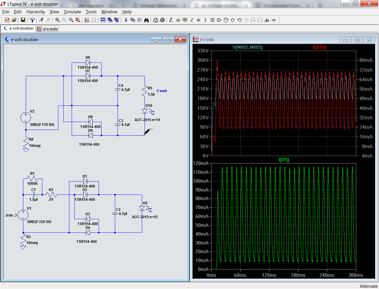

Nice sim.
Presumably R2 & R6 represent the ESR of the capacitor, but why a value of 10 mili Ohms for the 1.5uF cap and 1 Ohm for the 3uF cap?
The individual LED diodes are characterised at 20 mA or 30 mA depending on the actual type used, which is not known, yet you say that 50 mA would be dissapointing. Why is that (genuine question)?
Out of interest, could you do a run on my second circuit to see what that would do? Why my circuits were not tried I can't understand- probably because of all the inuendo and lack of understanding. :mad:
I just used Ron S. sim so we would be on the same page. I don't think any of the values make any significant difference to the circuit. I initially thought they were 100 ma diodes, but from looking at them E thought the 50 ma Cree was a better fit. The simulation at 240 volts put the current at 46 ma. so that seemed a good fit.

I took a couple of liberties with your voltage doubler.:angelic:
I hooked up the other side of the bridge and modified the resistor to get the current up to the same as the 240 volt model.
Works a okay. But alas, still only 7 watts average.:(
Thanks for the run ron (da do ron ron). The only design aim was for the circuit to work off 120V. The power into the LED string can be increased by increasing the value of the res capacitors to go as bright as you like.
