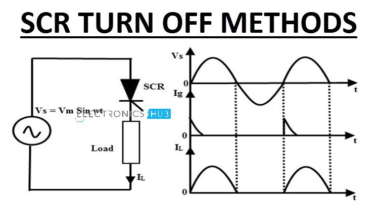

could you draw to show how the discharge capacitor was connected together withsouronding circuit?
Try googling it, or even searching on these forums (as it's been posted here before), but essentially you use a second (smaller) thyristor to switch a capacitor across the main thyristor, this momentarily stops current flowing through the thyristor (by shorting it out) causing it to turn OFF.
