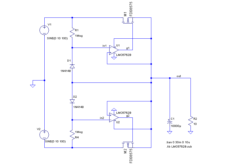

Here's the circuit with the comparators...
If you want to simulate it, let me know if you have problems. I could post waveforms, but it would be much more instructive to do it yourself and see what happens when you change the load resistance, filter cap, generator source resistance, etc.

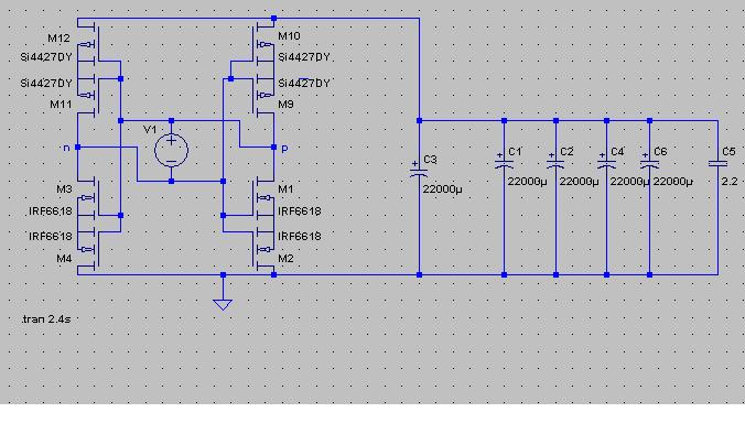

Ok i constructed the auto Rectifier..
One side works a lot better than the other..
since i didnt have 8 Mosfets of the same type on hand i had to mix n match..
That may have been the problem..
the one side gives me 624 mA , with the other sides gates not connected
so this is pretty promossing because that is 624 mA half wave rectified current (measured)..
if i post the scope output maybe someone out there can see a problem..

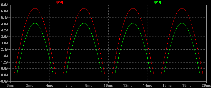

This is the output from the simulator..
i've lowered the " source" to 12V which seems more like what i was actually getting under load conditions..
pretty sweet huh ?

Pretty sweet...
Take a look at this comparison.
williB said:
Ron i tried running your rectifier ( with comparators) but with the sim program , grounding right next to the Sources produces strange results..
also i tied the op amps power and noninverting input ahead of the Mosfets which seemed to produce better results..
For some unknown reason, I thought (until recently) that you were trying to drive a resistive load, i.e., to convert generator AC to a DC voltage that would drive a load. I finally realized that you are charging a battery - with no current limiting except the generator resistance. :shock:
I didn't try the comparator/Pchan rectifier as a battery charger. It sim'ed really well as a FW rectifier into an RC load, as shown.

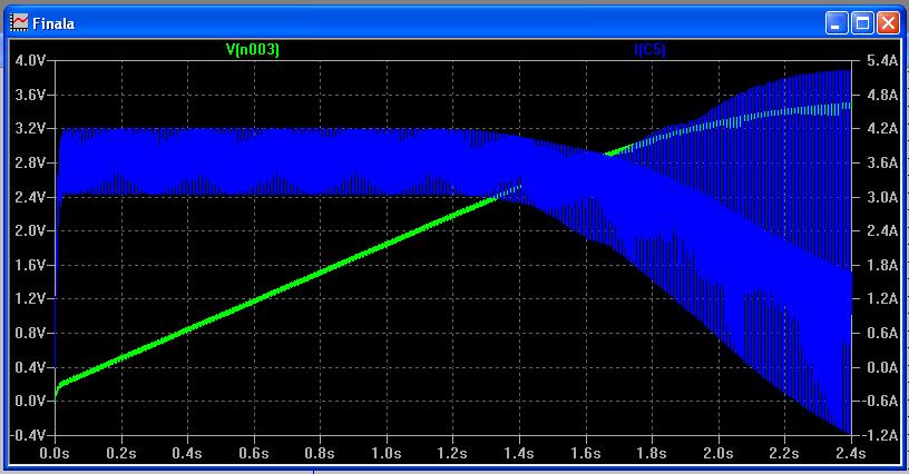

you would think so, but i have not seen this on the scope or the simulation..although i found a pecularity which you should take a look at..
instead of using a battery i used a 2.2F cap , with a bunch of smaller caps to absorb some of the power and pump it back into the supercap..
The blue is the current in the 2.2F cap..
The light green is the voltage across the load(caps and supercap)..
The sim was done for 2.4 sec. at which time the voltage on the load levels out to about 3.6 V ..why 3.6V and not some other voltage??
Also the current starts to go negetive as the caps reach their final voltage..why??
the source is ( 0 , 12, 100 ) w/1.3 ohms internal resistance...
I think that's what your sim is saying.
I think that's because the source is draining the cap charge back to the motor, as previously described. 3.6V is probably from the threshold voltage of the mosfets. When the source voltage is above this, it's connecting the source so it conducts current the wrong way for part of the cycle.
Same problem. Your driving strategy is flawed. Fix it!

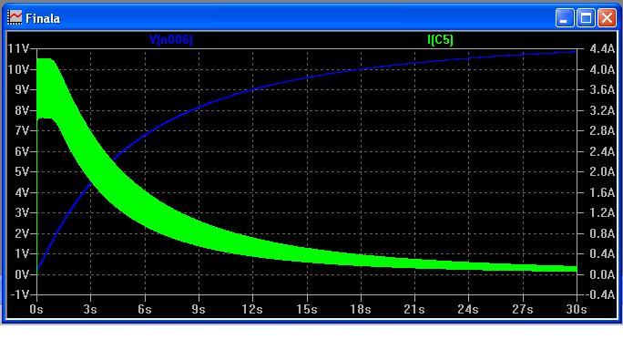

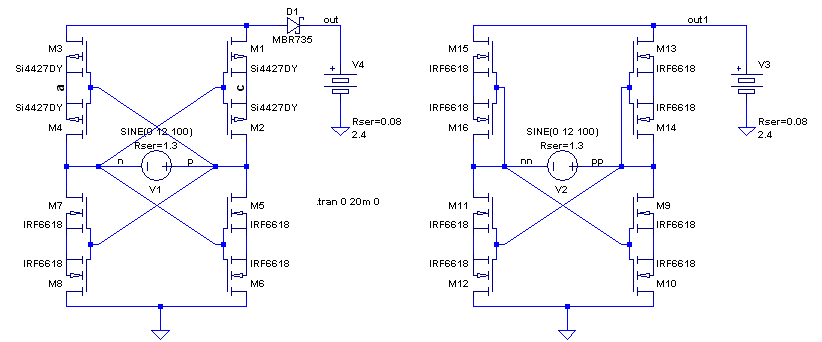

ok i've added a single diode to prevent that from happenning ..
the way i look at it a single diode drop is only half as bad as as two diode drops per leg..
the new sim looks much better , i'll post it when its done..
the reason i'm using two mosfets is the single diode approach just doesnt work

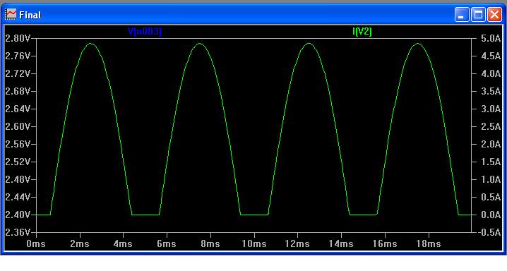

ok this looks much better..
i have added a single diode at the output to the load..
voltage is in blue current is in green..
ya know , when you put a relatively low voltage battery(fixed voltage) in the load the current never goes negetive either..
with or without the diode..
I think that's because, again, you're driving it incorrectly.
