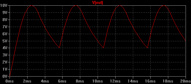

Willi, 3000uF is not an adequate filter cap for a one ohm load at 100Hz. The ripple from an ideal full wave rectifier will be 6V p-p! The average DC voltage (what you would read on a DC meter) will be 7.28V.
This also assumes that the generator has zero output resistance.
The ripple will be worse at lower frequencies.
Below is a plot of the waveform. Remember, this is with ideal diodes.

Ron i got the same result on the scope , as i got in simulation..
It wasnt enough capacitance to adaquatly filter the output..your right..

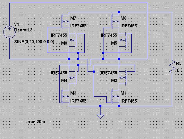

could someone simulate this .. i'm pretty excited ...
its so simple ...
it works as well with a battery as a resistor...
its so simple ...
Did you sim it? I did, and, as I expected, the transistors have 2.6V peak across them when they are conducting. This is not because of ON resistance, but because of the gate threshold voltage.

As I said, I did sim it, and yes, I checked the output. You would be better off with diodes.
williB said:
i think i want a second opinion.
Willi, in the waveform window you can right-click on the name of the waveform and a dialog box opens which will allow you to enter an algebraic expression. Plot the voltage across each of the upper series pairs of MOSFETs. I got 2.6V (peak) when forward biased.
Also, keep in mind that the maximum reverse gate voltage is 12V. The only thing protecting you from breakdown is the 1.3 ohm generator resistance and the 1 ohm load resistance. If the load resistance goes up, you will break down the transistor gates.

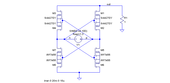

Edit: I think I was wrong about the gate breakdown.
Try replacing the upper transistors with p-channels, as below.

I just redid the sim with MBR20100CT diodes ..
The diodes beat the Mosfets by 0.5 A with a load of 1 ohm..
the diodes scored 8.0 A while the Mosfets got 7.5 A..
