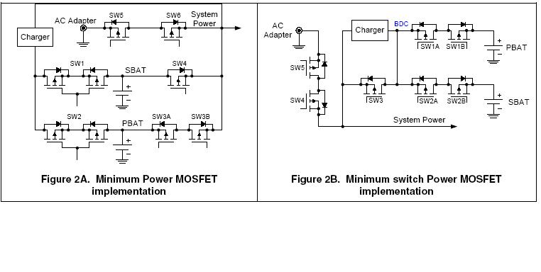

Look at how they Show two MosFets connected together , to block current in both directions..
If i have to use two then so be it..!!

If I could get one off the shelf, I'd use it but since it seems to be exotic (at best), I'll just use 2 mosfets in series with sources tied together.
Yeah, this is a common arrangement. I' always trying to save cost by not using 2 fets.. oh well..

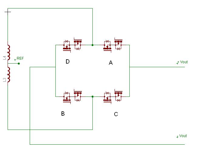

i want to use Mosfets to transfer power from my generator as efficiently as possible..
since you are familiar with using two Mosfets to transfer power ( and block it ) .. what do ya think of my Full wave rectifier , using mosfets..
i have allready simulated a mosfet pair and it does in fact work..
the problem is finding a proper ground in this comfiguration..
the inductors labeled L3&L4 are really coils from my generator..
about the ground , the comparators are going to need a reference to know when one leg is more positive than the other..
When the L4 leg is positive with respect to L3 . then A & B would be on and C & D would be off..
the connection between A & C Labeled Vout is positive , the other Vout is negetive..

OK, that's what I thought it was for.
You do NOT have any need for more than 2 NMOS and 2 PMOS. In this case you would put the NMOS source to the negative rail and the PMOS drain to the positive rail. The body diodes will only be in the forward bias when you're turning the transistor on anyways.
You should be able to power the driver for the MOSFET gates with the DC power rail. It shouldn't have bootstrapping trouble because the MOSFET diodes act as a FWB to drive the rail when there is no charge on the rail. Consider the idle current issue here however. If those comparators drain a few mA at all times then it will slowly drain the caps down.
