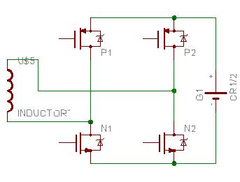

This will do it
YOu are going to get shoot-throughs with that arrangement unless you have interlock logic
This is true. If you use PWM controllers for the gate drives, you can get some with "dead time" control to avoid shoot through.
Another way to alleviate the issue is to put some series inductance with the FETS to at least keep the currents from rising too high before the complimentary FET turns off.
Dead time control seems to be the best solution.
Yes, that problem exists with any implementation regardless of the number of transistors or whether they're MOSFET or bipolar.
The problem is lessened due to the presence of the body diodes in a functional FWB implementation- the diodes will catch the turn-off spikes and continue to function as a rectifier, so prematurely turning off one transistor to make a clearance before turning on the other leg will not have very negative consequences.
From what I can tell, a hand-cranked generator will not be a really high frequency job so generous latentcies between turning off one and turning on another would not constitute a whole lot of the waveform. Switching losses from charging and discharging gates are also not very big.

They were not the "shootthroughs" I was talking abt.
I really should write a short motor-drive tutorial for this site.
How you have the FET's or switches arranged you must be providing the complemetory version of PWM to the upper and lower devices in a leg.
There is a finite switching time involved. Thus if they are fed the signals at the same time, one will be turning off as the other is turning on, there will be a short across the supply - be it while the switches are in the active region, but still a short.
Some form of interlock is needed to ensure that this does not occur. Such switching shoot-throughs can cuase some serious problems. I overlooked it on a gateboard of mine a shile back. It had a P-N totem pole output (to provide +15 and -15 to the gate of an IGBT), now it was supplied with a 6W TRACO DC:DC converter, now the board was getting close to that and it was not driving the IGBT hard enough.
Eventually tracked it down to a very short (200ns) period during switching when the top and bottom FET were in a conduction state. I delayed the switching time (via diodes,caps and resistors) and the power of the board went from just abt 6W to 3W.
this kind of thing is a real problem and I have seen it overlooked in cheap drives (for the sake of a couple of diodes,caps and resistors) and their life is not that long.
please take this into concideration
Right, you can't tie the complimentary gates together, that's why I did not connect them in the schematic.
You could have a circuit that turns on one NMOS and one PMOS whenever the input voltage >0.1v and another that turns on the other pair when input voltage <0.1v. So no overlap as long as the turn-off time is not too long for the highest frequency used.
Or you could just use an op amp on each Vds, so when the Vds exceeds 0.1v it increases the gate voltage. Note you have to establish a nonzero value as a threshold because of the offset error of the amp and again to allow for some spacing for turn-off time. There may also be some issue operating this close to the rails for some amps.
Oznog , have you ever simulated your schematic..

yer the intrisic diode can be quite shite, but for a H-bridge a prallel diode it needed - I suggest block that diode
styx , i dont want to use any diodes at all..
i think i am going to try my origional schematic..

The body diode may be slow. Some transistors are built with faster ones. From what you said about hand cranking it sounded like the AC signal would be of a low freq, though perhaps with enough gearing that could change. Perhaps paralleling it with a faster diode might improve its characteristics, I'm not sure. If you paralleled it with a schottky the body diode is sure never to forward bias. But really the diode should never forward bias in normal operation if you drive the gate before the signal reaches 0.7v, so I don't know what your problem would be. Please elaborate on what you have seen.
Note your original schematic runs those transistors the exact same way. The only difference is it adds a blocking transistor to block current to a transistor which is already off. It may allow a different scheme for preventing shoot-though current, but will require additional driving circuitry as well as additional transistors. That not only means extra parts but more current to run them.
What you may find is, depending on how frequently it switches, the current expended switching a gate becomes siginificant. It varies quite a bit by which MOSFET you select too. Also look at what rds is at the gate voltage you intend to use. Higher gate voltage means you will be expending more power every cycle on the gate charge. But MOSFETs usually spec the rds(min) at a high gate voltage, using 3v, 5v or whatever for the gate means substantially higher rds. "Logic level" MOSFETs turn on quite well with 5v.
