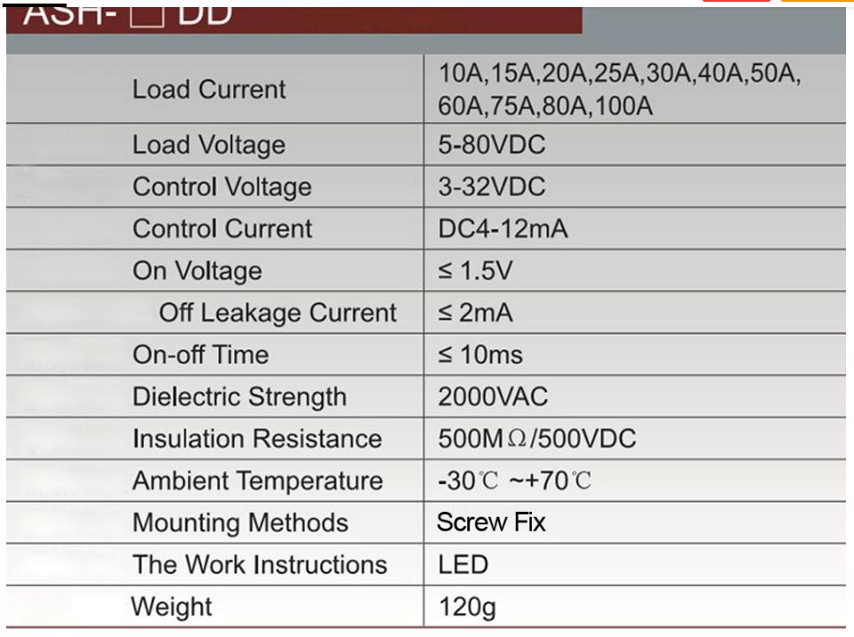

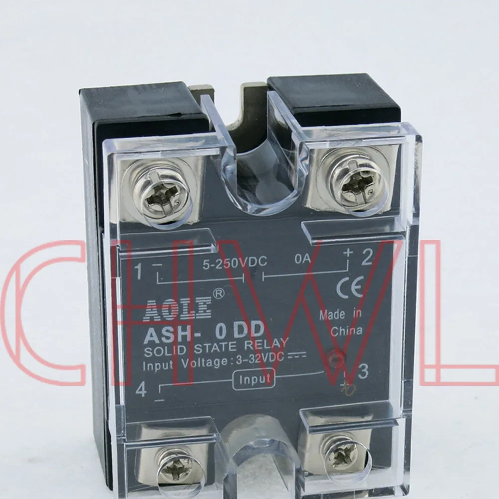

I'm trying to repair a piece of equipment, It has a SSR inside, which i believe has failed (SSR controls a DC heating blanket which no longer gets warm but has power to the SSR In, nothing out).
The only english markings are AOLE (manufacturer?) and ASH-25 DD. I'm looking for more specs than what is on the device itself (3-32VDC in, and 5-60VDC 25A out). Of most interest is the the required input current.
Google has not been friendly so far. Any thoughts?
Post a picture of component and markings. I think it tends to help a bit more then only a description.

Don't need the pic, you found the part. Any chance you also found an actual datasheet?
I found this
I did not look further sorry, there is a amazon listing right under it. I'm a bit surprised that much info was even posted on ali. Thats rare.

I'm also surprised at the information on the Ali posting. But if I want to cross it to something "American" the boss will want more assurance than the Ali listing.

Neither do I, but it looks identical to your post from Ali.
