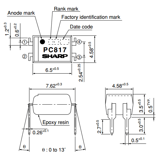

1kV = 1mm in "normal" circumstances...
325V * 5 = 1625V; It should be ok.
also PC817: in mm
