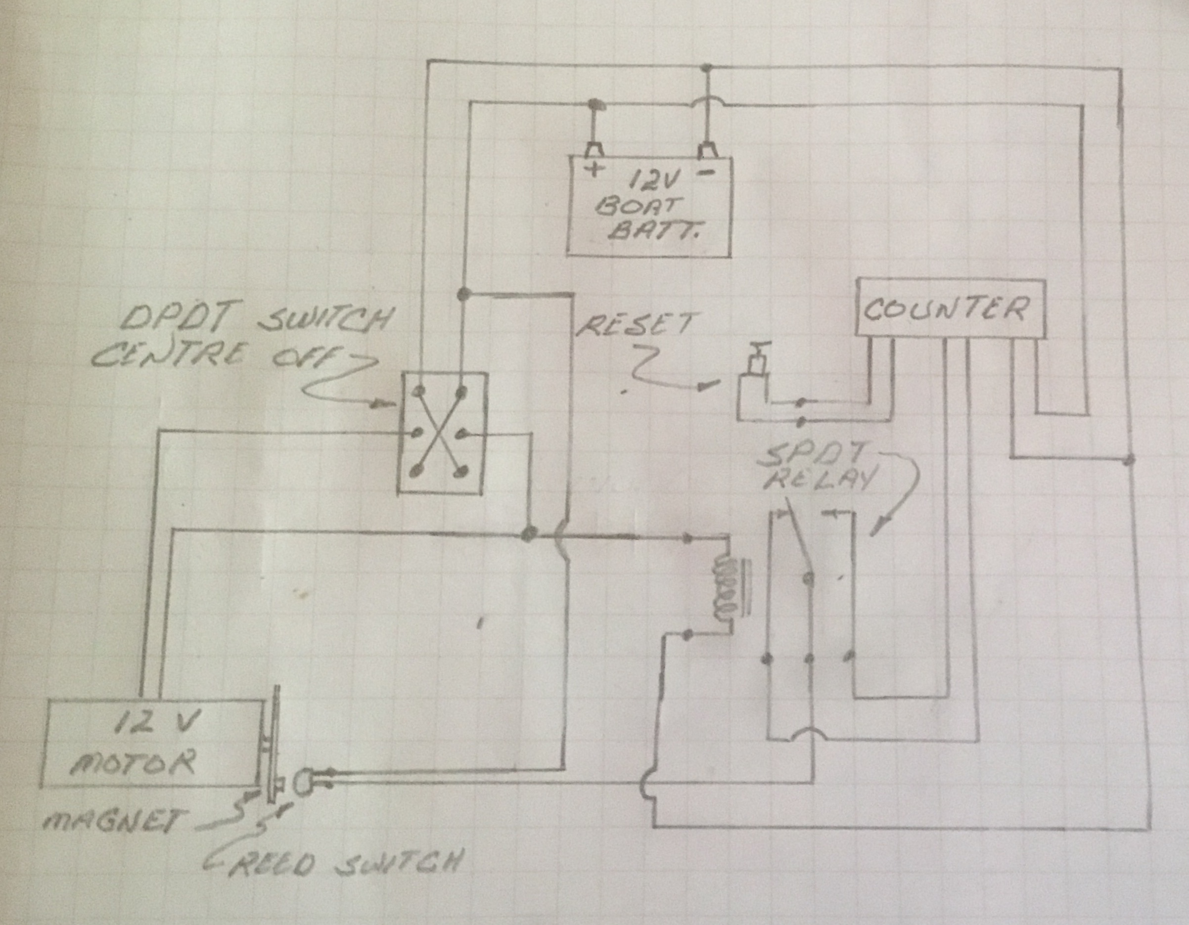

After a quick glance, I see you are right again. I know the counter does move up and down with a 12V + pulse. I will redraw it.
Are you sure? From that how would it know which way it is going?
In the diagram in post #34, is your DPDT switch connected correctly? Shouldn't the battery power go to the center terminals?
I think that he means that the counter has two inputs, one for up and one for down, and that each one operates with a +12 V pulse.
The DPDT switch can be wired with the battery to the centre terminals, or the motor to the centre terminals. It doesn't matter which is chosen.

It will work both the way it is shown in the schematic and with tha power feed to the center terminals.
Les.
OK: here is the amended sketch.
Actually, when I first played around with rough sketches this is how I had it drawn. I then drew the final version and, I guess, lost sight of the forest for the trees. I did remove the diode.

Yes, that’s right. There is two input wires on the counter. A 12+ pulse on one produces an up count and a 12v+ pulse on the other produces a down count.
So far so good. I have it set up and running but I haven’t a reed sensor yet. I ordered some online but will take some time to come in.(China)
It seems to work with me running it and opening and closing the two reed sensor wires by hand.

The circuitry to convert quadrature to up/down pulses would be tiny, and could easily fit into the sensor. It's not there because the makers don't feel that there is a market for it.
There is nothing to stop you using that sensor. Just have one output connected and use the relay controlled by motor direction to connect that output to either up or down.
