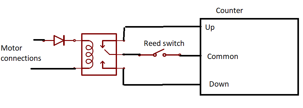

I am an older guy(78) with minimal experience in electronics. I would like to remotely control a fishing downrigger from the boats drivers seat. The downrigger is essentially a winch that lowers and raises a lead ball to which the lure is attached. Luckily the diameter of the drum is such that one full revolution moves the ball 1 foot.
I have no trouble in wiring a remote switch to do this but my problem is knowing how deep it is. I have a 3 diget up/down counter and understand how it works.
My problem is using some kind of simple rotary encoder that will give one pulse to the counter for every revolution and move the counter in the appropriate direction. All I find are ones that give hundred of pulses per revolution. I suspect there is software that is used to sort this out but I’m hoping there is a simpler way.
I did hook up a simple SPDT momentary switch that is struck by a tab on the drum and it worked fine, but it’s noisy and I fear will wear out very quickly.
Any ideas or help would be appreciated.

Thanks guys, I appreciate the comments, but yes, I have to separate the up and down pulses in order for the counter to move up and down. Even if I use two Hall, reed or light sensors, I have to separate the pulse so they both don’t give a signal every revolution, leaving the count the same all the time....one up/one down. I understand sensors and how they work but I can’t find a simple way to use them for this.

Counting has to be in one direction or another, and when no motor is running, it doesn't matter which direction the counting happens in because there won't be any counts.
You could have a relay that is only energised when the motor is running down. I suspect that the motor is a DC motor, where the power is applied on way to make it reel down and the other way to make it reel up. If so, you can put a diode in series with a relay coil, and put that across the motor.
If a relay is used with NO (normally open) and NC (normally closed) contacts, then the NC contacts are put in series with the up counting, and the NO in series with the down counting.
If your counter has a common connection for both directions, you can use a single reed switch, and a single pole, change-over (CO) relay.
If the motor is DC, and there is a common connection on the counter, the circuit here should work, but as you haven't said much about the counter or the motor, I don't know if that is the case.

Diver300: Excellent idea! I never thought of using the motor’s controls to switch the counters input. I’m sure the motor is a simple permanent magnet type that is reversed by switching the polarity of the 12V power going into it....very simple.
I’m going to try to come up with a relay and circuit that will work and may come back to you with a sketch. I have obligations all day but I will sure be thinking about it.
