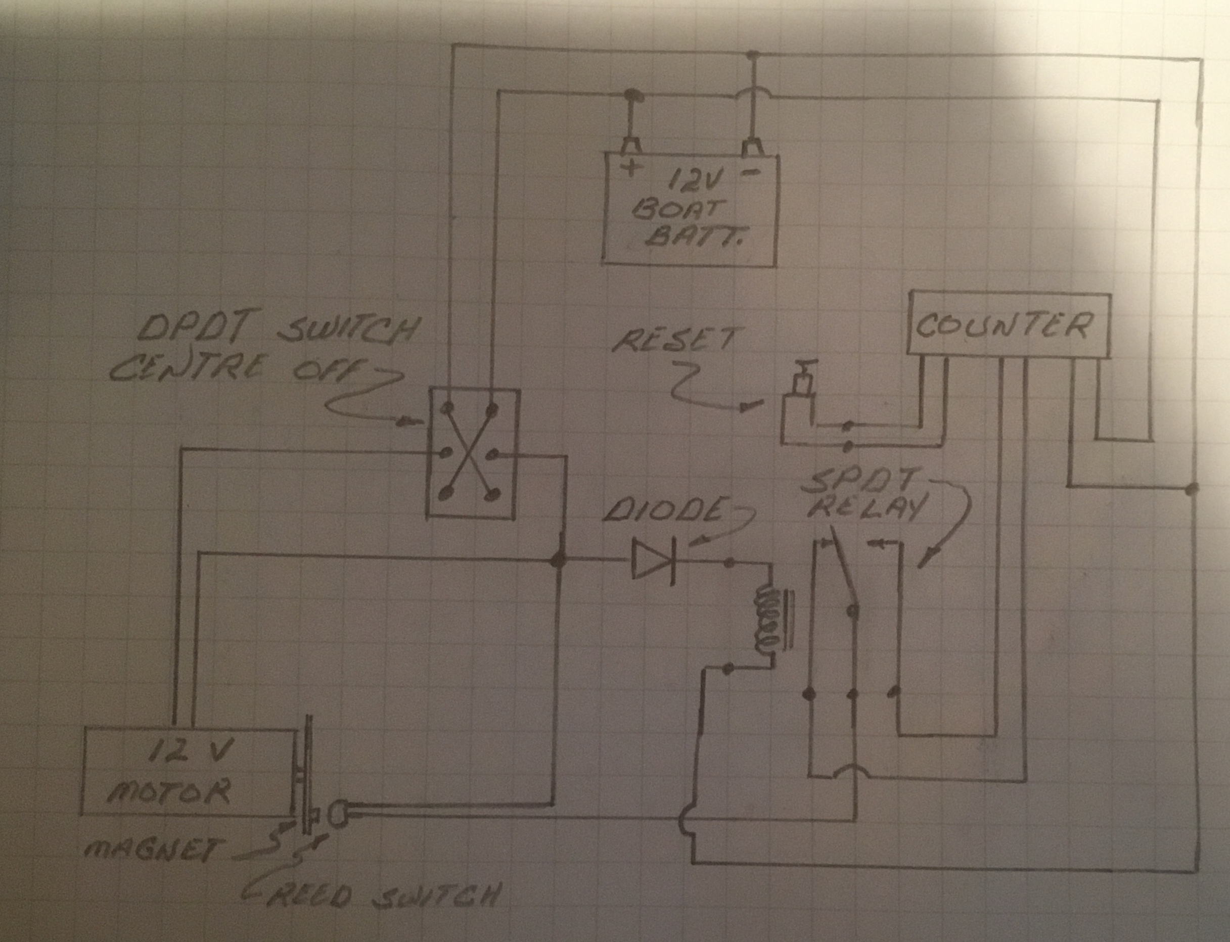

Diver300: Do you think I need the diode in the relays switching circuit? Could I not just hook one side of the relay to one of the output pins on the motor switch and the other to ground? When that pin is positive the relay will shift to, let’s say the “up”count. Then when it’s negative, it will spring back to the “down” count.
I have drawn it up without the diode and I can’t see why it wouldn’t work. Does using it save some wiring or act as a safety feature? This is where my limited knowledge is demonstrated.

A diode in parallel with inductances protects switches from arcing when the switch opens.

Yes, that should work. I hadn't thought of that, and I didn't know how easy it was to get to the ground of the motor circuit.
Some motor reversing circuits leave both connections of the motor connected to power or ground when the motor is not running. If you circuit connects the motor connections to +ve when not running, your relay will be powered unless the motor is running down. Automotive relays get quite warm when turned on continually, and you wouldn't want the relay on when the boat isn't being used.
Diver300: You have helped me so much that I hate to ask more, but could you take a look at this sketch I have made of a circuit I think will work. Hopefully you can understand it as I have experience only in pneumatic and hydraulic schematics.
I may not put the diode in right away as I can always add it later. I don’t think any damage will be done without it.
Don’t be shy to tell me I’m not understanding something; I know my limitations.

I don't think that there is any point in the diode as you have shown it, although it won't do any harm.
You haven't got the reed switch connected to the correct place. I don't know how the counter should be connected, but it is almost certain that the up and down inputs both work the same way. I would expect that you connect the "up" input to 12 V to make it count up once and the "down" input to 12 V to make it count down once. However, the inputs could be activated by connecting to ground.
Either way, you shouldn't connect the reed switch to the motor. It should connect to 12 V or ground, which ever of those the counter needs.
After a quick glance, I see you are right again. I know the counter does move up and down with a 12V + pulse. I will redraw it.
Are you sure? From that how would it know which way it is going?
In the diagram in post #34, is your DPDT switch connected correctly? Shouldn't the battery power go to the center terminals?
